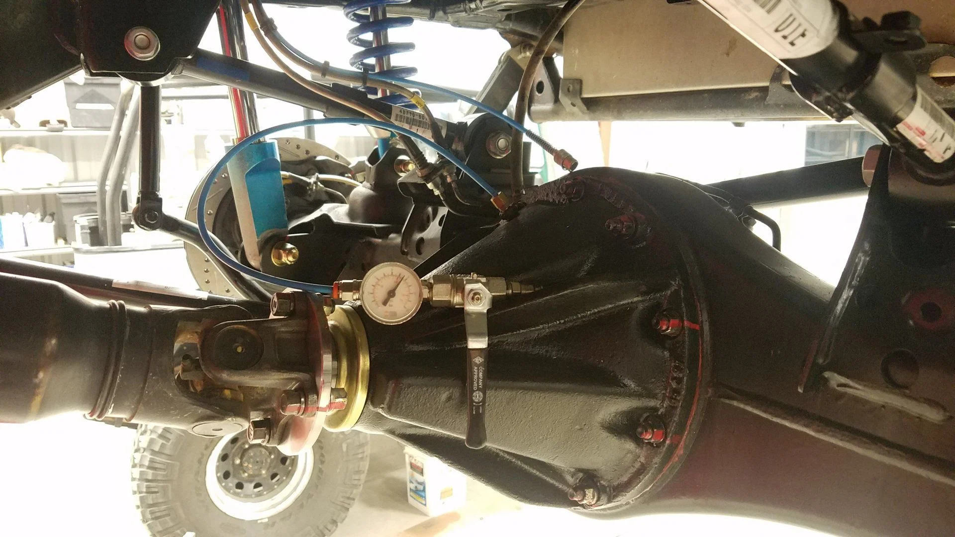

Here's a rear, the front looks a lot different but similar concept... kinda
If that is a rear, find a new ARB installer :D
(That is a HP front)
200 Rear diff aka 3rd aka chunk
Just typed 3rd member rear into google images as an example
I joke because some installers don't know the difference and thus send the air line out the bottom of the diff :eek:
It happens more often then one would hope when non-LC shops service a diff. They assume low pinion and route out the "top", this was a local one. At least they caught it before they installed completely.
