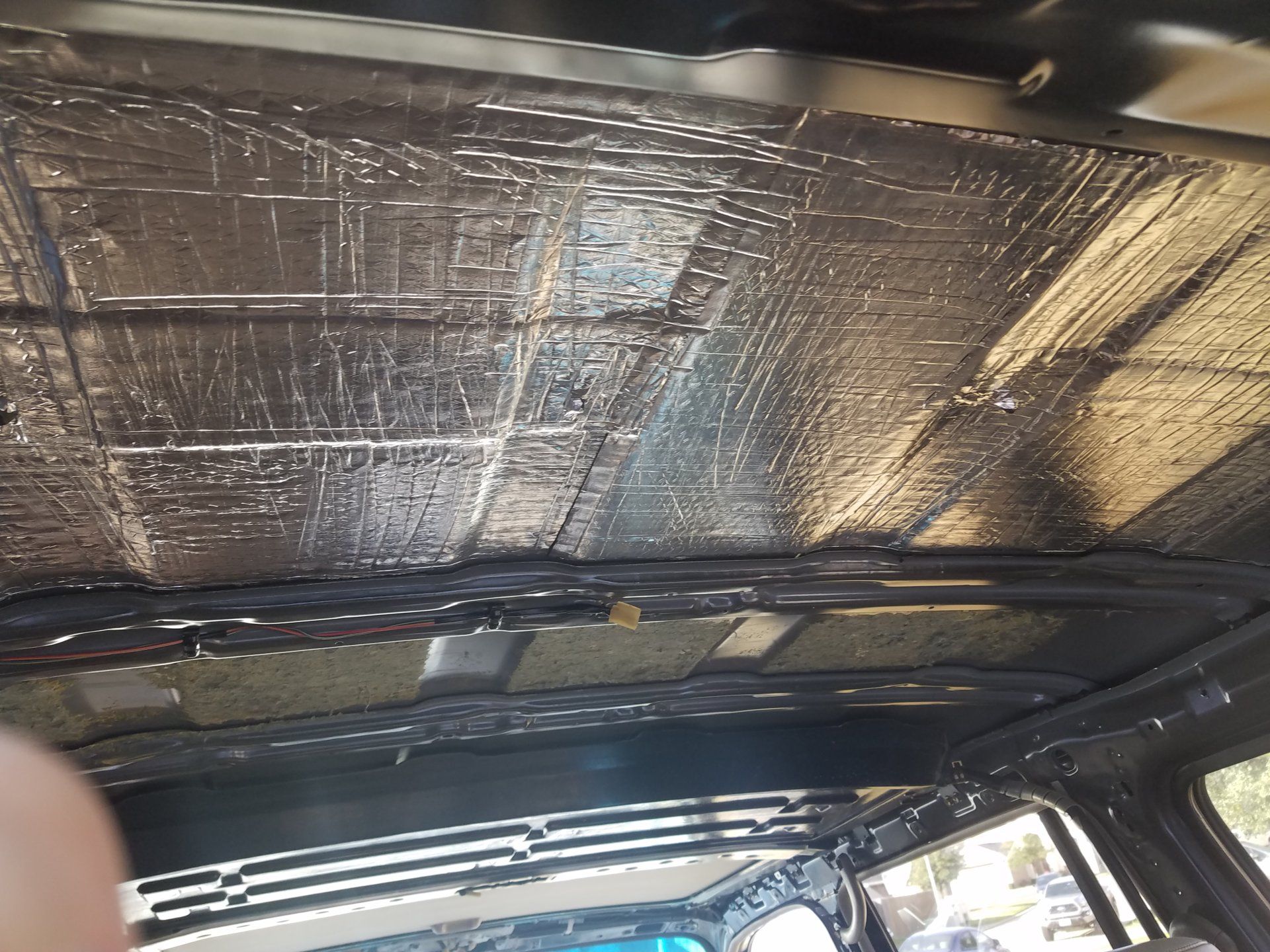

I covered the cargo area, and roof up to the sunroof tray, skipped the wheel wells for now. Carpet and panels all went back in and it is definitely quieter, but I still need to do more for it to be 'quiet'.
I'm terrible at taking pics during a project. Only one I took was the roof in the cargo area with just the 80 mil on. I covered this with the 170 before putting the headliner back in.
I'd avoid running just the green. As mentioned above, it has no mass, so won't stop vibrations and rattles.
