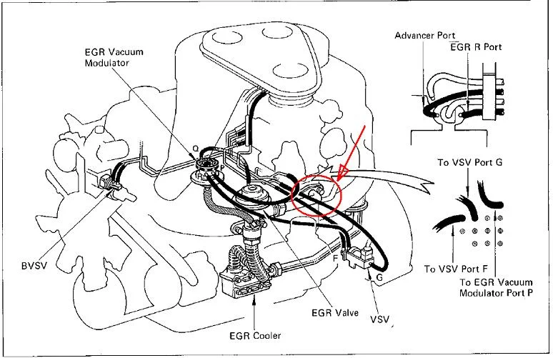

I think I will disable my EGR after this conundrum, as JimC recommended. The best diagram I could find is this:
It is my understanding that I should disconnect and plug at the three places shown in red, and also at the VTV (top left corner), in order to help eliminate pinging. Is this correct? Just want to make sure before I go a' rippin.
