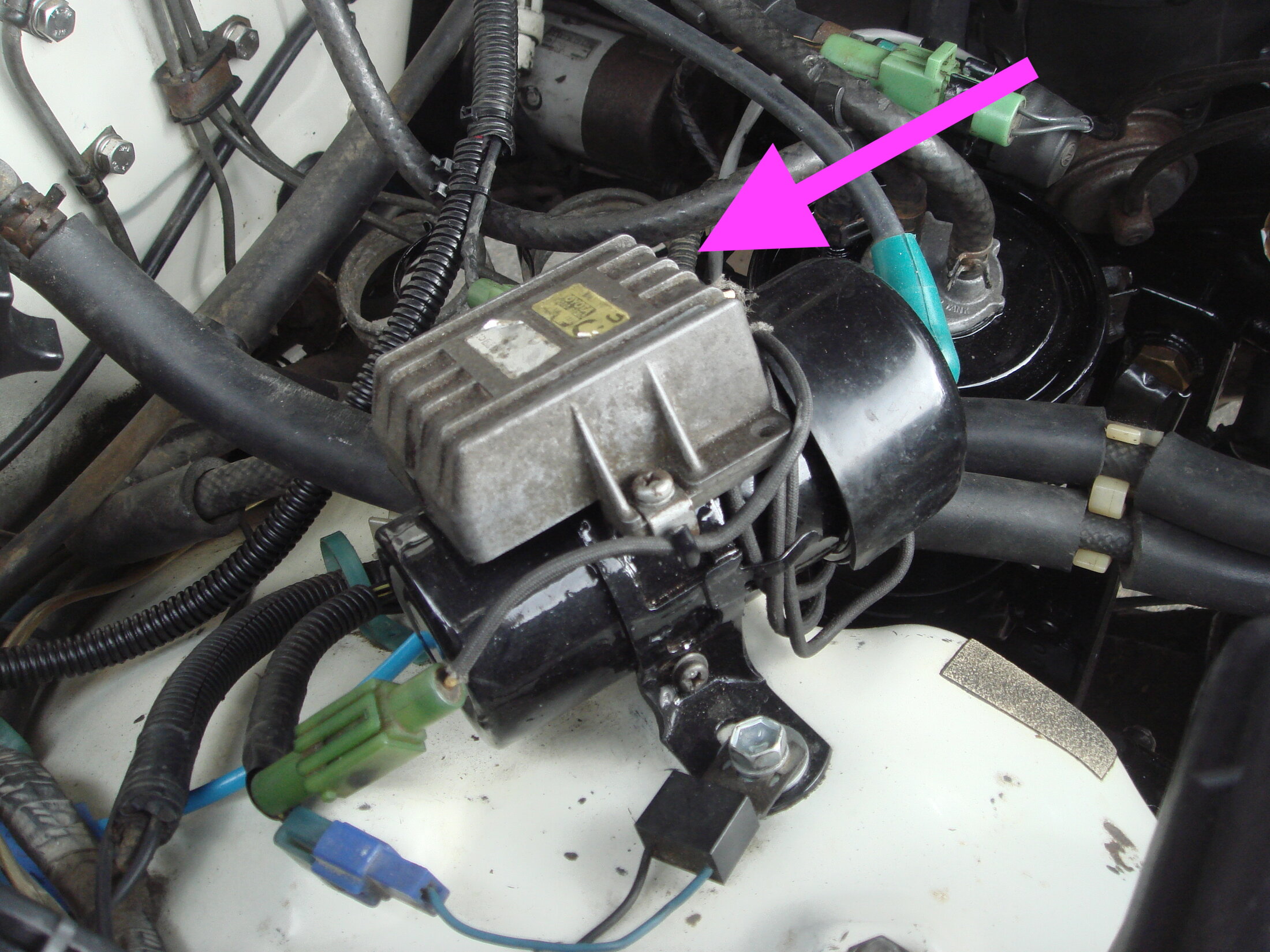

Hello. I have a 1985 FJ60, it died while I was driving it. I have confirmed that fuel is getting to the carb. I pulled a plug and am not getting a spark. Replaced the ignition coil, but no love. I am thinking it may be the ignition control module but I am not sure. Is there a common problem that the hive mind knows about? Should I replace it with a used one? Is there an upgrade to the ignition system that would be a better option for the long run? Any help is appreciated.

ignition module????? ignitor maybe
When the ignitor goes - there won't be any spark. Ignitors are typically very reliable but sometimes (rarely) it can burn out.
There's a procedure in the FSM for testing the igniter.
If you don't have the FSM look under the resources tab, at the top, and it's available there as a free download.
