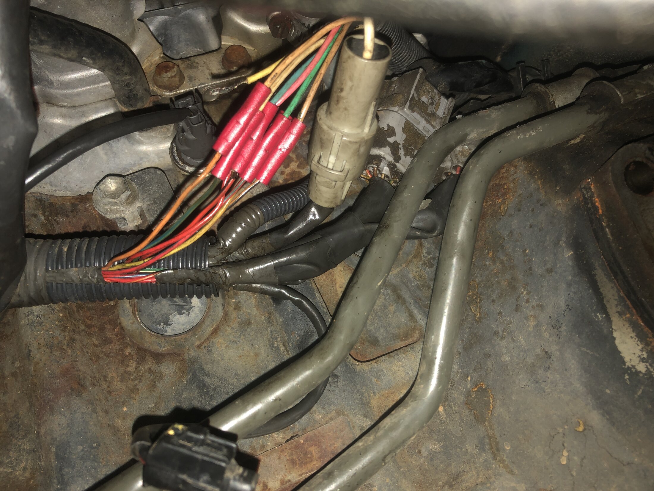

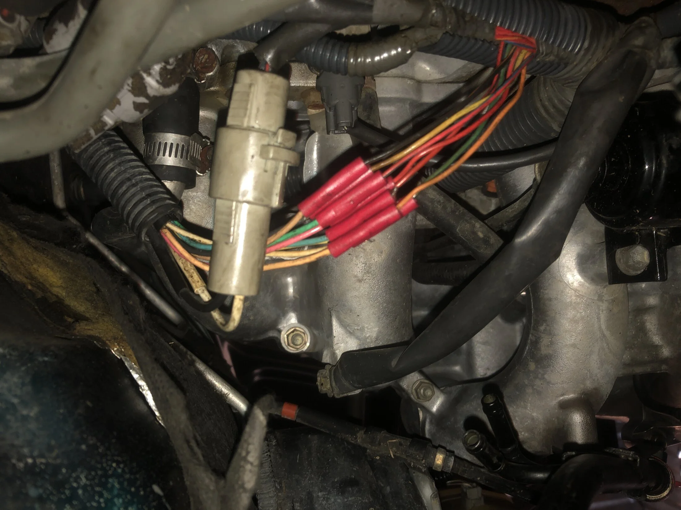

Look in the front drivers side wheel well between the firewall and the top of the transmission. It’s just below the PHH. I bet you have corroded connections for the NSS plug. Hopefully yours doesn’t look mine did before I fixed it. The pics are from my 93. I replaced the crimps with new oem connectors and solved the issues I was having. I hope this helps.
ill have to look for the part number. I couldn’t find it on my phone. there might be a connector list in the resource section.
I replaced that connector just last weekend. I finally have reverse lights and the PNDR12 on the dashboard. Same issue, coolant corroded the connection.
Hope you can find one. I got mine from the junkyard but honestly you can just cut it out like shown above. Just use waterproof butt connectors and tape it well and you'll be fine.

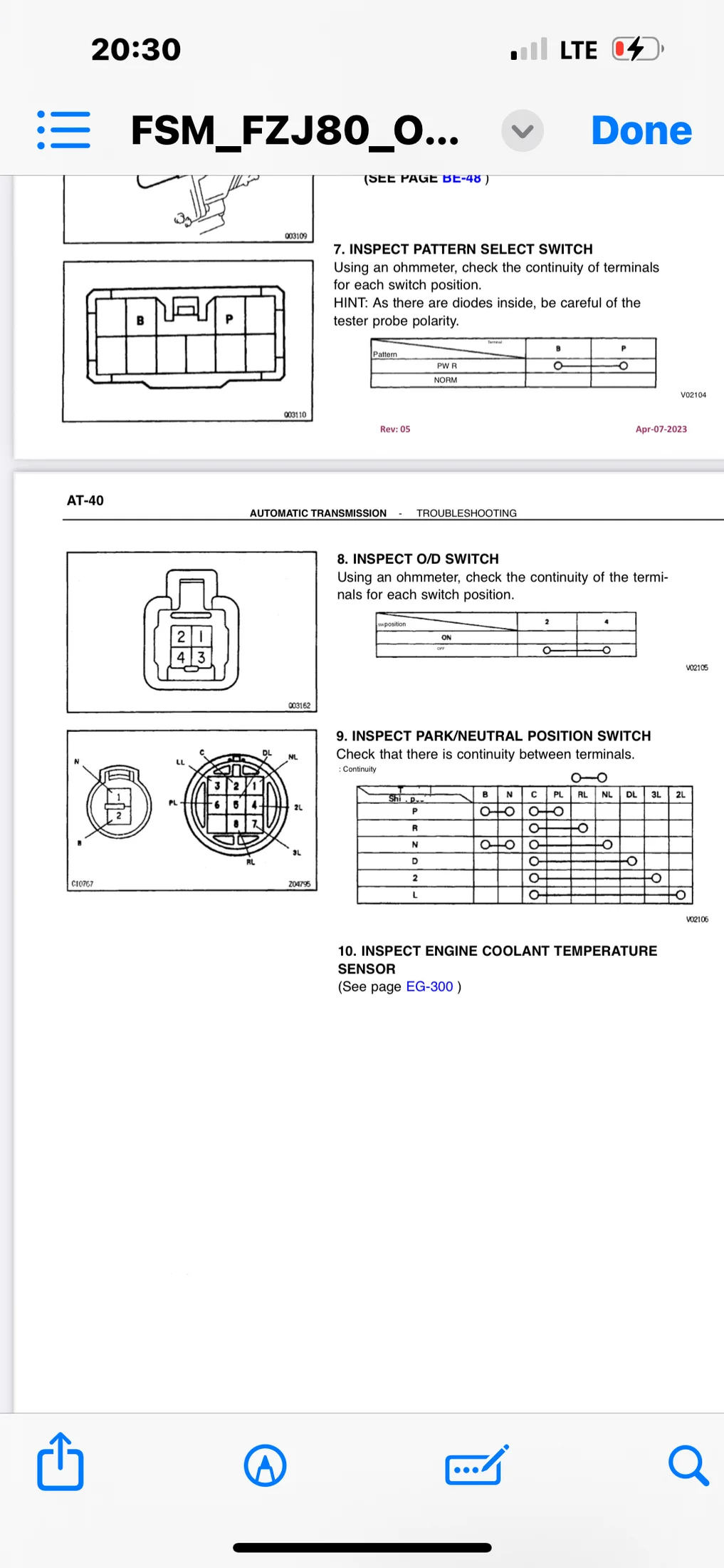

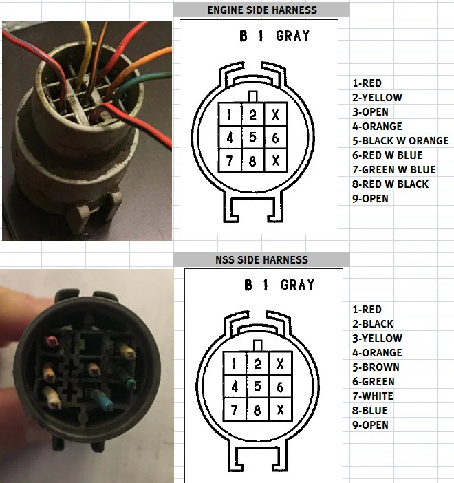

Have you measured the resistance across the park neutral switch? Either at the switch, or at the connector, or even further up at the ECU? If it's more than 1 Ohm or so it's no good.
See table with which pins should have connectivity when, here: Neutral Start Switch (NSS) Removal - https://forum.ih8mud.com/threads/neutral-start-switch-nss-removal.1344958/post-15610374
Also note that the park/neutral safety function has two pins completely separate from the gear indicator switch. In practice this can mean that e.g. "P" or "N" is lighted up in the dash, but you still can't start the engine bc those other two pins for the park/neutral safety are not making contact. I have it in mine that the "P" position is a bit itchy like that, maybe slightly misaligned.

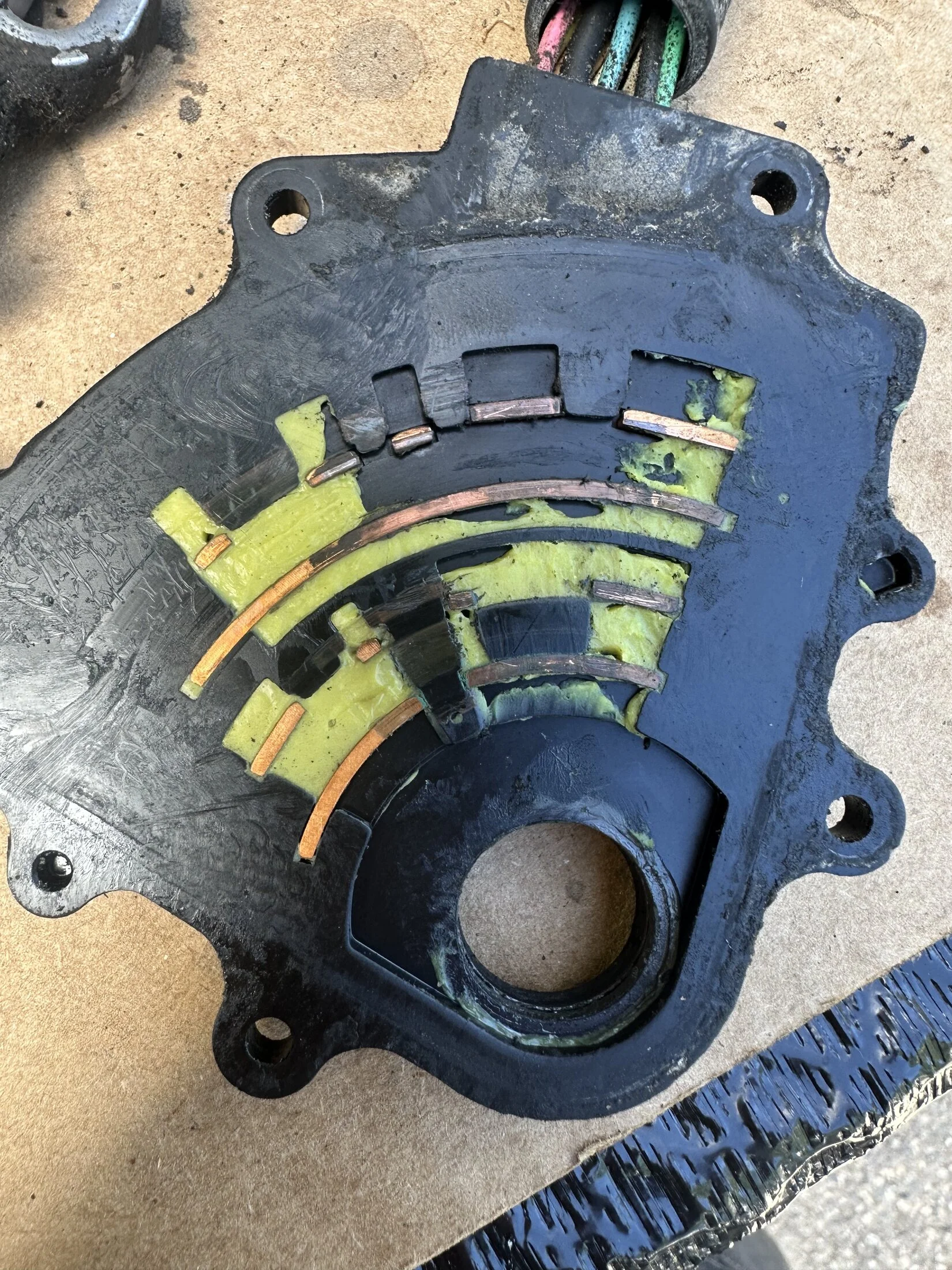

If I had just troubleshot the original problem, check the continuity of the NSS in Park. I would’ve quickly learned my NSS was bad.
I took a spare NSS I had a part, clean the terminals put some new grease. Carefully inspected the connections, tested it prior to installation. And its working correctly, the NSS isn’t that hard to
swap. I really don’t understand what my issue was,
