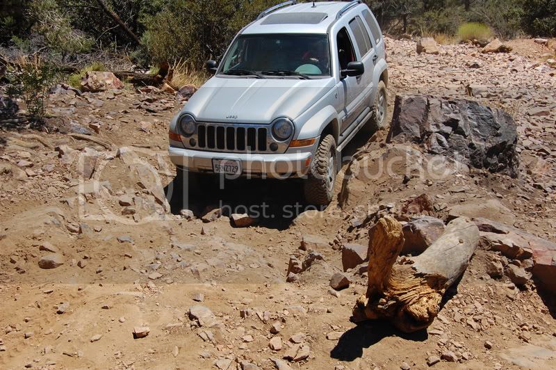

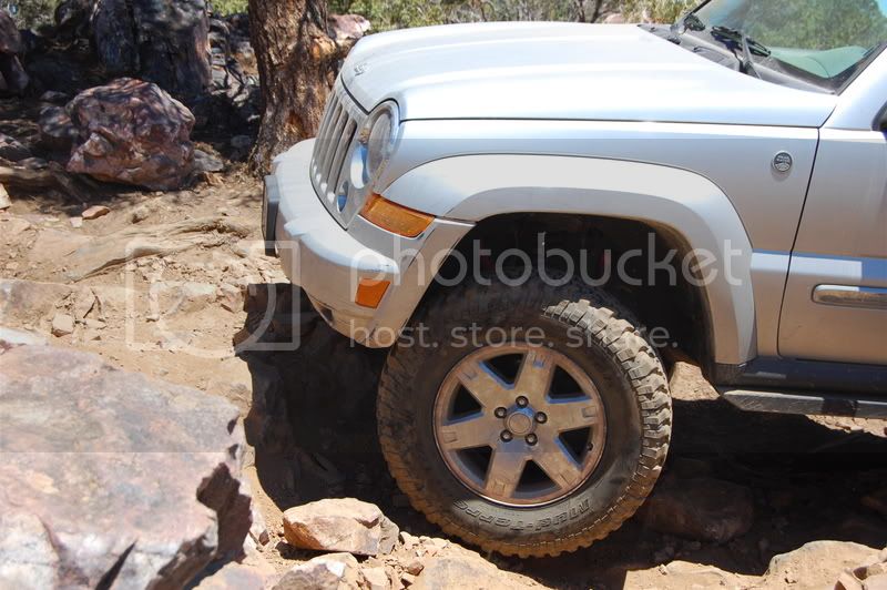

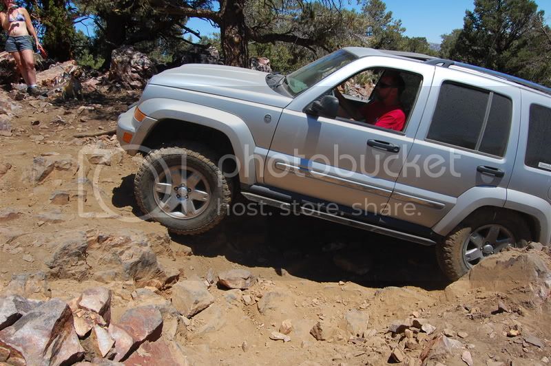

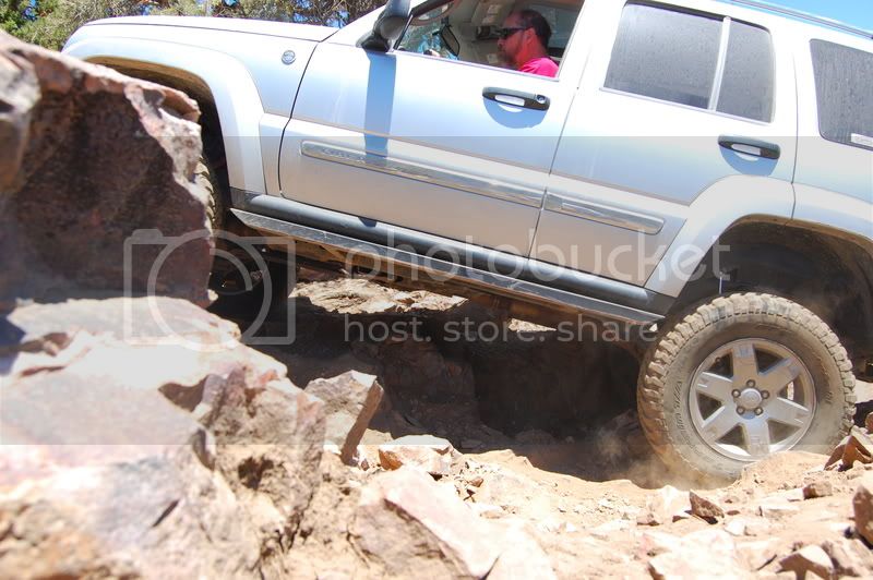

Since everyone loves pictures, here's the ledge in question. Not my vehicle, viewer discression advised. This is on Gold Mountain in the Big Bear area.
