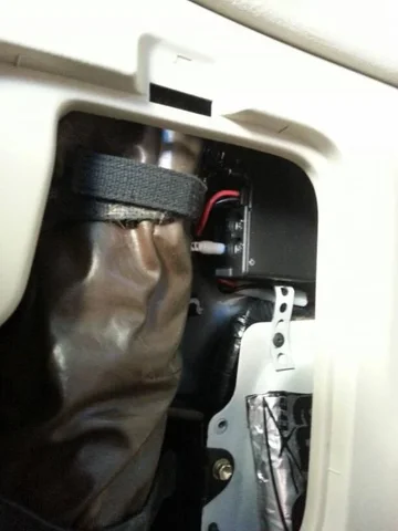

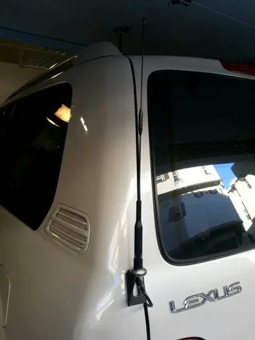

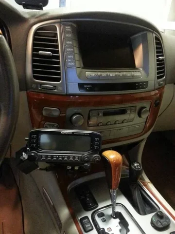

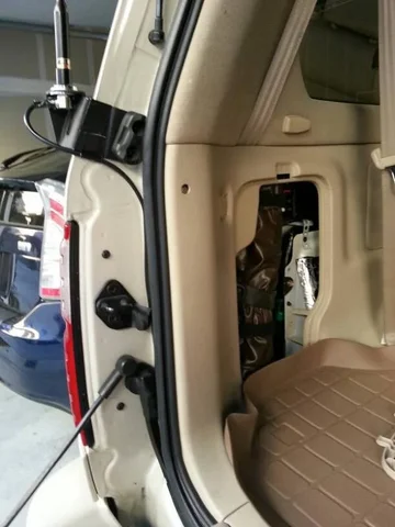

My install Kenwood 710a uploadfromtaptalk1390797093168.webpuploadfromtaptalk1390797125532.webpuploadfromtaptalk1390797150953.webpuploadfromtaptalk1390797181196.webp
contiuned...
But, it's not been perfect. Busted my antenna on this weeks club run. Most of the time I'm fine, but some of our trails have a lot of low overhanging branches. I sometimes switch to a little magnetic whip antenna if the trail we happen to be on is particularly tree filled. If you have the same type of terrain in your area, I'd mount lower (don't know how that would effect it's signal) or get a Gamiviti for up front (some guys in the club have them and really like them).
