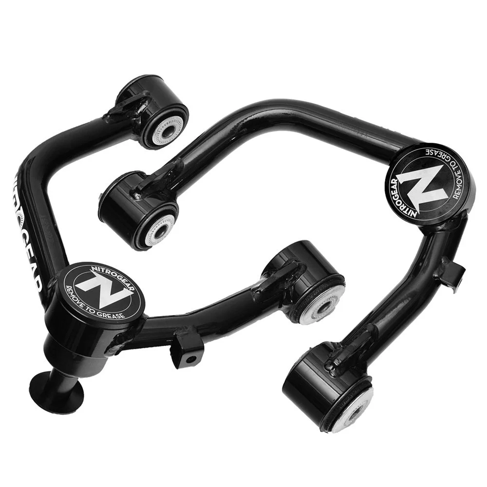

It's got a few Nitro products on it including our new Upper Control arms. The UCAs are in stock and ready to ship if anyone is looking to upgrade before the wheeling season gets into full swing.
  • The arms are 100% BOLT-ON
  • Heavy Duty Grease-able Sealed ball joint offers higher misalignment than OEM, and lasts much longer than uniball type arms, and no squeaks!
  • Removable Billet ball joint Top Cap
  • OEM style Rubber bushings for lower maintenance, quieter, less vibration and no squeaks!- Heavy wall tubular design provides more strength versus the flimsy OEM stamped steel arms.
  • Lower profile than OE, thus providing additional clearance for larger tires, and/or larger/ longer shocks.
  • 3 Degrees additional caster.
  • Will work on stock height vehicles as well.
View attachment 2201569What the life span of the rubber bushings? So instead of greasing them, they are replaced?
If you have the old style Uniball arms from several years ago, we do offer replacement bushings / uniballs, but they will not except ball joints. If you would like to upgrade to the latest type arms with rubber bushings and ball joints, please contact info@justdifferentials.com and we can sell you a new set at a discount.
