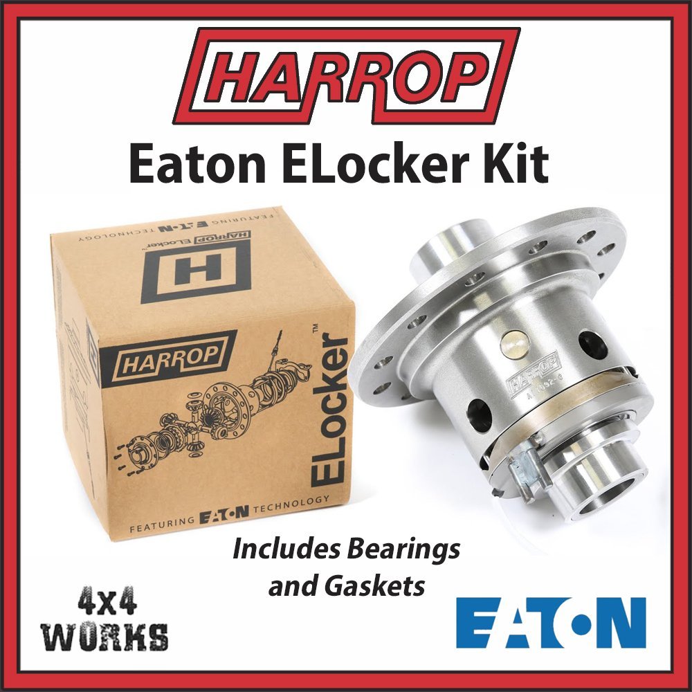

They do, but I've read that they disengage if you go into reverse or let the vehicle roll backwards?
A lot of people are putting them in 80 series. I have not studied them closely but I haven't read anything about them unlocking in reverse.
Edit: Quick google appears to confirm that they unlock in reverse and immediately relock upon going forward. I would have to think about whether or not that's an issue. Not sure I ever drove my 80 backwards locked (or at least ever needed it).
The crap part of the e-locker is that it temporarily unlocks after a direction change, either forward to reverse or vice versa. It's not a huge problem, but it's a part of the operation that the owner needs to be aware of so that they can expect a jerk as the diff moves through the unlocked position. Think about going back and forth to get out of a mudhole...it would not be helpful to have to deal with that characteristic.
Is that just the Harrop e-locker, or oem as well?
Harrop/eaton. Toyota e-locker is a whole other mechanism.
Regarding the Detroit E Locker, Dirty Motorsports has a great video showing on the bench how all the various designs work . The explanation of the E Locker begins at 14:15, you can see the ball bearing and cam design that causes the slop between forward and reverse engagement:
