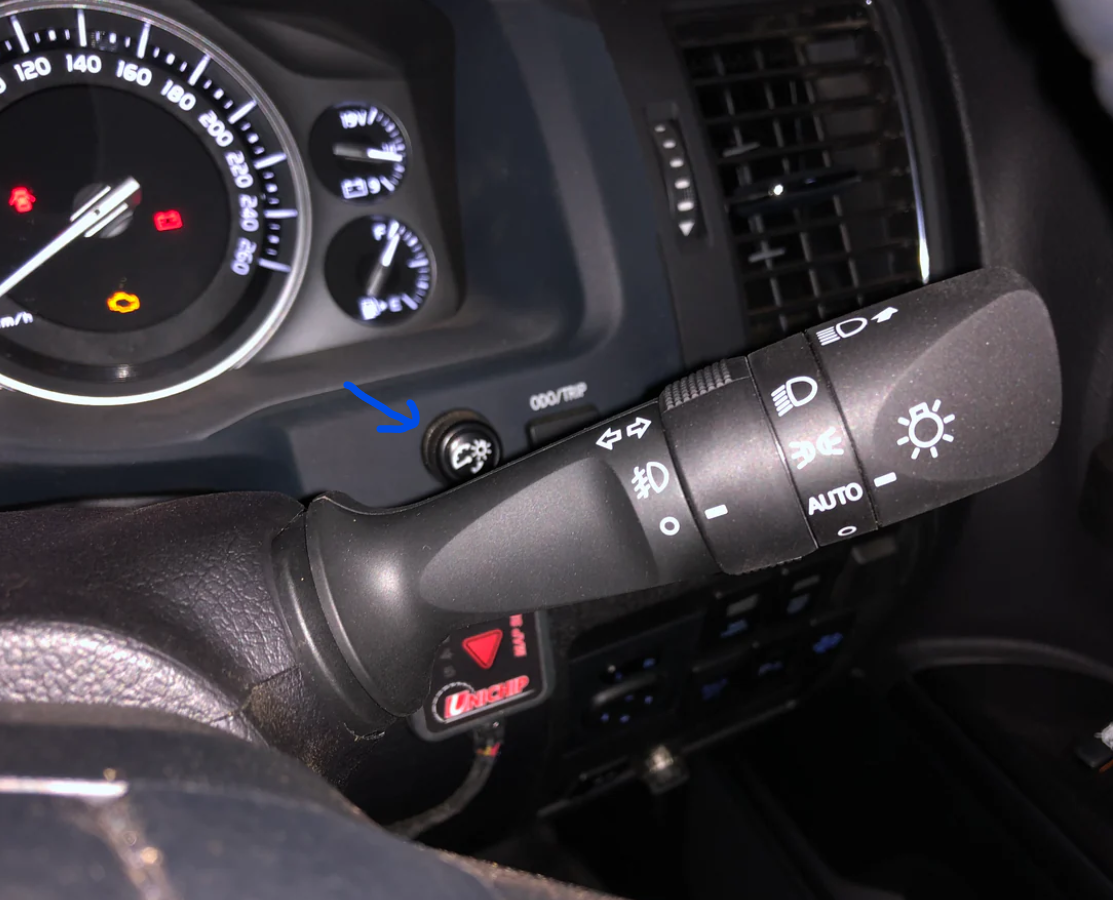

On my 16+ LC200 i have a little knob left of the steering wheel under the dials which allows me to adjust the light level. When I turn that up (clockwise) including past a click it will go to full bright, day or night.
The "normal" or "preferred" position is turned up however not past the click. Have a look. Maybe your 2014 LX570 has the same.
My LC200

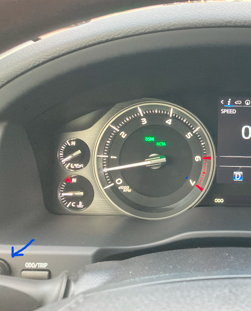

Form a RHD internet picture showing the dial
My LC200
Mine was turned to the max; that must be it. Another problem caused by the damn nut connecting the seat to the steering wheel!
