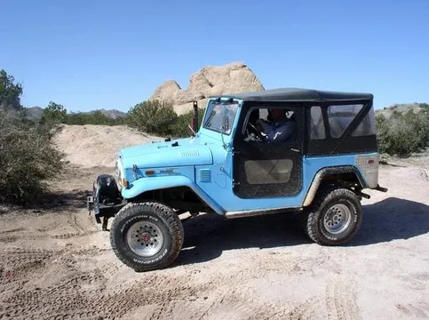

Looks lifted to me and don't see long shackles? It could be aftermarket springs or add-a-leaf in stock packs. Look for markings painted on the top of the packs. Good pics may help, what leaf is broken and where, in the middle or towards the end? What brand/color shocks are on it?
What should stock height be? My rear fender is cut?
Don't know what the stock height was, probably doesn't matter, they are mostly sagged by now? Yep, those quarters are cut.

took some pics while at work.
They look like OME shocks. Can't tell. No markings on springs.
Also attached is the pic of the broken spring leaf. Rear leafs looks like 4 leafs.

I think those springs look lifted. Which leaf is broken? Can you take a picture of it?
Not a "good" break location, needs to be addressed. I'm not up to speed on the springs on later '40s, but that doesn't look stock and most that I have seen have more leafs? Ruff Country maybe?
