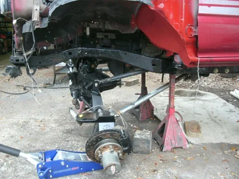

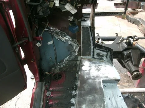

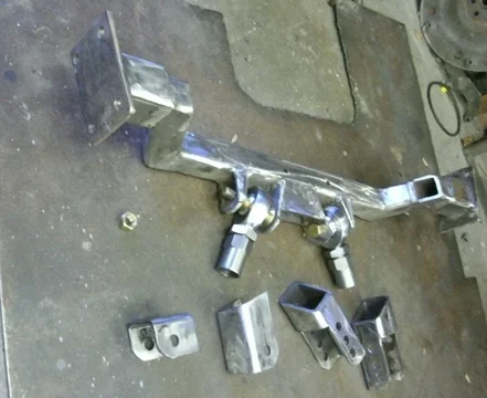

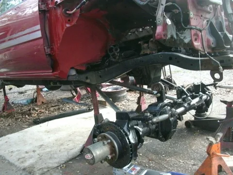

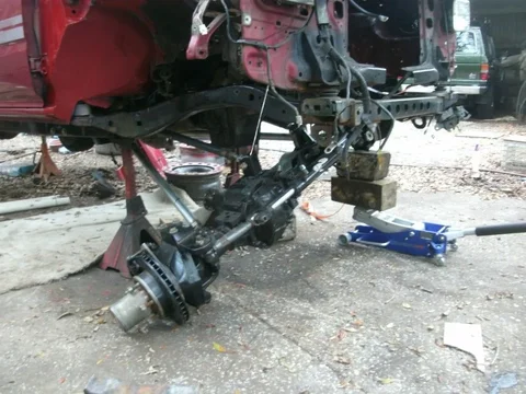

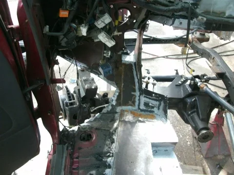

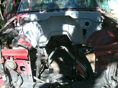

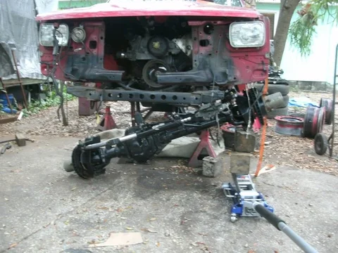

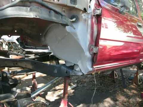

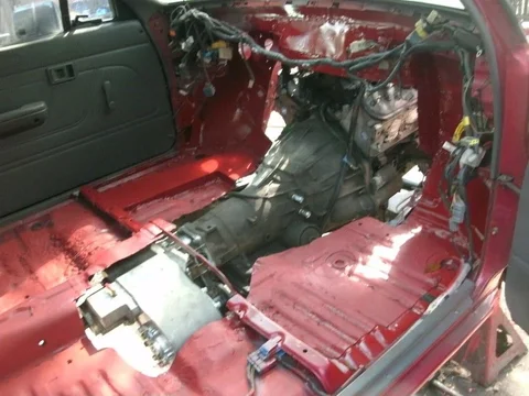

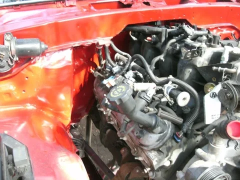

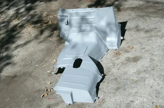

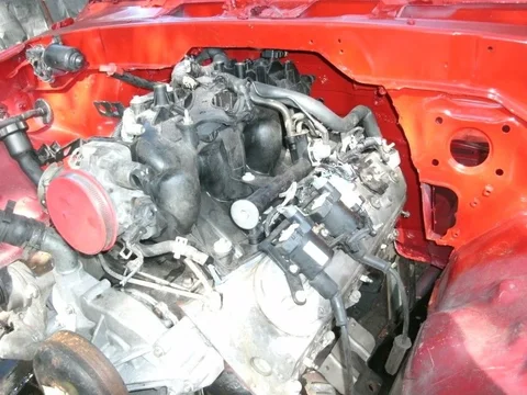

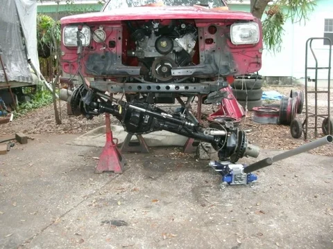

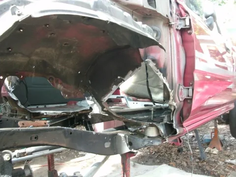

LINK-BB.webp FW-03-bb.webp FW-05-bb.webp FW-06-bb.webp FW-7-bb.webp Some progress made

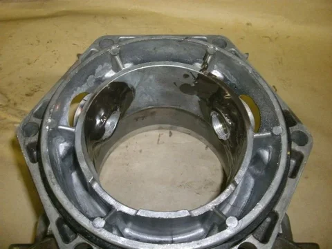

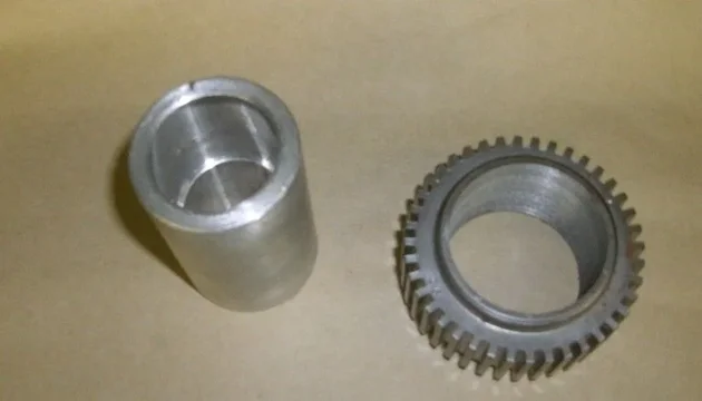

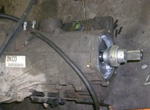

Forget paying Advance Adapters $500 for their 4L60adapter/reluctor/sensor kit.

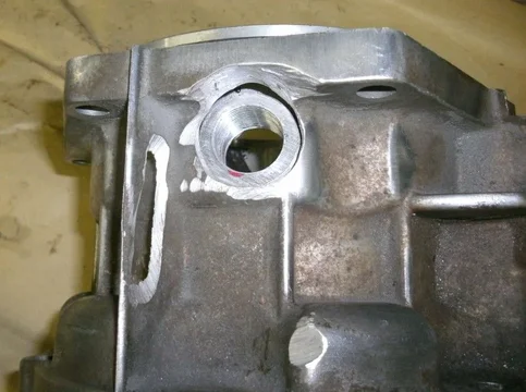

The stock factory 4L60E piece fits fine after drilling and modding a stud hole. Made an aluminum bushing for a NP203 reluctor and a couple of sensor bungs out of aluminum. yeah they're welded under the slathering of JB weld.
hmm I said bungs
