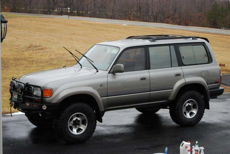

My buddy Steve just got a 93 for his wife, with J's and 30mm spacers up front. Slapped 345 KM2's on it, very minor trimming to the inner fender/flare, stuff's them all the way....no rubbing. Still wheels well in Low range with stock gears (rock crawling) It's not going to get from Durango to Silverton real fast (more than 8000ft of mountain passes - Coal Bank and Molas Pass) but it's not going to blow up or anything....just slow up steep passes.
Nice Sage 40th...very desirable. Welcome!:beer:
