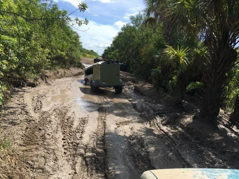

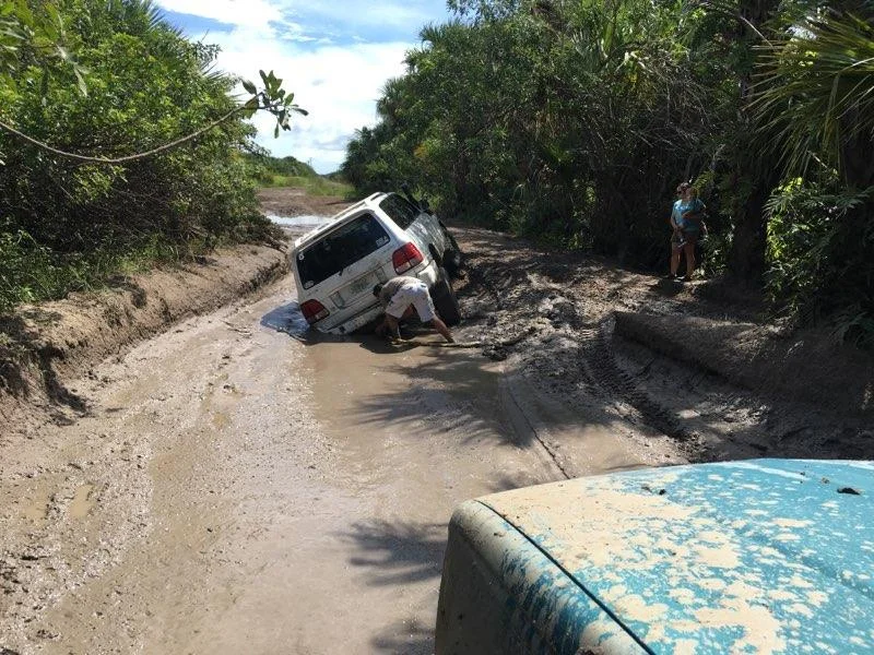

Well, wife and I went out with a friend to get some experience maneuvering the trailer around trees and such. We both managed to stuff up decently, with her taking a bad line through a mud pit and getting soupy mud into the passenger side of the car, and me trying to straddle some ruts and falling in in the worst possible way. I don't think we quite hit 45 degrees but it was close. We detached the trailer and my buddy dragged it backwards out of the mud. Then, he hooked to my rear end and very gently pulled me backwards while I turned to the right. We managed to get the front end to roll down the embankment and just like that, the car was level again. The shallow bits were only a couple inches deep...the hidden ruts were easily up to my knees.
My wife was not thrilled at the whole thing, and I'm pretty sure some poo came out of me, but all's well that ends well. We were mostly too busy trying to avoid a bad day to get too many pictures, but we snagged a few. Had like five hours of cleaning to do when we got home.
