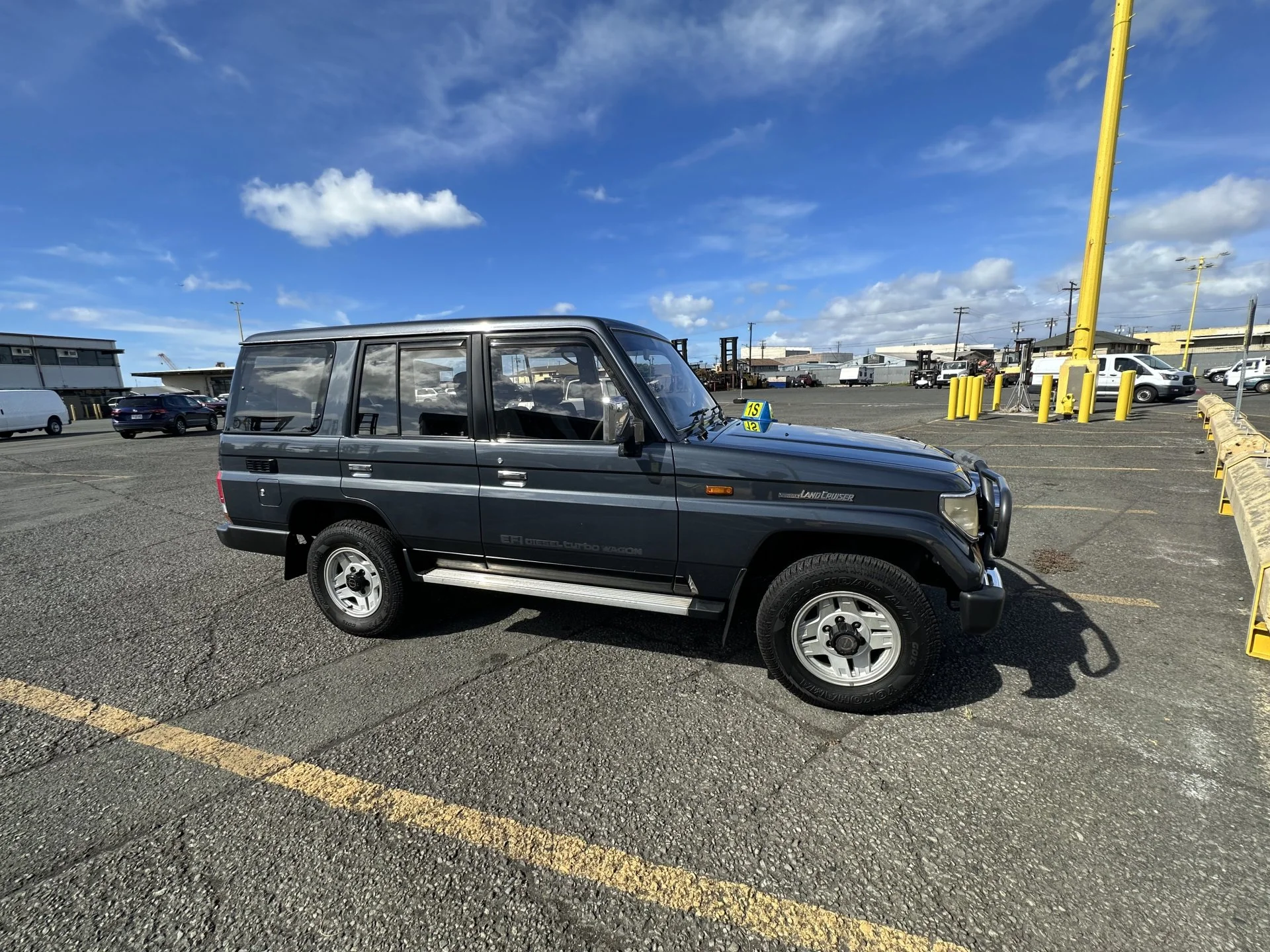

Joined the club a few weeks ago! Stock everything so I’m looking to upgrade suspension/wheels/tires. Any inspiration and/or recommendations from you folks are greatly appreciated. Already have my eyes set on dobinsons for the lift with their fall sale. Definitely want 33-35” mud tires and classic looking wheels.
Welcome,
Looks pretty clean and low miles. Check your bushings and replace them if necessary. Front axle knuckles bearings with overtime tend to leak, try not to pressure wash them directly, rebuild if necessary. Check your tie rods. I would probably replace the axle fluids just to have peace of mind. Grease your U-joints.
On tire size try to keep them skinny, don't go too wide.

Yeah you! Shipped it from Oahu to Lana’i. I know ironman4x4 as well as Dobinsons are having sales, im going with Dobinsons to upgrade the bushings and steering dampener as well.
Thanks for the recommendations! How wide is too wide? If you don’t mind me asking

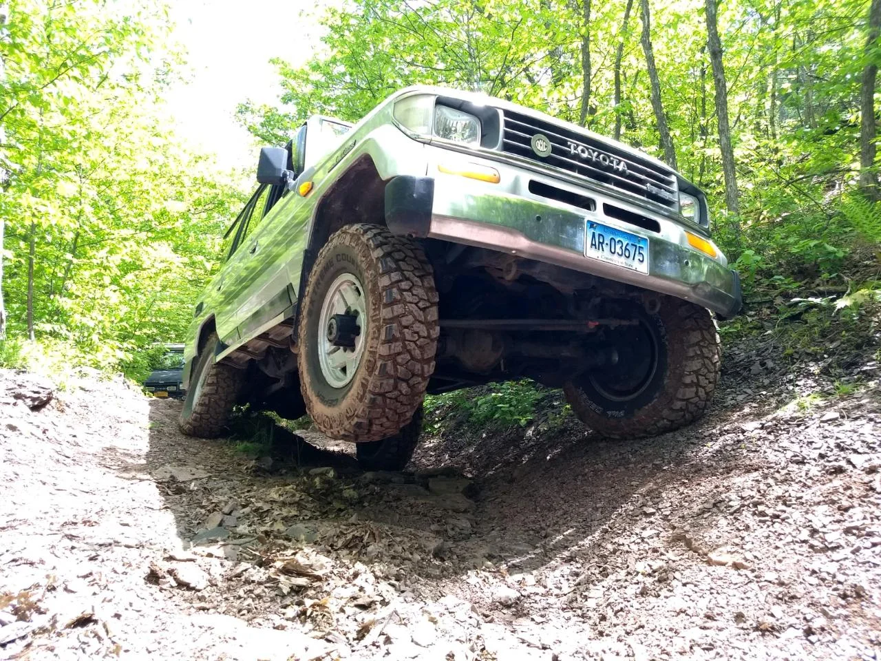

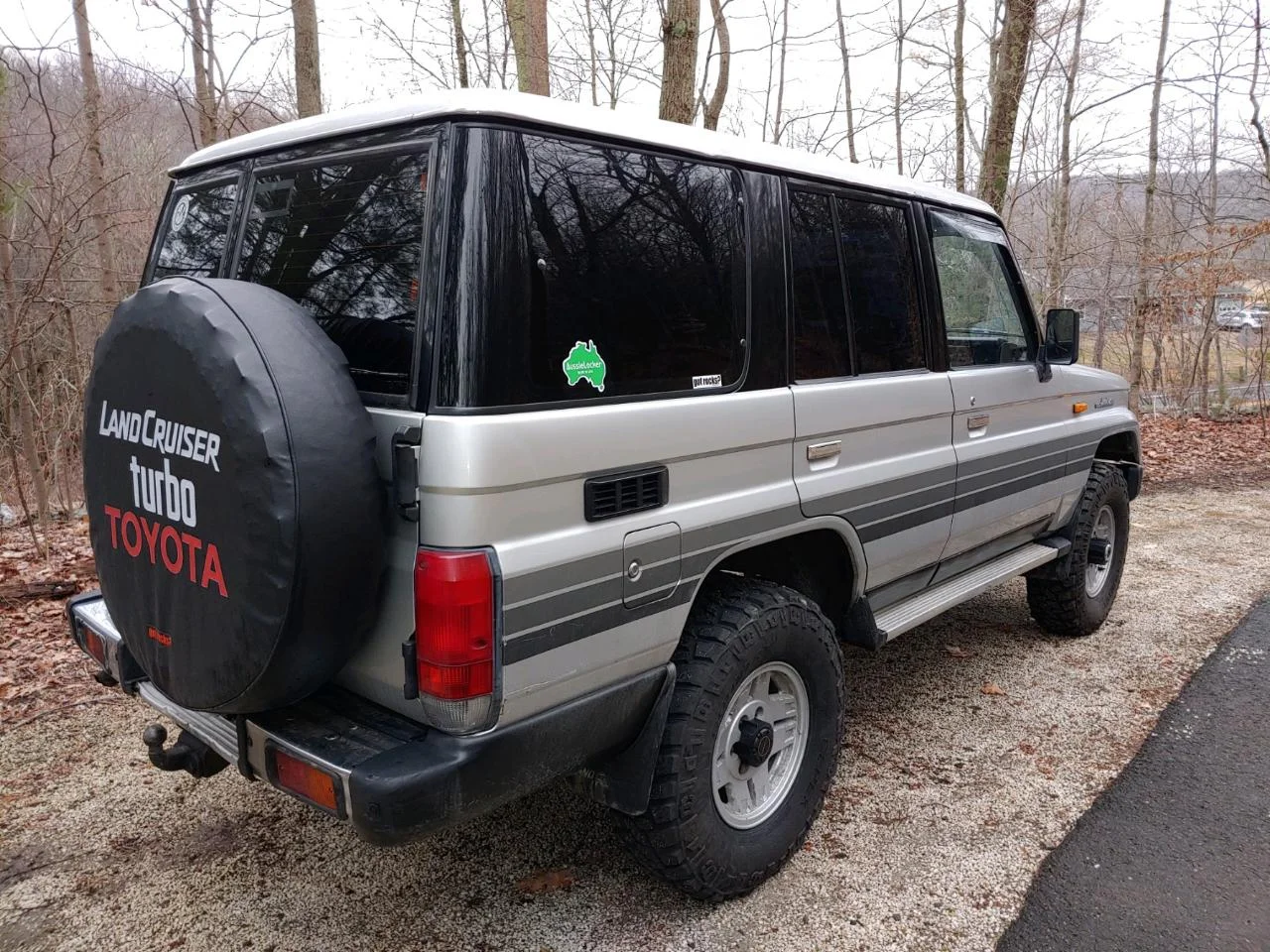

I have the 2.5 inch lift on my 91 LJ77
Running 255/85/16 MT tires (33")
Lame excuse for a picture
Love it. Nice ride and works well off road:
