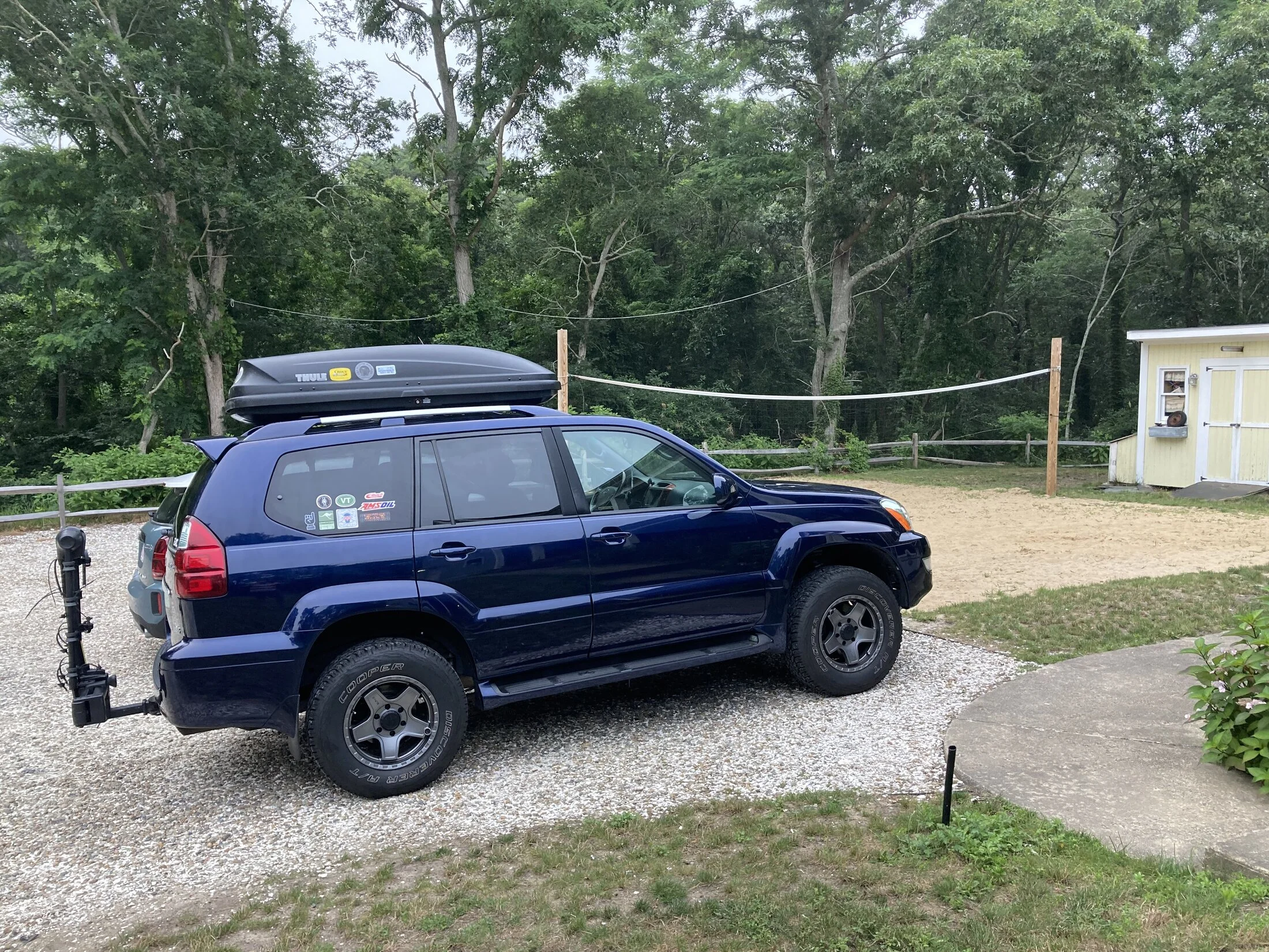

Today's random thought, does anyone run a bike rack that just straps around the rear door ? I see plenty of options out there. It it seems like most searched turn up results for hitch mounted bike racks for the gx , maybe the door mount isn't a good solution ? I don't need anything to rugged on this vehicle , just light duty bike hauler to local trails
Not exactly an answer to your question, but I'm a bit of an oddball but run a roof-mount. I've had both Yakimas (before I got a thru-axle bike) and now Kuats. My bikes are all 17 to 26 pounds, so they aren't too bad to lift onto the roof of the GX. I grab the bike by the top tube, step on the rock slider, then stand on the back tire and set the bike in the rack. I don't see why you couldn't do the same thing with the OEM side steps. We've hauled them thousands of miles this way when towing our camper and taken them on/off dozens and dozens of times.
If you have a 30+ pound full suspension MTB this might not be the best option. You also have to be careful about loading/unloading. If you are parked off-camber it can be difficult to get the bike on/off. Hitch mount racks are just too much $$$ IMO and would impede cargo door access. I think the rear door could easily handle a bike from a weight perspective (the Prado has a spare tire there, after all), but I've not seen anyone try that on a GX.

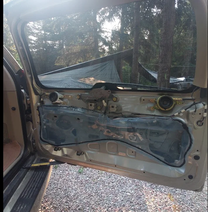

IMHO the rear door of the gx is a part I don’t like to mess with. I recently had to replace the actuator motor and it was a pain. I got a swing out hitch mount for $100 on Facebook marketplace and it’s been great. Never seen a door mounted rack on a gx so I’m certainly no expert but it seems like roof or hitch mount would be better.
Awesome thanks for all of the tips. I think on this vehicle I'm going to try and continue to theme of, keep it simple. I'll just open the back door and put the bike in the trunk area with the seats folded up and a moving blanket laid down lol problem solved, no money spent. Unlike my other rigs that need to fit a slew of camping and recovery gear, I'm like the idea of just keeping this thing a bit less over done. ( refer back to this post next year when I have like full armor and 17 light bars )
The roof idea does seem cool and I'd like to get my 100 series setup like that at some point. I don't ride one of those out of control over priced things they call mountain bikes now a days but I am rocking a full steel frame Surly which isn't too light, but I'm sure I could huck it up to the roof if I had to.
