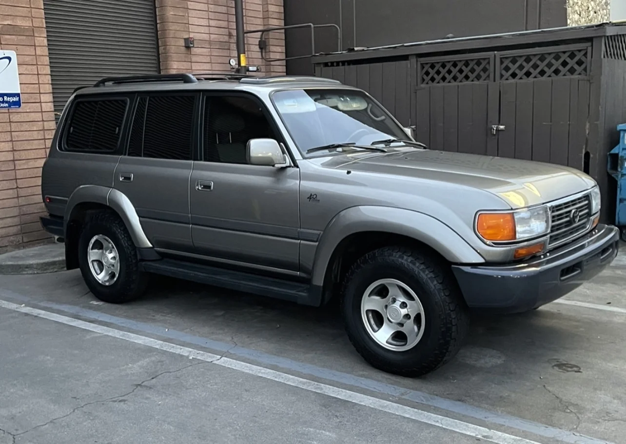

Hey Gang,

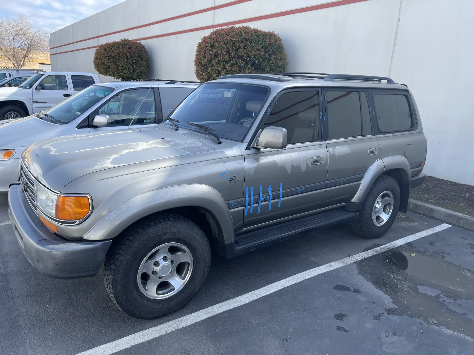

I'm thrilled to share some good progress I've made on my 97 40 AE. I purchased the truck from a dealer in Colorado back in February with 284k on the clock. I had it shipped to me in San Francisco after reviewing a few pics and paying the dealer his asking price. I've been looking for one for a while and figured it's time to take the plunge. This was my dream car in high school and it was finally to be mine. The truck arrived about a week after wiring the cash and I expected some cosmetic work etc but it really needed some love. So much that I've actually only driven the car 3 times since delivery as she's been in the shop since 3/1/21. I live in downtown San Fran so working on the rig isn't an option as my building doesn't permit any work whatsoever. So I've had to work with several shops for the paint, mechanical, upholstery etc.
This will be daily/weekend cruiser that will not see any "real" off-road duty. More of a leisure wagon and I hope to keep her for life. Ultimately, I want this to look/feel like it just rolled out the local Toyota dealer in 1997.

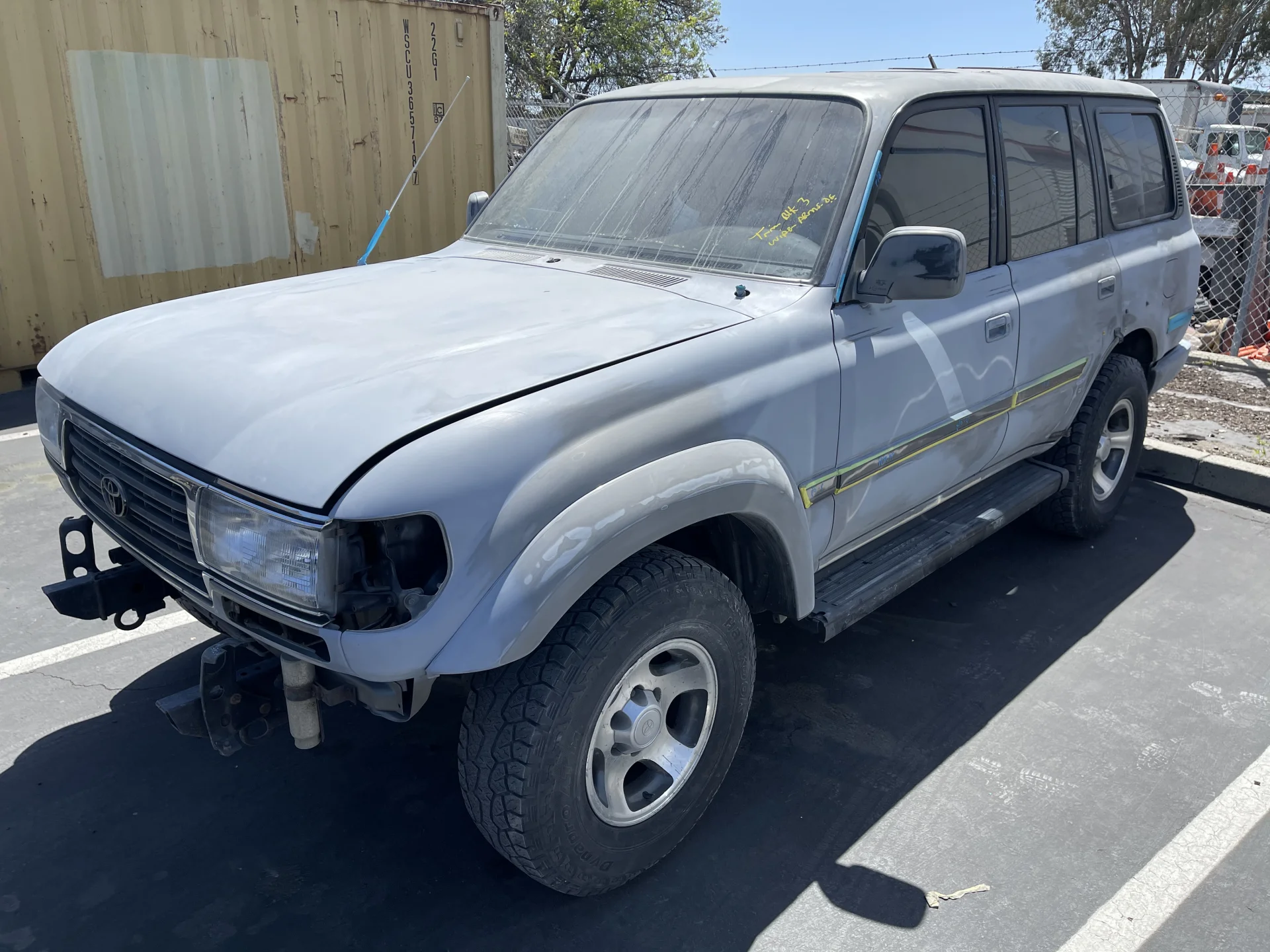

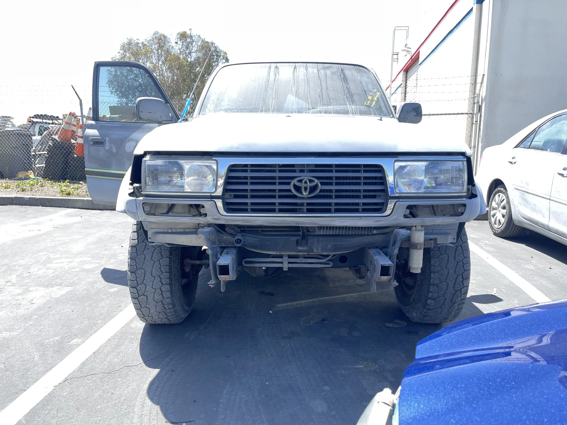

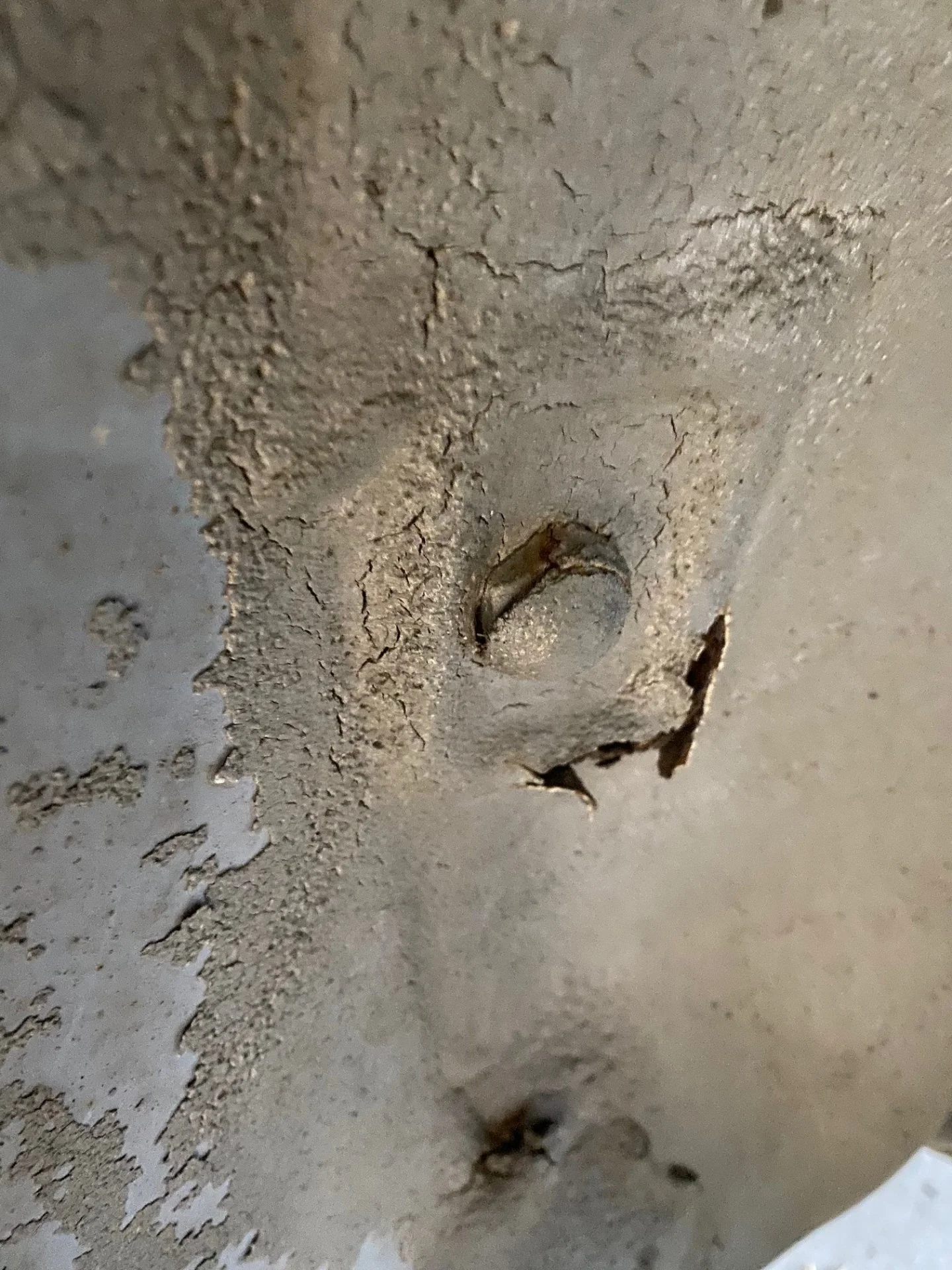

Paint and Body: The body was largely rust free but plenty of dings/dents and of course the faded paint/clear. The frame has some minor surface rust but nothing that can't be cleaned.. More importantly the inner fenders (front L + R and the Right Rear) had some rust that needed to be cut out and new metal put in place. I was a little concerned about this but the body shop walked me through repairs and they were familiar with how to fix it. I was looking for a showroom finish and got the whole rig sanded/sprayed etc. Came out very slick and in factory Antique Sage color.

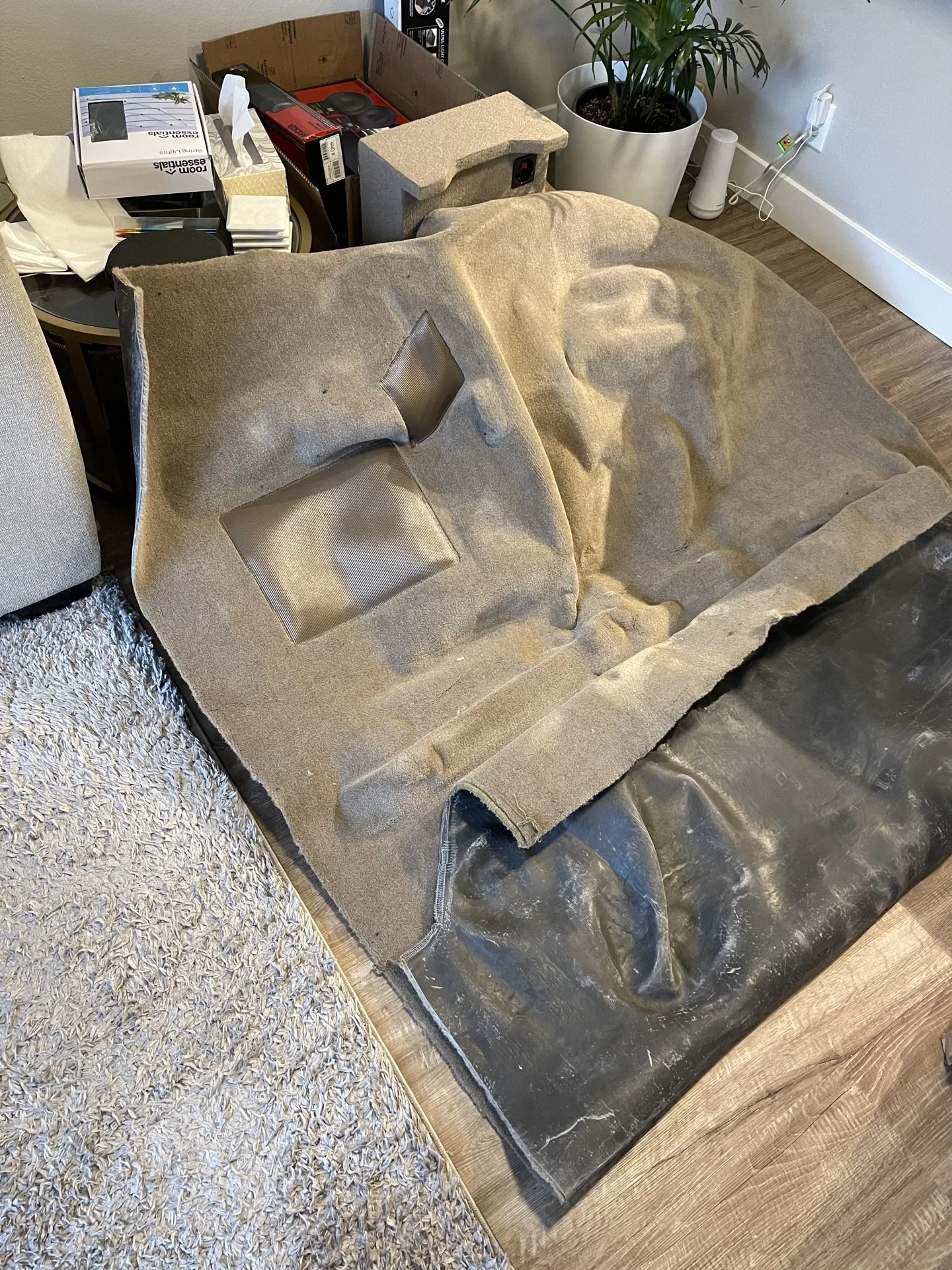

- New ACC molded carpet with mass backing

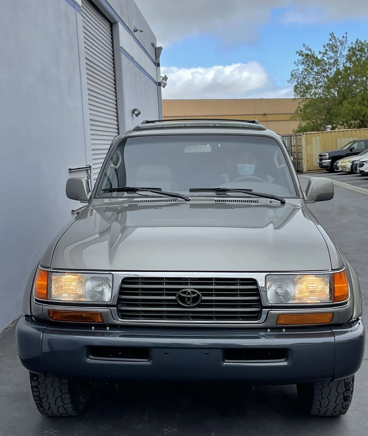

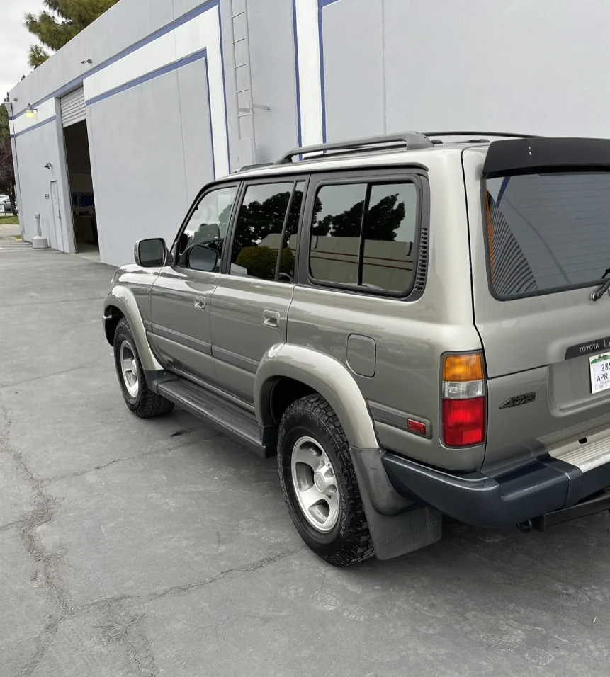

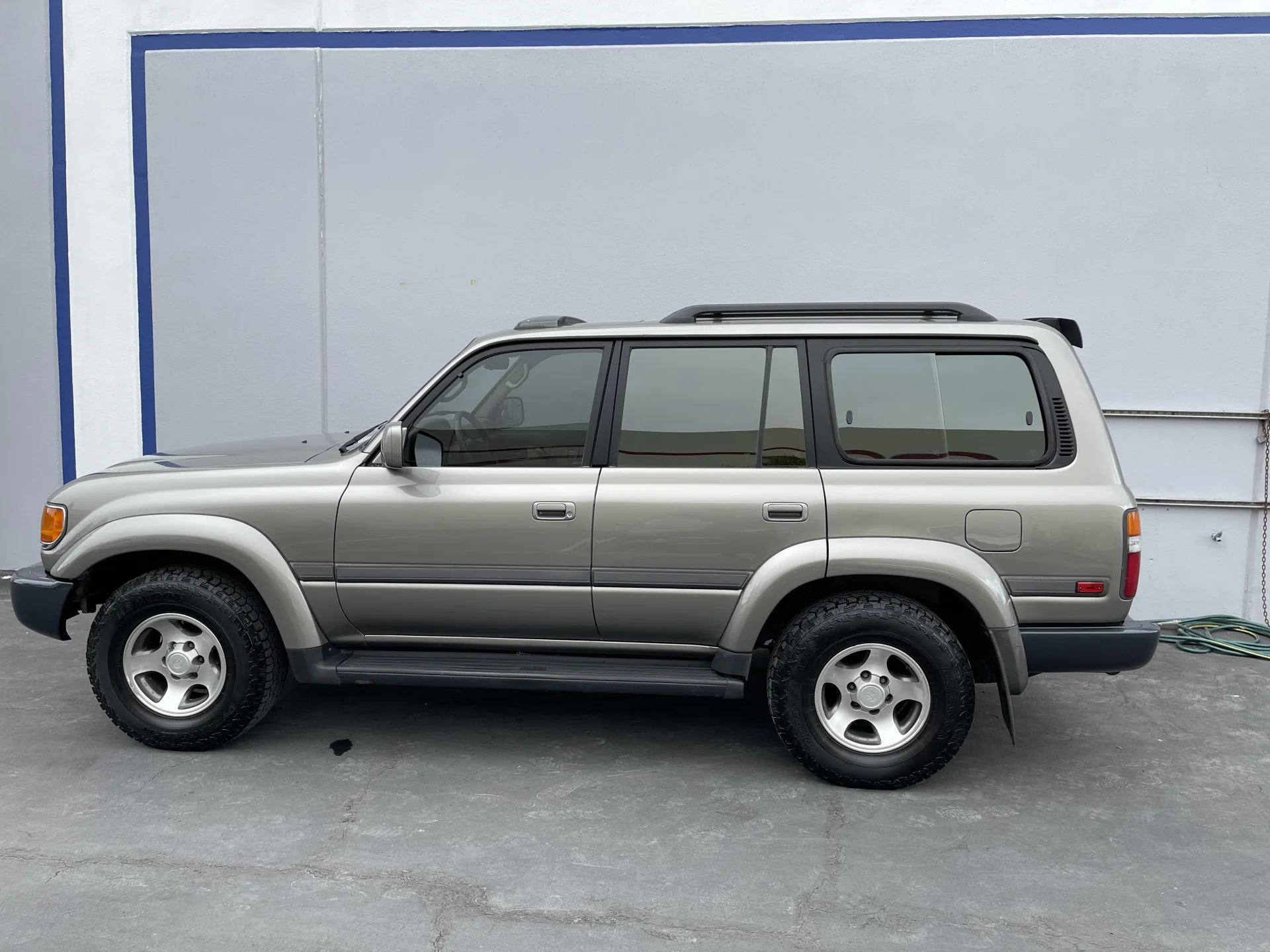

Enjoy a few pics - What she looked like at delivery vs now is a major change. Lot's of time, energy, and funds to get her this far. Still lots to do, God willing!

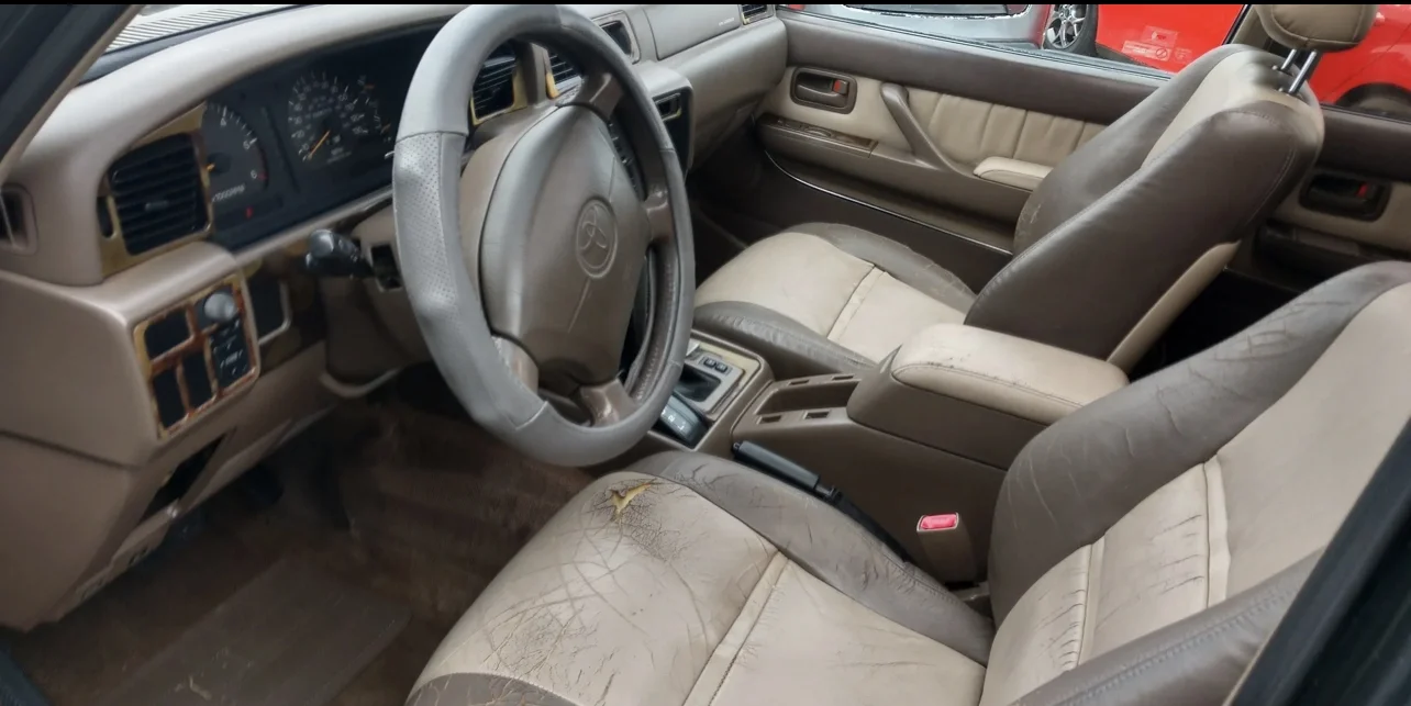

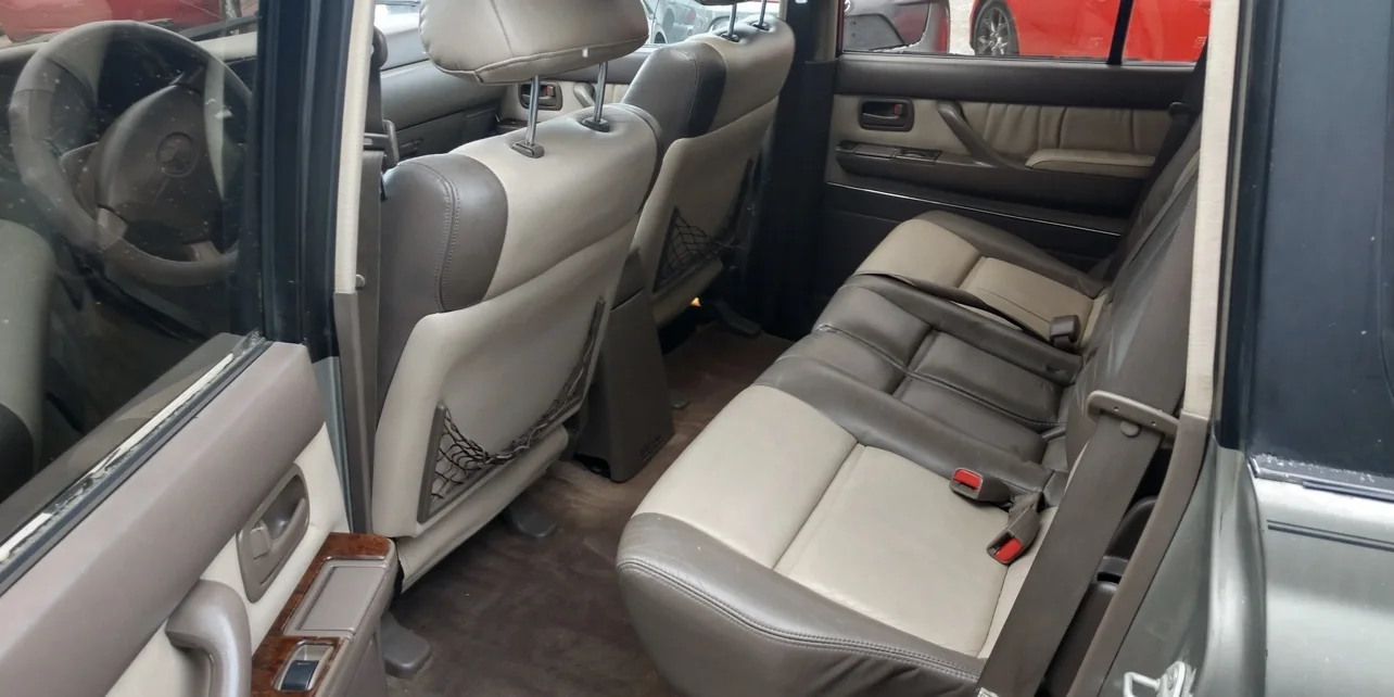

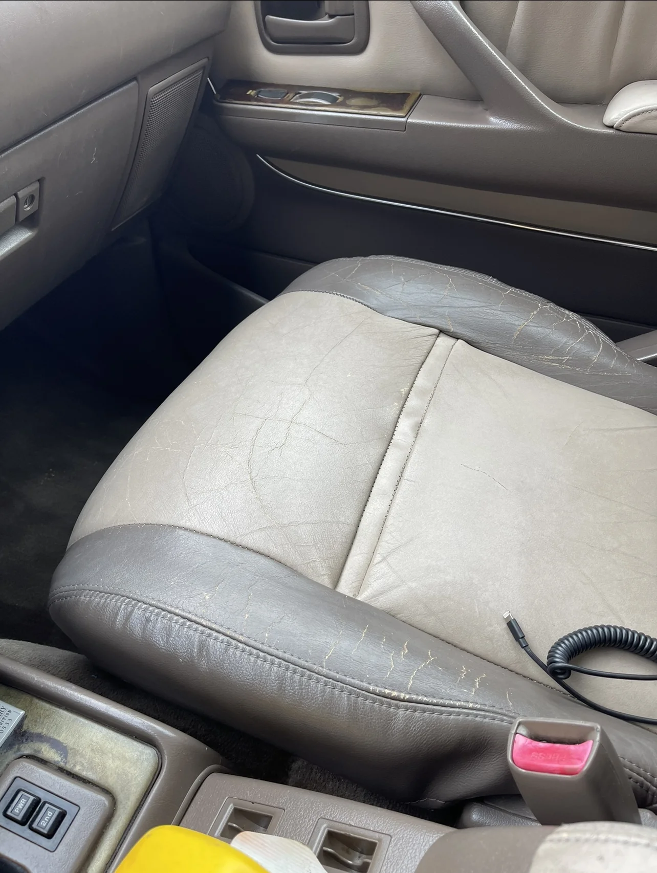

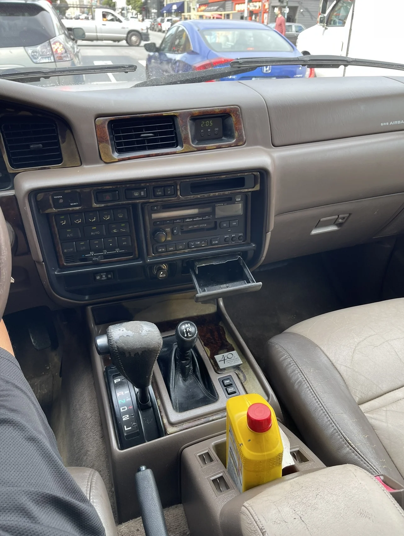

Sadly I was super tight on time between picking up from body shop to mechanical shop, to then upholstery shop (all back-to-back) so I completely forgot to take current photos. These are from the sale ad and hide a lot of the typical carnage on driver seat. Foams were super hard and leather was ripped in multiple places. Steering wheel made a massive difference in feel and drive comfort.
The back seats were in great shape (Both 2nd and 3rd row) so I'm just having them cleaned/conditioned. Down the line once the motor is sorted I may upgrade these to LCH set as well should they not match 100%.

Good luck with that dash kit. My experience is that they are NOT an exact science. My ebay sourced kit matched perfectly meaning it was the exact color/burl, and terrible fit. Thankfully I only replaced the parts that needed to be replaced. If I had done the entire kit I may have lost my mind. My OCD had to be turned off. Turned out great, you just have to tell yourself they were like this OEM as well. The center clock/airvent was particularly a challenge.
That’s healthy perspective and I’m going to have to shut off the OCD as well. Getting the old stuff off was tedious but semi-successful. I got my kit on Amazon I believe but it was 2.5 months ago so I could be mistaken. Here’s a pic:
That looks like the "large" burl. Very nice kit. It may fit better. Still not sure if these things are plastic or real wood. I think the secret was only known by Elvis and Jimmy Hoffa.
Haha! Honestly, they feel a little rubbery but for only a few hundred dollars they’ll do just fine. The original stuff wasn’t much better. Kind of cheesy but I love it- very 90’s.
