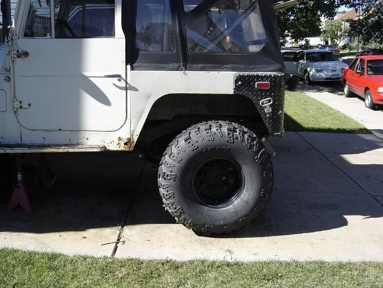

first pic shows how the fliped rear 60 springs turned out the first time i did this.

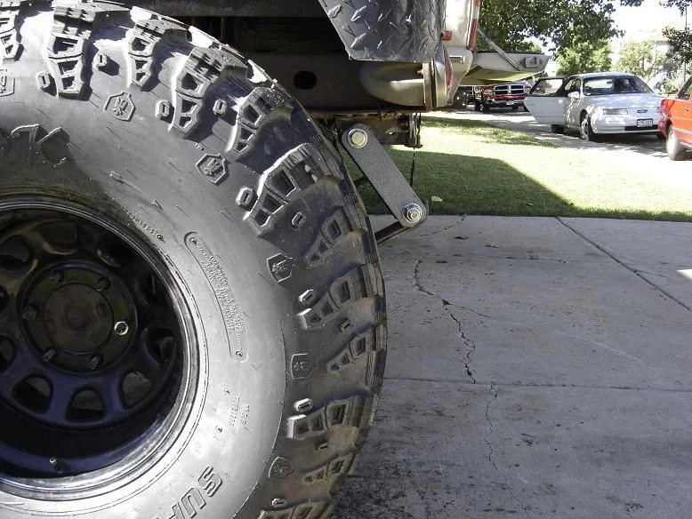

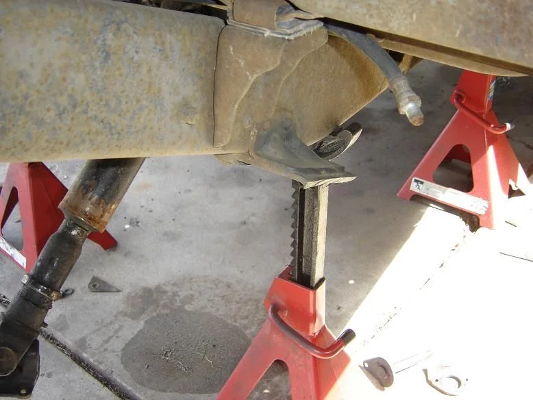

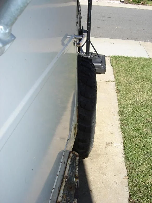

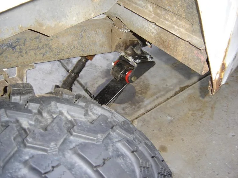

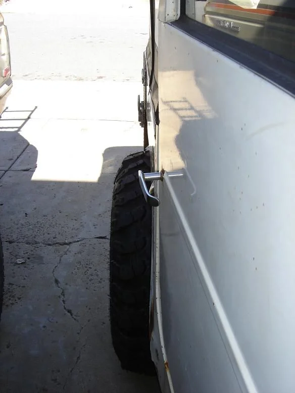

the rest are of cutting hangers,shackle angle and how much more wheel base i got out of this, along with a nice departure angle.
ok, second pic shows wheel/axle placement https://forum.ih8mud.com/showthread.php?t=161665&highlight=ROTW
