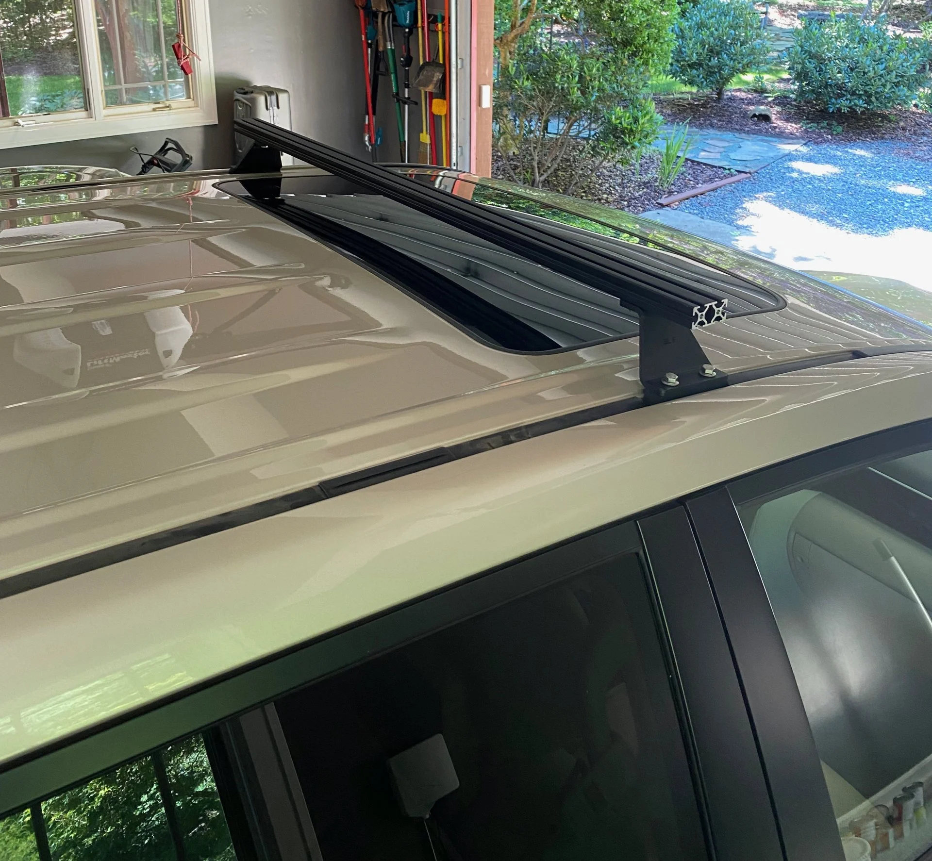

I guess there's no way to keep the part over the sun roof clear? I was hoping you wouldn't have to install the bars there but it looks like that's where the front most mount is.
Yes, the front-most mount places its crossbar over the rear 1/4 or maybe 1/3 of the sunroof. The crossbar forward of the front mount (not pictured here) has a lot of adjustability forward and aft, if used.

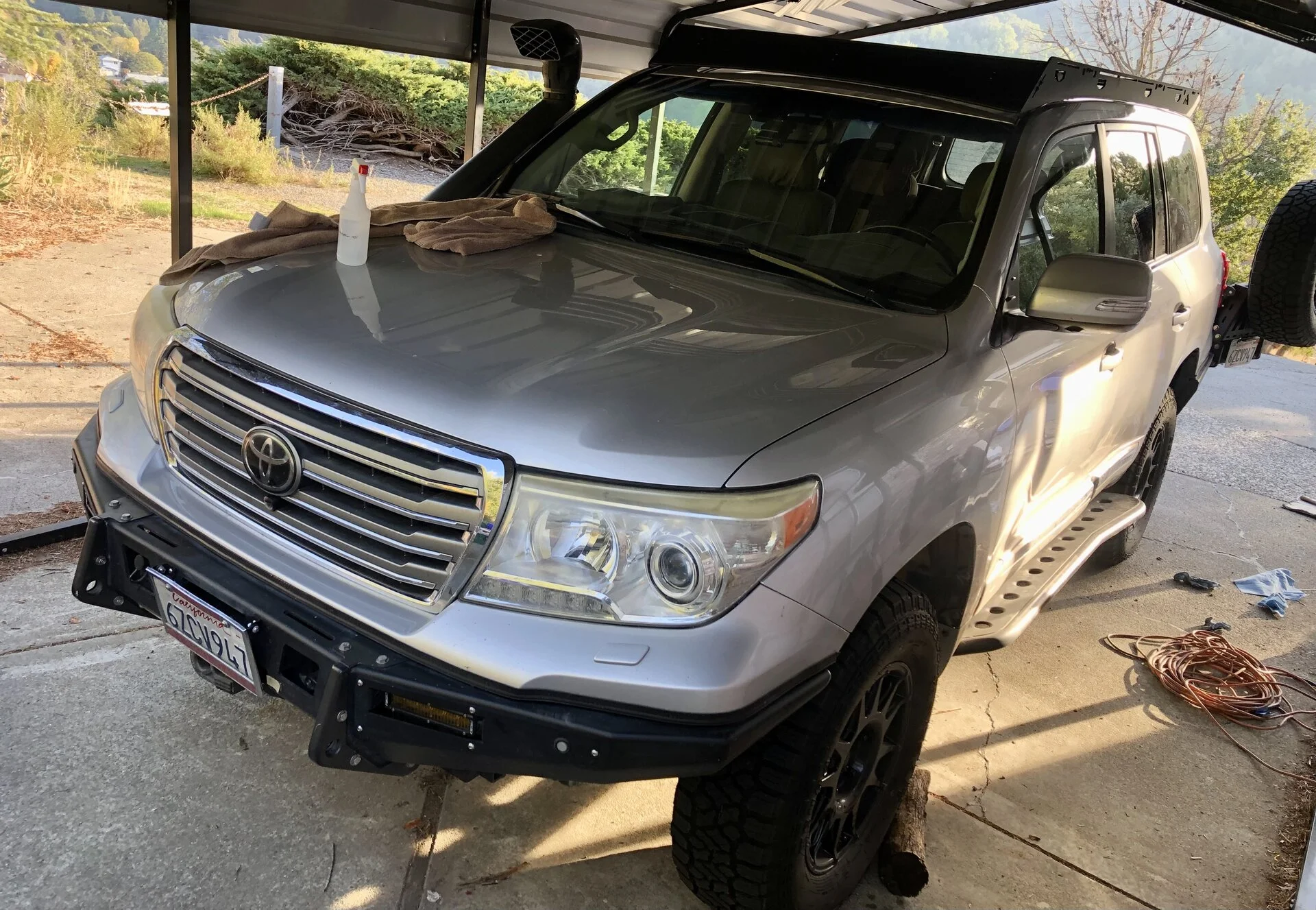

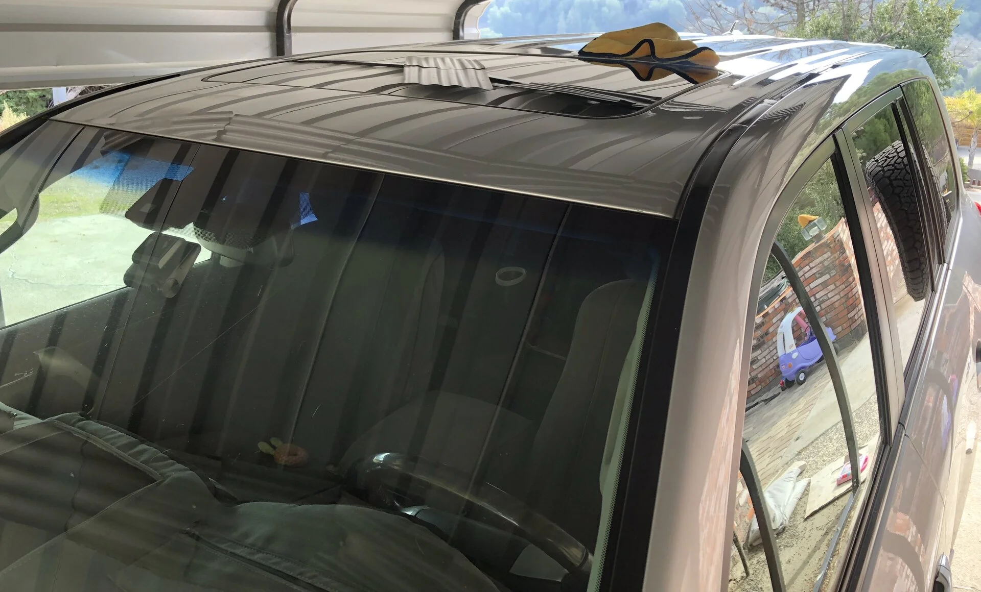

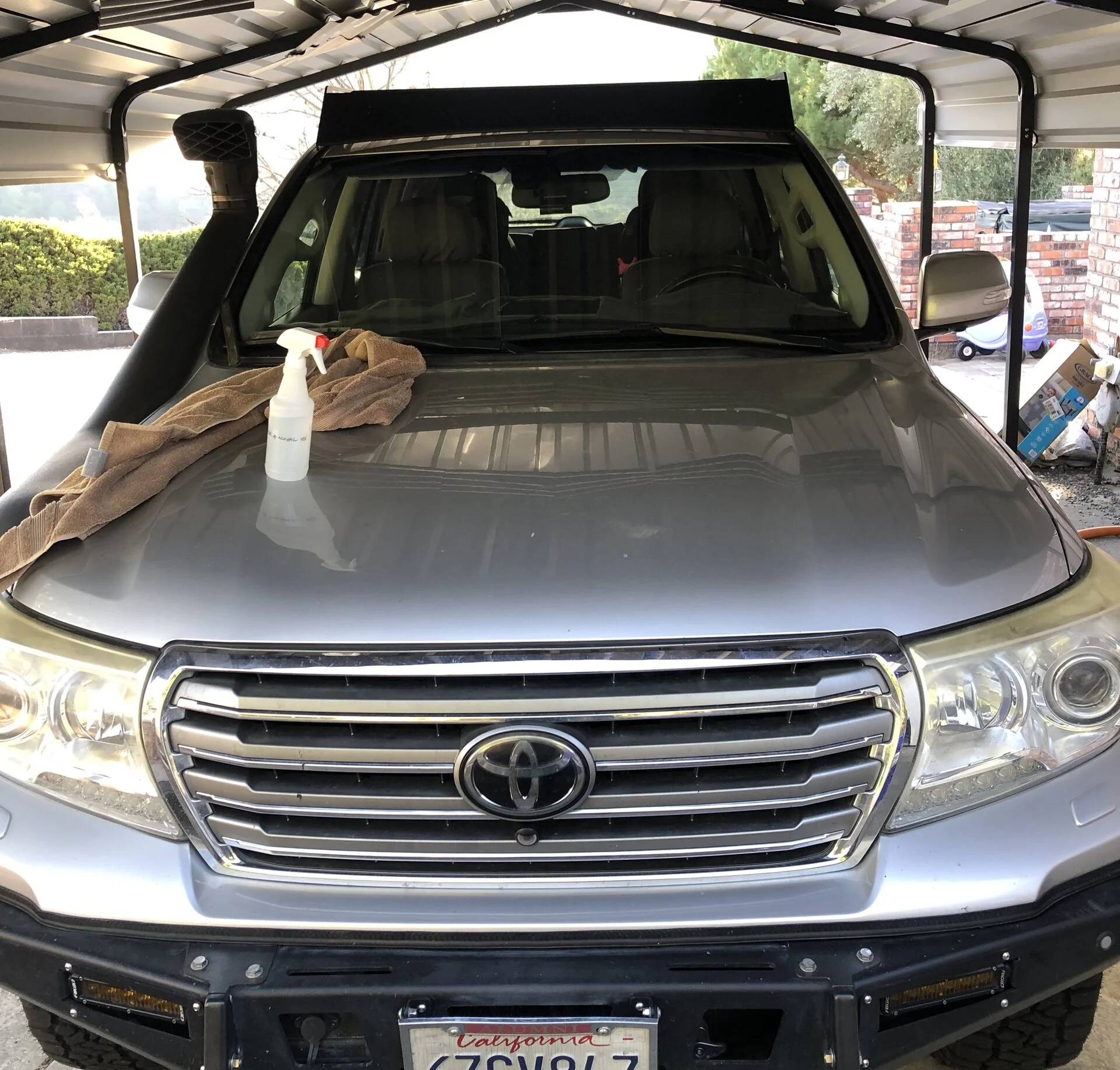

Ordered the rack and some of their accessories directly from Sherpa last week and was pleasantly surprised to see the package arrive in just a few days. I have been accustomed to lead times of weeks if not months for Land Cruiser goodies so early Christmas here.
Straightforward install process following their instructions and videos. They don’t currently have a video specific to the 200 so I watched their YouTube channel vids of the 100 series and lx470 which were helpful.
With the the factory rack off it was a good time and the only time I have been able to fully wash and wax the roof.

The wind fairing looked big in their pics but on your rig looks great.
I always wanted to see the half fairing they have for light bar but haven’t seen one on a LC200

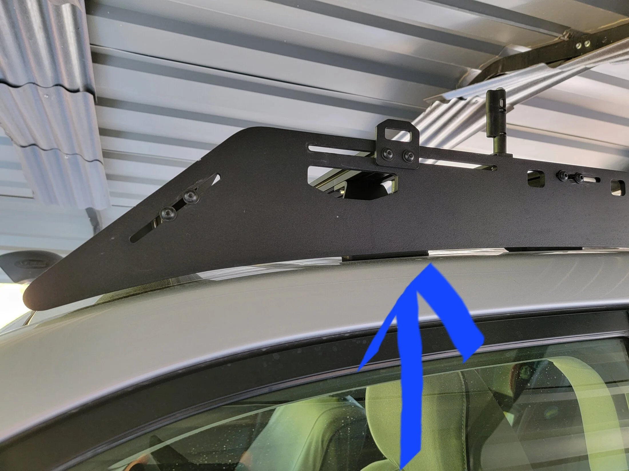

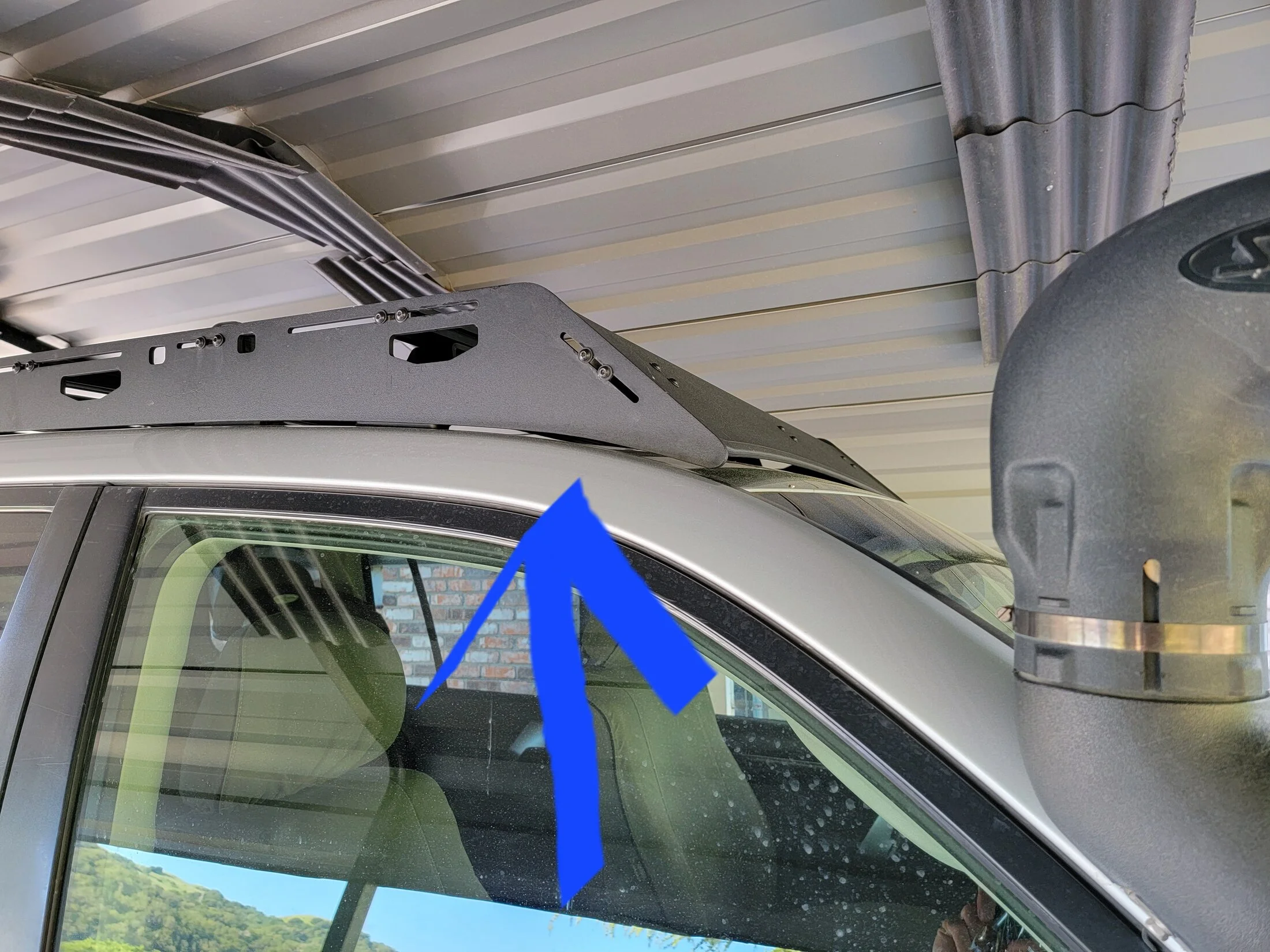

My only suggestions:
1. You'll really need to play with the forward/back location of the side rails, then the up/down of the front fairing to have it almost touching the roof. Otherwise there will be vibration. (Once you get it right, it will be great!)
2. You'll want the bulk majority of the weight (rooftop tent, etc...) from the front mounting point and back. The front part (towards the fairing) isn't as supported.

@mceagle555 is spot on with his assessment of the rack. Ive had mine for a couple years now. No leaks, i really like their mounting design and flexibility of being able to move the cross bars forward and aft.
I also wasn't happy with the amount of downward movement the rack experienced (with a heavy load) at the front of the side rails by the fairing. I contacted them about this and we discussed options. What I ended up doing was adding two of their adjustable mounting feet at the forward end of the rack and it solved these issues. I can now hang off the front of rack with zero movement.
