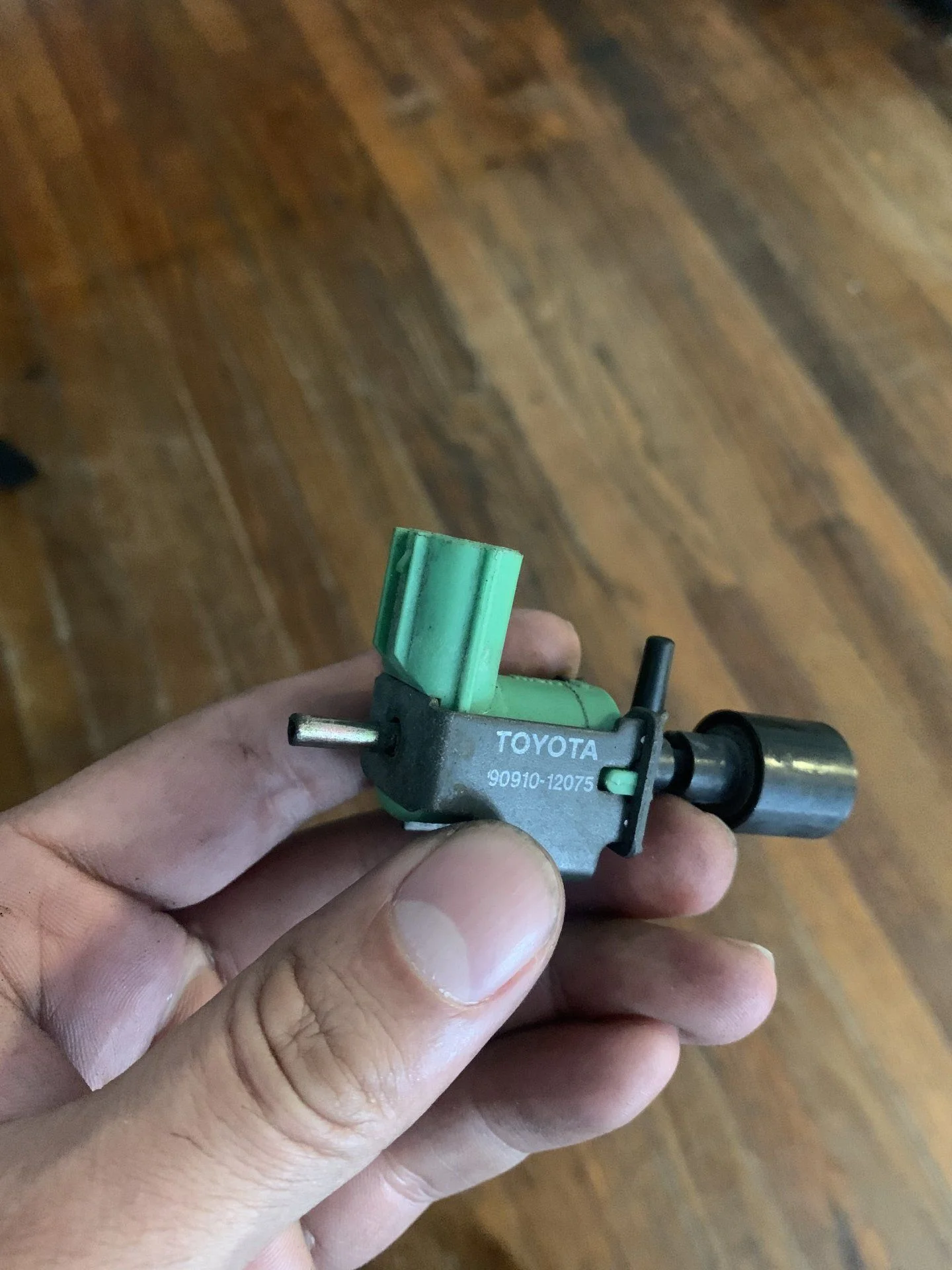

I just took out the three VSV valves on the passenger side including the AC idle up. I tested them with a multimeter and a battery (followed this procedure). It appears the EGR VSV (in the picture) is not working. I cant blow air in or out, and when connected to a battery it didn't open or close. Ordered a used one from ebay and hope this makes the engine run better. I wonder if the old EGR modulator was hiding the malfunctioning of this VSV?
Did you find that replacing the VSV solved your issue? I've been troubleshooting the same problem and also just got to the VSV not passing air through.
