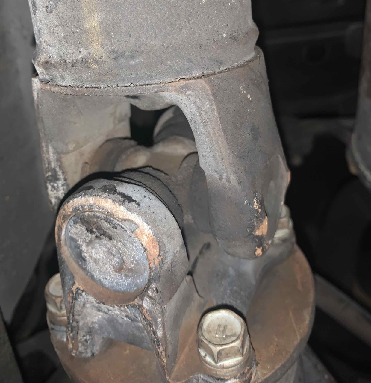

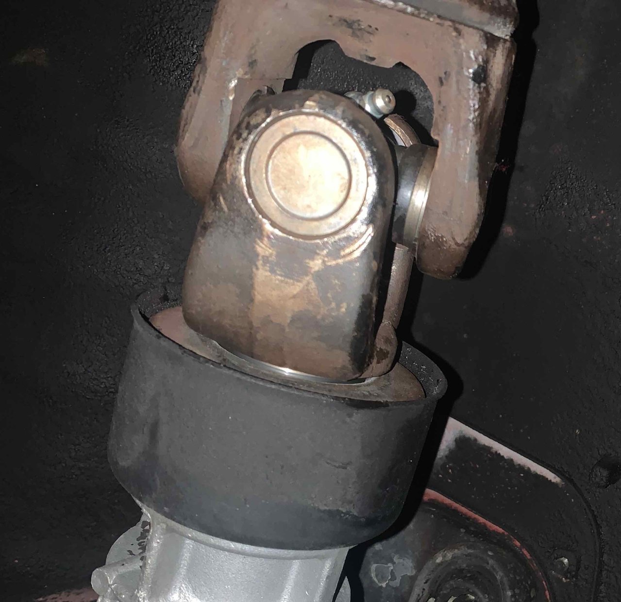

So I changed the oil, coolant, radiator hoses, and thermostat. This weekend I want to change my transmission and rear differential fluids and grease the driveshaft. Regarding the drive shaft, there seems to be only one place that needs to lubricated which is nearest to the transmission
pic1-jpg.53089
because the other end that attaches to the rear differential does not have any fittings.
pic2-jpg.53090
What grease should I use? What weight of differential fluid do y'all recommend? Thanks again.
