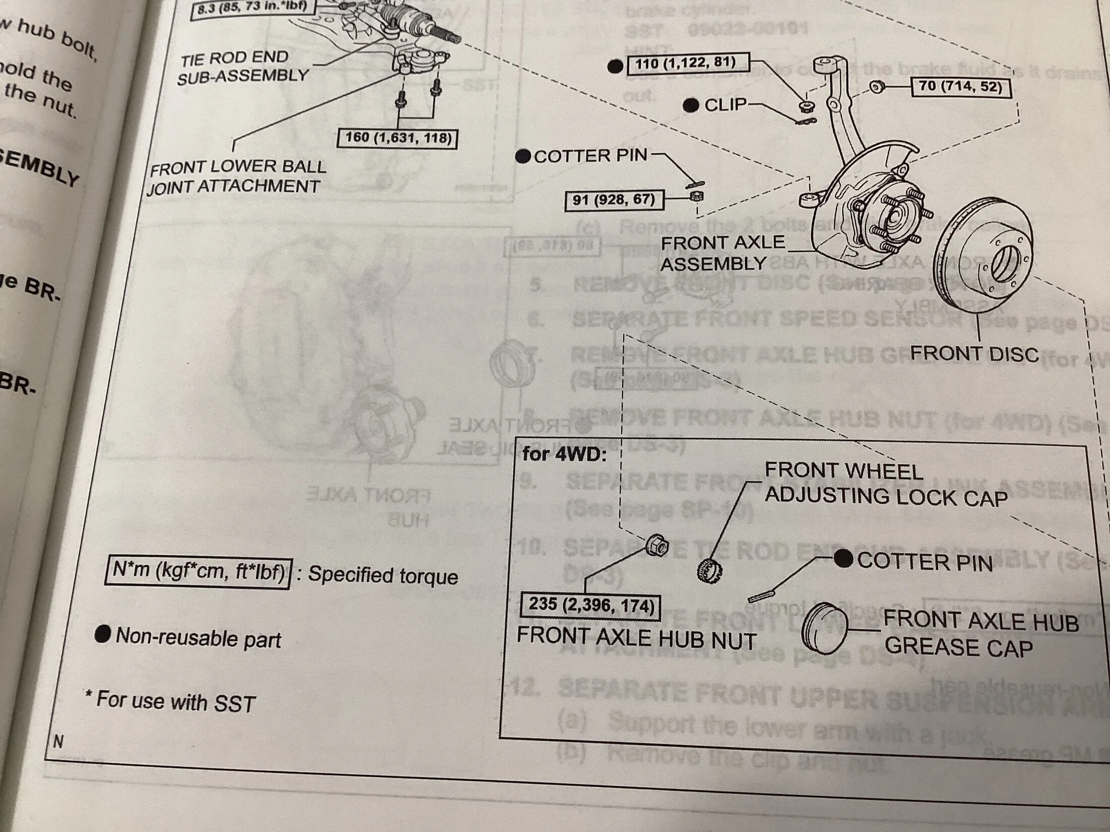

First, don’t be offended that I’m referencing a FJ Cruiser repair manual. There are many similarities. I agree with you that it should have a hole for a cotter pin. At this point, maybe the simplest solution would be an appropriate size nylok nut.

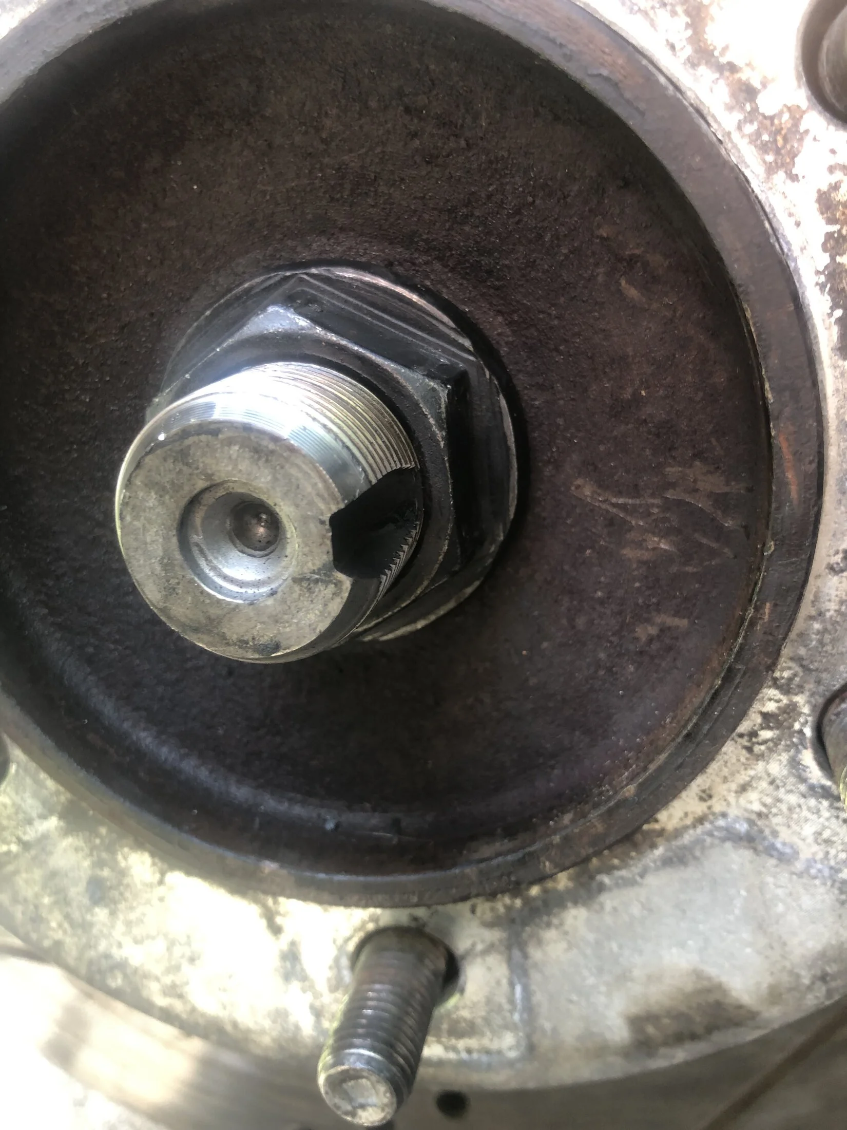

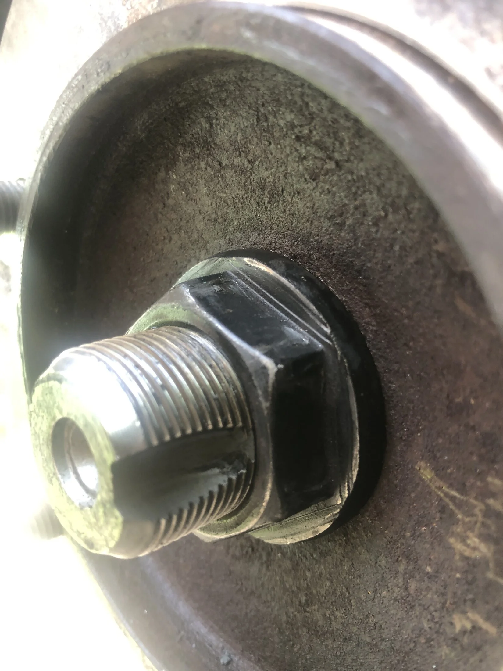

I'm in the same boat as OP. If I order the correct nut, what keeps it locked in the groove? Am I supposed to hammer down one edge into the groove? If so, how do I remove the nut since I will be deforming a portion of the thread?
After you torque the nut down, you stake the end of the nut into the groove of the axle. A simple punch and a couple taps with a hammer deform it into the groove. Enough force with a breaker bar or impact will reverse the nut if you are in need of removing the axle again. However, it's recommended that these nuts are one time use only. So if you have to take it off again for whatever reason, you replace it.
I've usually hammered them in with a few hammer strikes on the butt of a flathead screwdriver. I then pry up the hammered-in section with a screwdriver prior to removing the nut.
