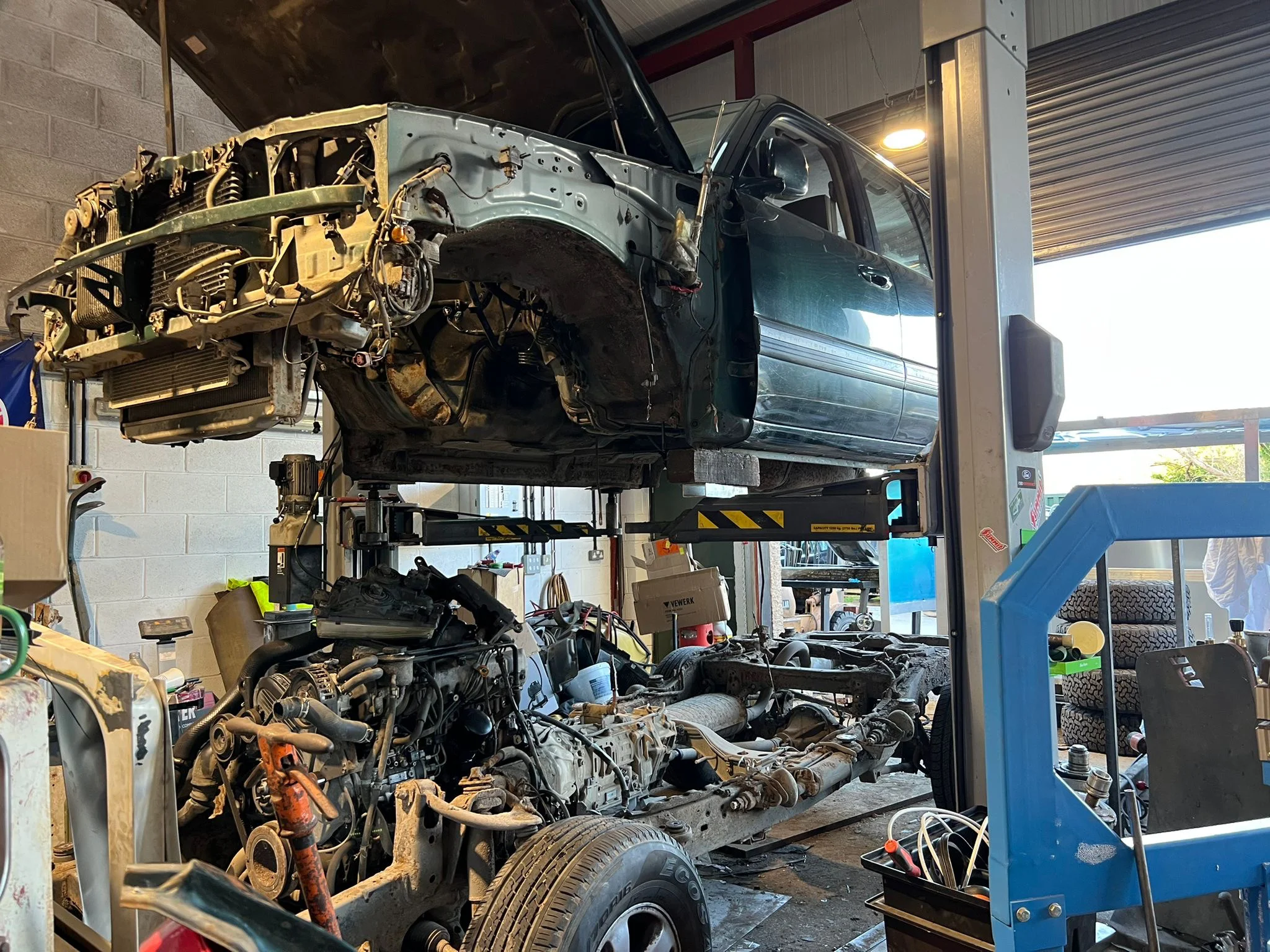

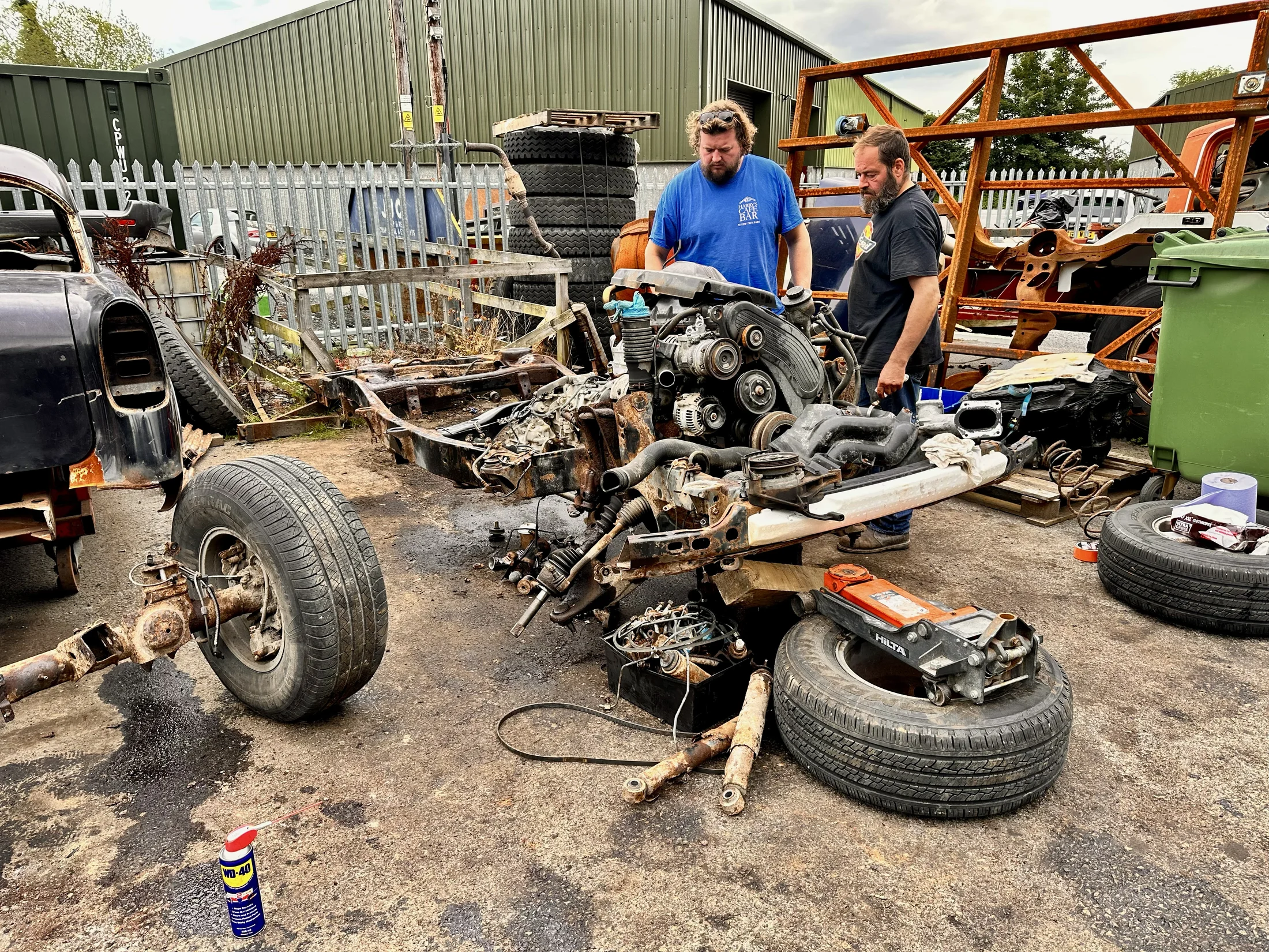

wanted to add this image to a post about my 100 project over the past 2 years. I've completely rebuilt her ... body off. She is finally MOTd. now the problems have started. think I should have joined this forum two years ago.

wow. thats deep into it! what was the main reason for the work, just reviving a tired rig?
she was a very uncared for one owner car, that I've know since she was purchased. she was used as a dog kennel any the end. so I finally prised her away from her former owner and set about bringing her back to life. she was in a real state. rust and neglect.
