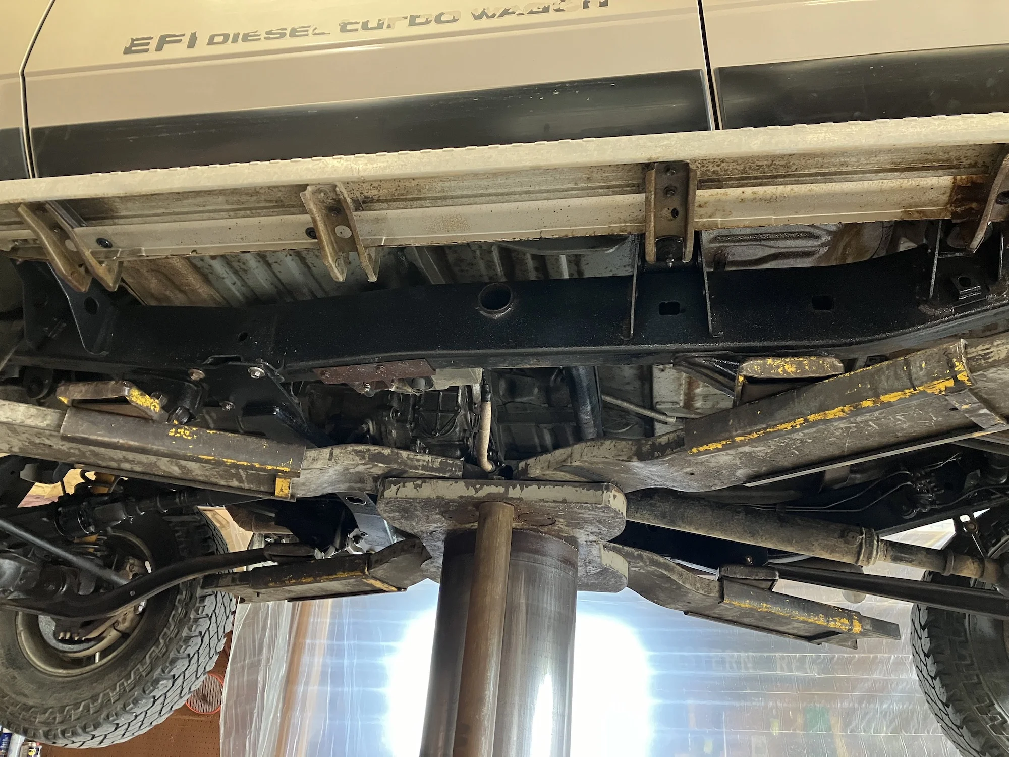

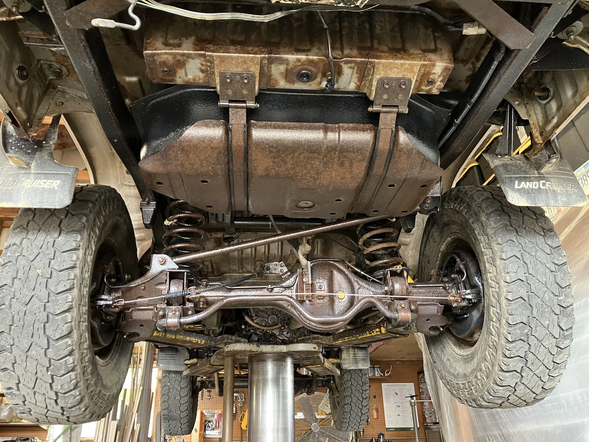

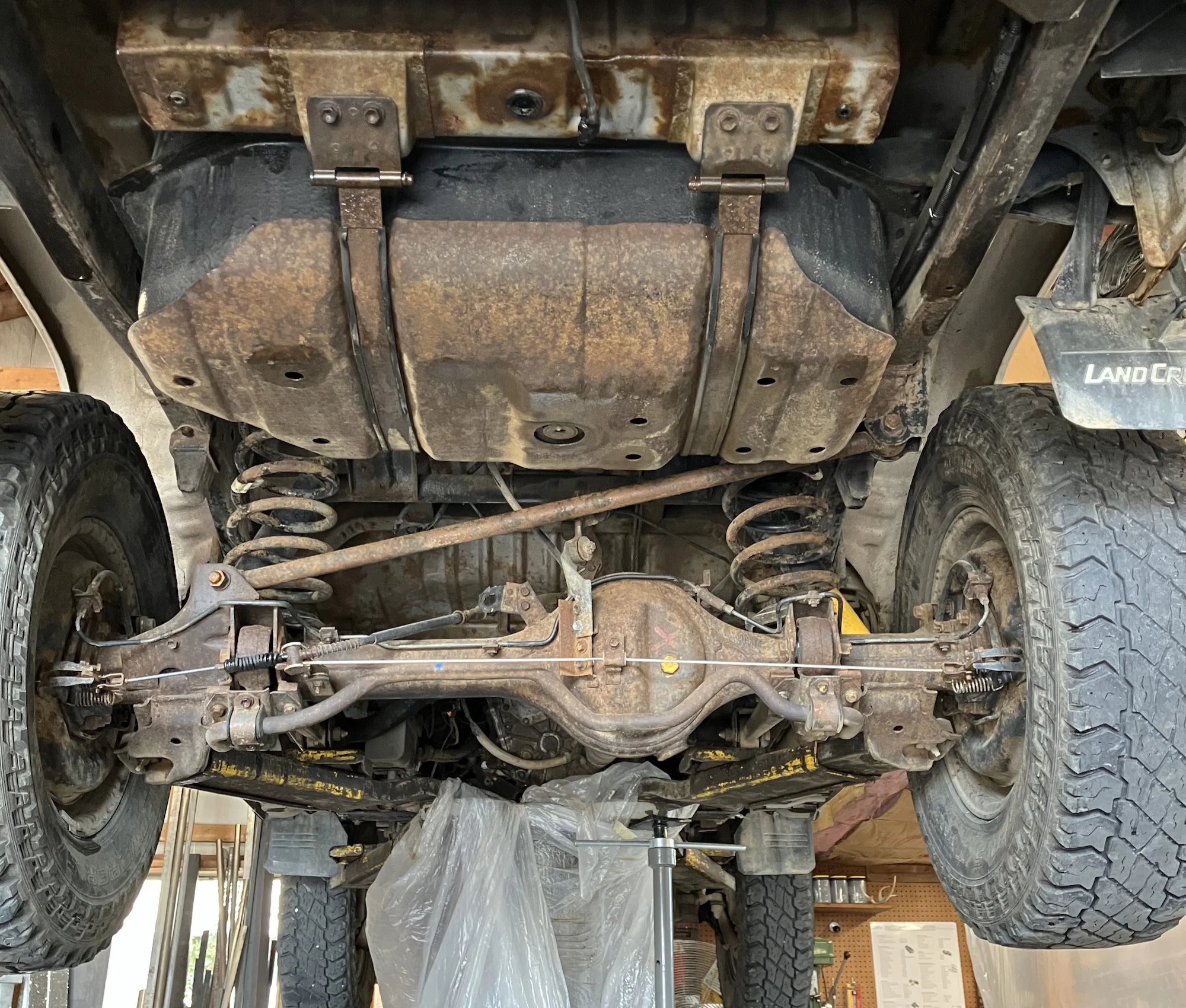

I'm a big fan of WoolWax, been using it every fall on the underside of the Prado to help keep the tinworm at bay. I start with a thorough pressure washing, using a stiff brush on any dirt that is really stuck on, then a heavy coat of WoolWax. It is a bit thicker than Fluid Film and doesn't really smell. Holds up pretty well over the winter, though I am careful to just hose off the undercarriage afterwards rather than pressure washing it.
Before:
After:

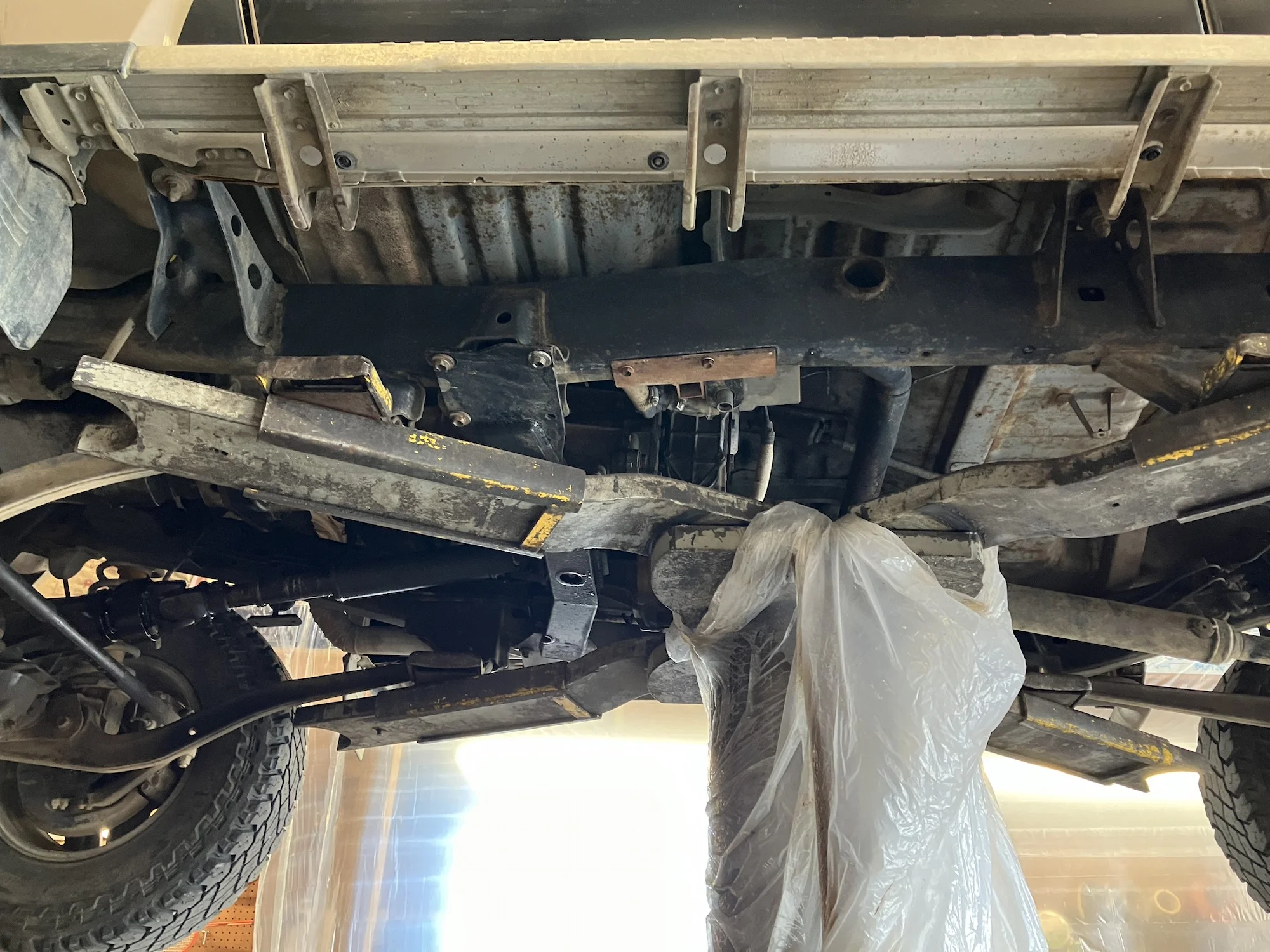

Before:
After:
A lift sure makes things nice!
