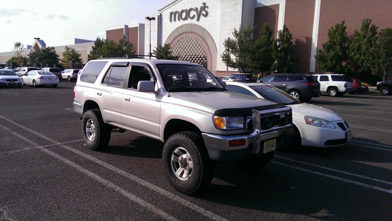

When I got the truck.

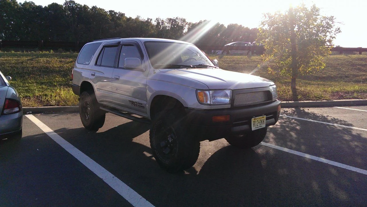

Truck now, ( also waiting on my burtman carbon fiber door pillar cover. )
