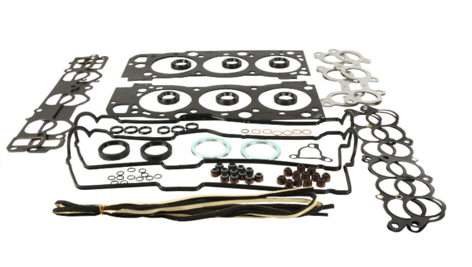

I"ve been shopping for HG kit and noticed that MLS gaskets are being sold through few vendors. Is MLS gasket suggested over the OEM gasket? Perhaps the OEM gaskets are also of the MLS variety due to an update?
I have used OEM and never had any issues plus all the stuff you need is in the kit, I don't see any real advantage with MLS gasket but I would use new head bolts. If the heads are not warped have the machinist shaved the head to give it a fresh surface and get rid of any pitting. Get a new Knock sensor and harness while it's out.

I would skip the MLS gaskets unless you can guarantee that the block and heads will be the proper RA that is specified for them.
