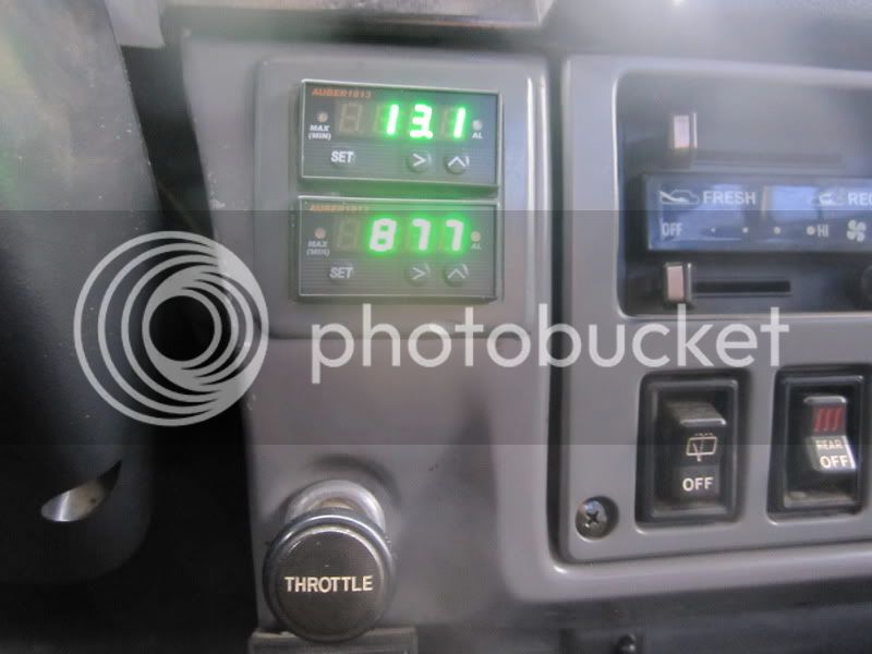

Today I disconnected and wired shut the wastegate. It was set at 4psi, and with it disconnected I saw 16 psi at about 900 F preturbo. I imagine I could make it hit 20 psi if I really gunned it. I am thinking I want to modify my wastegate or get another on there. Is there a general consensus on a safe maximum boost, or is EGT the concern more than maximum boost pressure?
Figure out what you want for max. boost and set the WG accordingly, then add or reduce fuel untill you get the EGT's to your Max level. The levels are debatable, all depends on what you feel is safe.
I feel 10-12 PSI will make for a safe happy little "B"
1200 deg. pre turbo is fairly agreed upon as EGT upper limit.
I run 12psi and with the intercooler I never see more then 1100 on the pyro no matter what. I could add more fuel safely but dont see the need. My big, tall, heavy truck can boogie up the Malahat at 90kph no worries and thats good enough for me.
