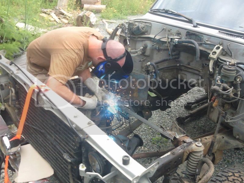

Today I installed the engine mounts in the fj60. I had a friend help me weld them in as my beads are still a bit lacking. I drilled index marks in both mounts before cutting them out of the bj60 and then made a jig using some angle and the gas mounts I cut out of the FJ. I think I got the mounts within a mm or two of the proper location. I used por15 on the frame after the mounts were in.

Welding in the mounts. You can see the jig here.
Drivers side mount
Passenger Side mount

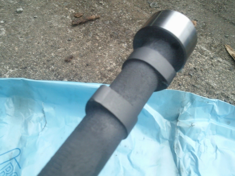

Had the cam and lifters redone at Shadbolt in Vancouver

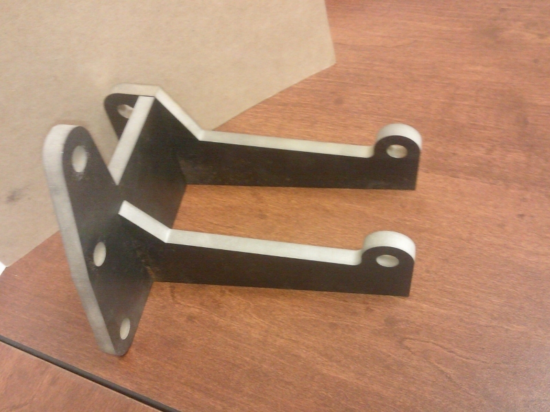

Got an ac bracket cut and welded it together(Thanks Brian for the welding). Used the CAD file that's floating around and modified it as recommended on ih8mud. I would not recommend messing with the file, the bracket ended up 5 mm too wide so I just ground down the compressor mount and put a nut on back...

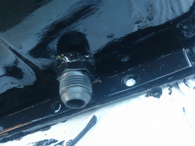

Put some paint on a few rusty pieces, and got the oilpan prepped for a turbo:

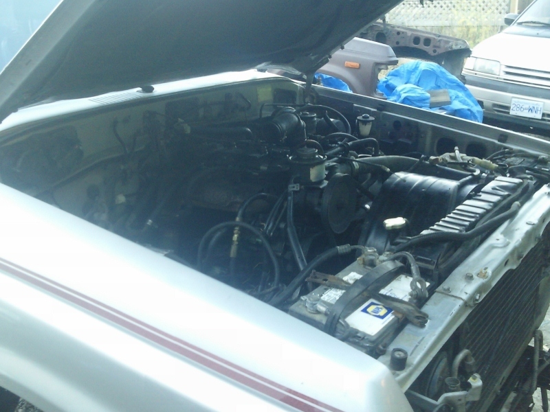

Installed it all
