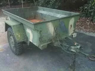

This is how it looked when I first bought it... It was for sale on the side of the road heading over the hill to Palm Springs... the guy wanted $600 for it.. I bought it on the spot.

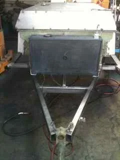

I really liked a lot of what I have seen on these forum's, so I pretty much used others ideas... Here are the fender extentions, I did cut in the tail lights.. don't think I've seen that one?? I extended the front end and extra couple of feet. Added the 19 gallon water tank from AT trailers, got a nose box (black) from jeggs..

Do you have an underside view of how you extended the A frame?
actually did not take one of the underside.. the rails go back about mid way into the frame.. it's for sure not going anywhere!! I'll take one and post it so you can see...
