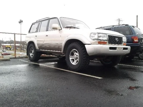

new LX450
so still looking for the comparo shot but i may just have to go retake it.....
but here is a good spread of different lifts and tires
white= heavy heavy and 33's
gray= 4'' front and J rear and 37s
black= J front and Medium rear and 35's
I am running OME heavy/heavy on mine with a 1" body kift running on 35"s. I pretty much junked my factory transmission mount at URE playing around, so i installed a IPOR skid plate. I would suggest you
go with a j-lift or a 4", get the caster plates (landtank) don't even bother with the yellow or blue bushings. The body lift will give you some more airflow and clearence in the wheel wells. J-springs and a 2" body lift will allow you to run 37" tires this will keep your COG lower. your axles height above the ground is directly related to your tire size. the lift kit just raises your bumpers and mid section higher. I have to admit i drag my rear bumper/hitch now an then, but the k-mar does hang down, but it seems to be taking it without fuss. everyone has different ideas. I really dont care so much as how it looks, i just want it to function. I have always tried to minimise the lift in favor of stability. Now if i was back in florida playing in the everglades i would tell you to go high or go home, I have been through some holes in a full size dodge with 40" running 12" lift and water was half way up the windows.
