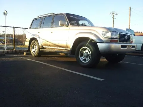

So I have a before pic.
I'm about to remove some of the useless metal
