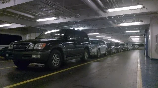

Road trip to British Columbia. Picture on Vancouver Island and the Victoria ferry. About a thousand mile drive, other than bankrupting me in gas it's been a great road trip vehicle.
