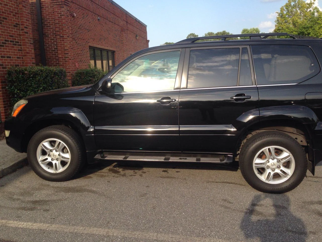

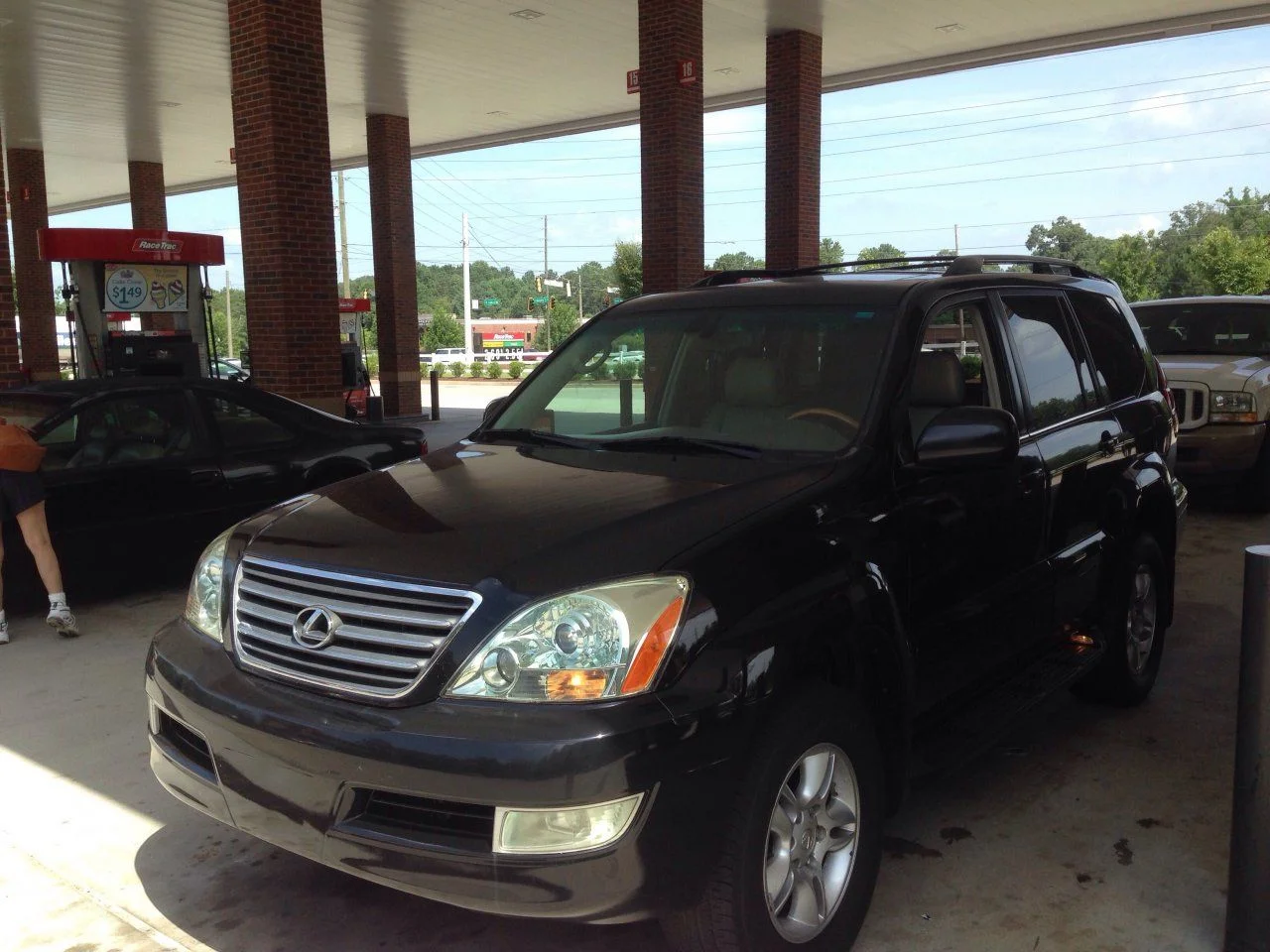

Just purchased a 2004 Lexus gx 470. So far I'm extremely excited to own such an awesome car. Drives great and has a great road presence. Has a few issues but nothing too difficult. So far the only thing I've noticed is the power mirrors seem stuck. They work but not well, the windows all work but don't go down from the drivers control panel. Also the rear Ac is blowing warm. The front Ac works great just the rear is warm. I understand it's an 11 year old car and it's going to need some work but for the most part it's a solid car.

Nice GX, BTW! Color me jealous :bounce:
