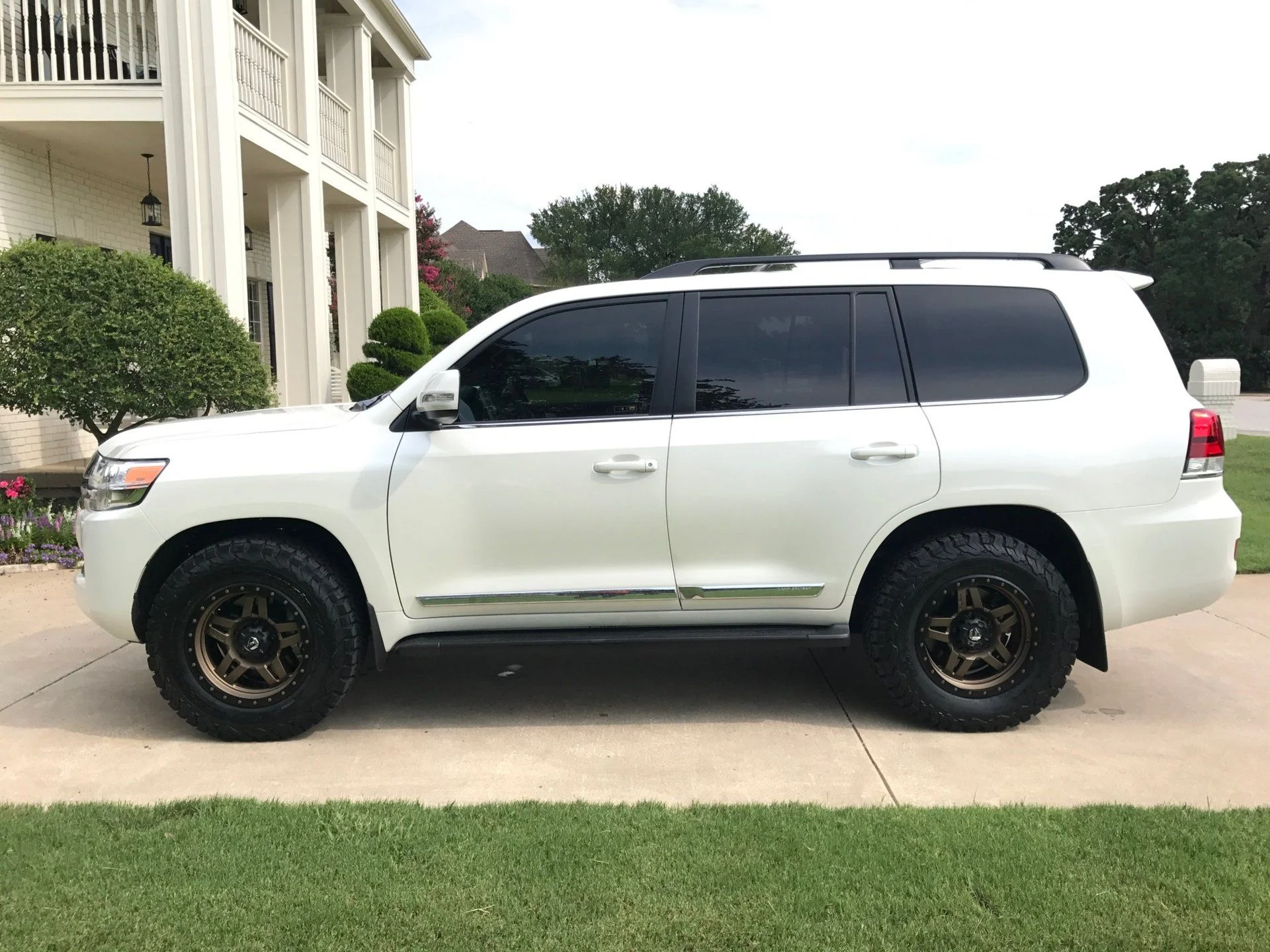

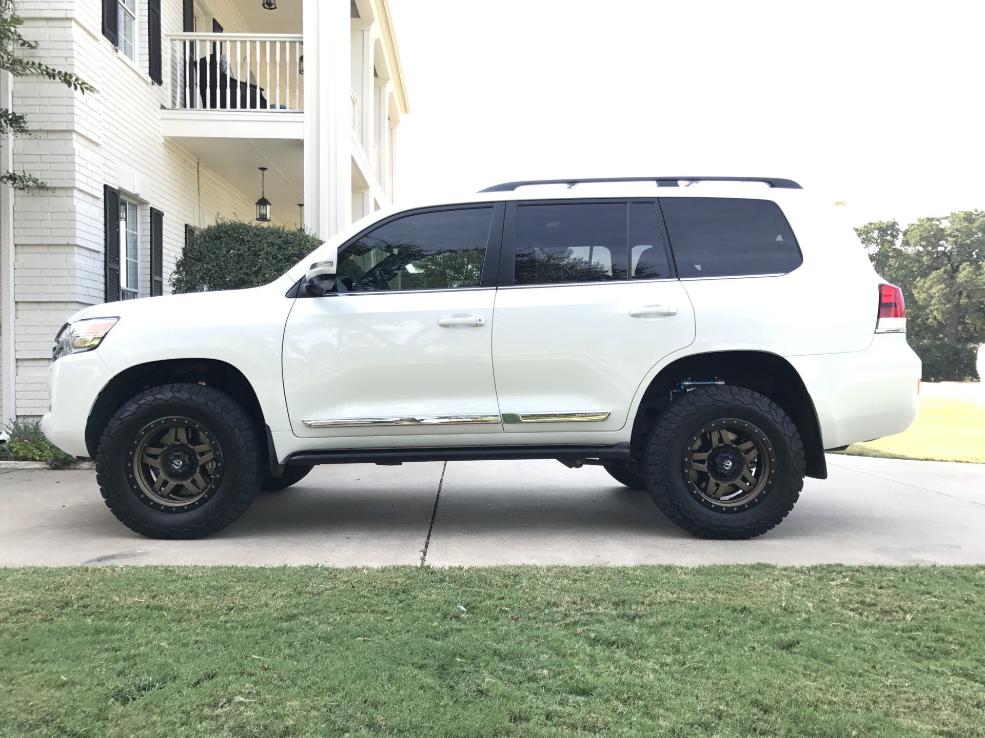

I cannot imagine any more rake than mine! You must post pics for proof ;)

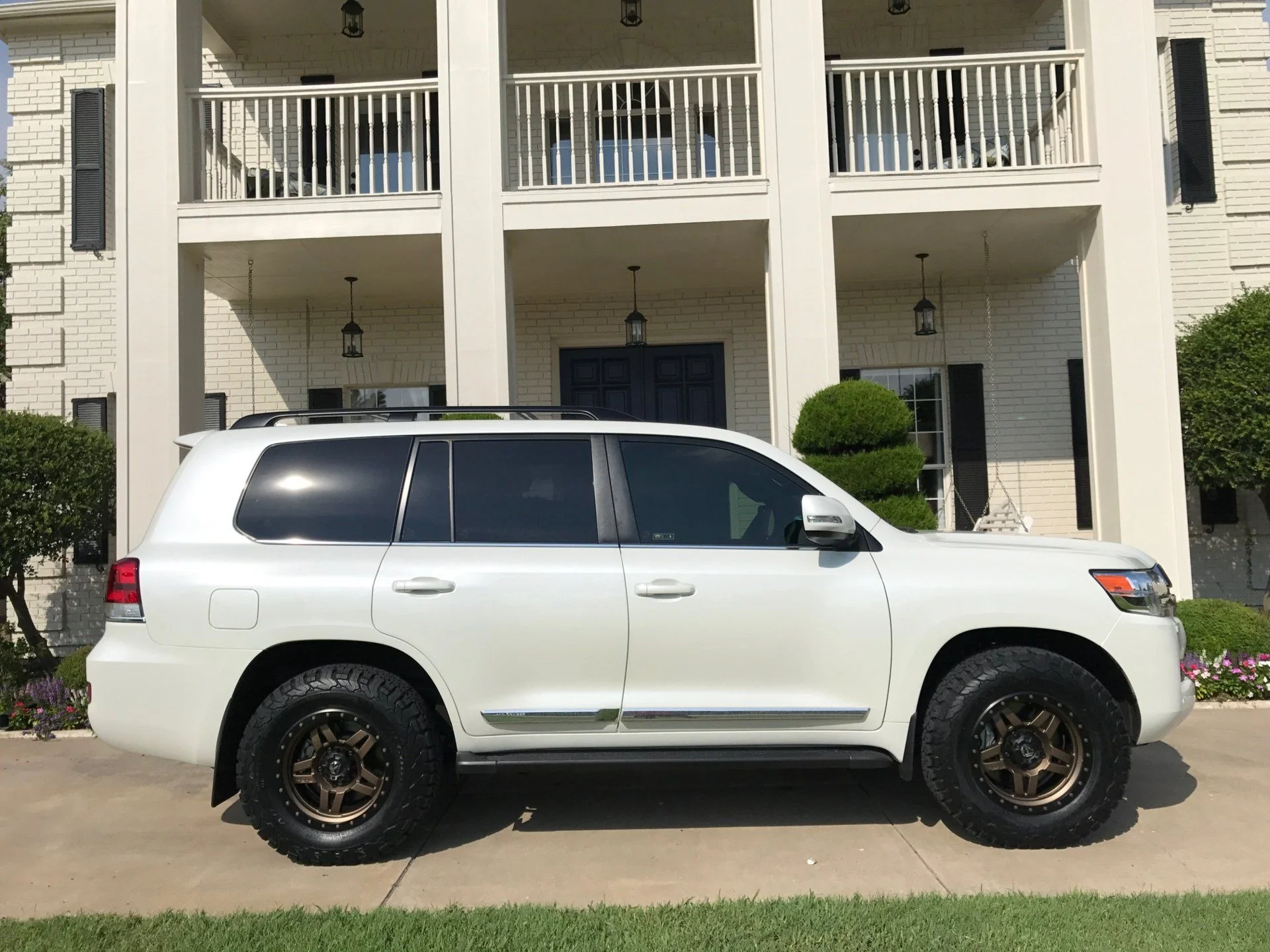

Honestly, I think the angle/perspective in the 2nd and 3rd photos make it look more raked than it probably is.
Maybe take another shot on a known-to-be-flat surface with a level background. Then drop to a knee with your camera and make sure your lens is level & centered front to rear. Perspective differences in photos really tweak there appearance angles and you can get huge visual deception with even minor perspective angles.

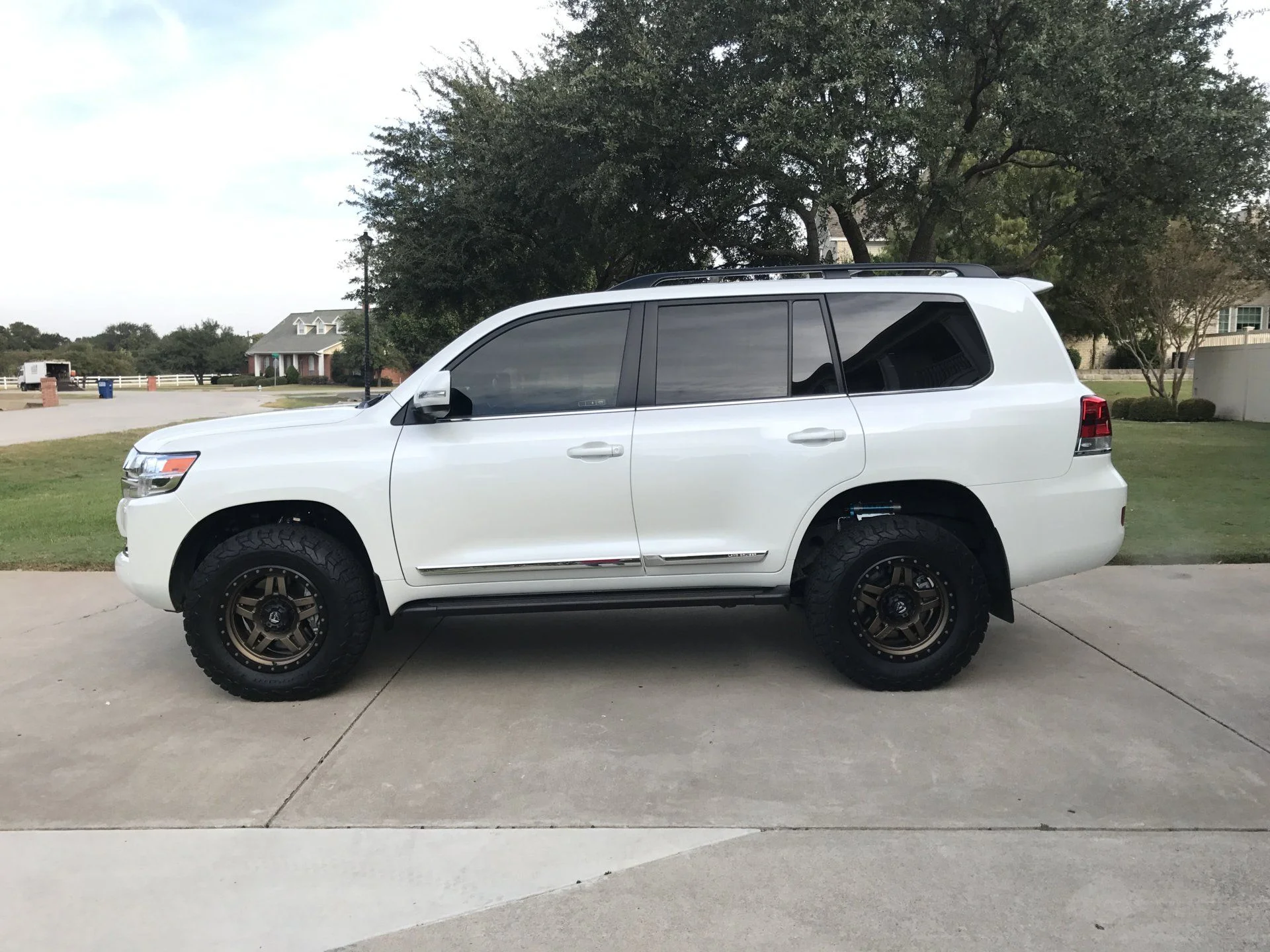

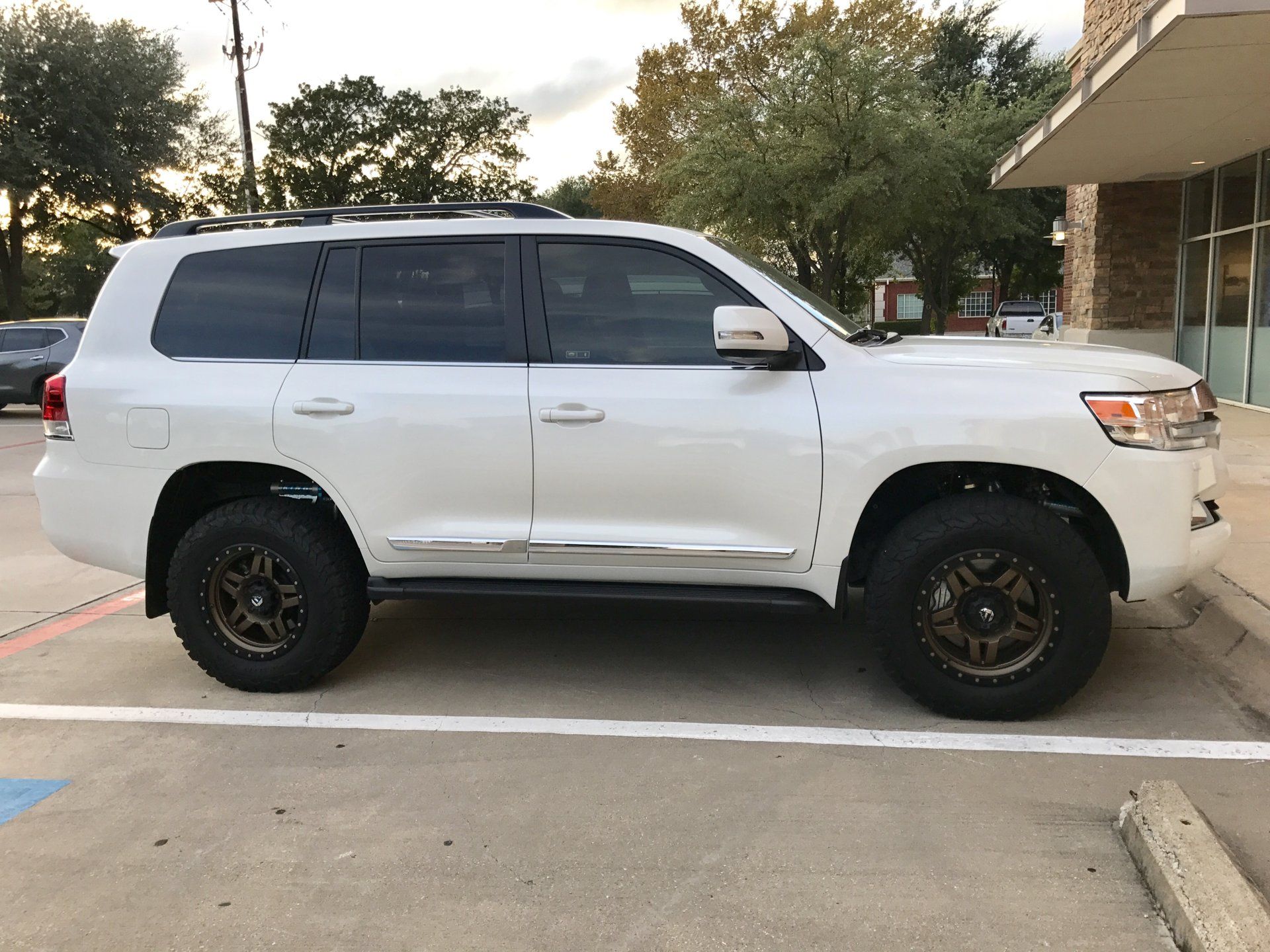

Here you go.
It certainly has a forward rake, but it doesn't look extreme at all to me.
1.5+" unloaded is pretty standard fare.
If you truly leveled it unloaded...then loaded the back with gear? You might not like the result.
After install it was 1.75" higher than the front. I'm thinking remove the 10mm spacer which is .4" will get closer to 1.5" rake.

Ok so the rear is settling down a bit so the rake isn't as extreme. Perhaps I will keep the rear setup after all!

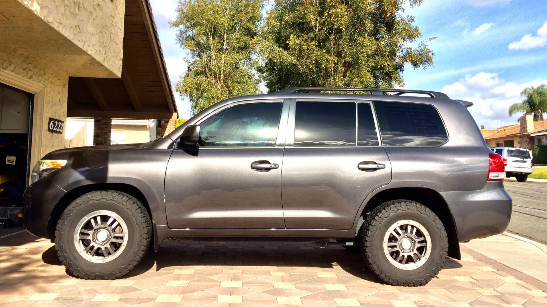

Just for a bit of factory perspective on forward rake... Here is a shot of my 200 when all I had done was add Rock Warrior wheels and KO2s.
Suspension was stock at that point.
Check out the factory rake...look at the difference in space above the tires, front to back. There is very real forward rake from the factory:
Looks level to me
Maybe level to the horizon, but I'm in my driveway. Look at the wheel wells...which are level to each other (aside from wheels/tires). The front is far more squatted...but that's factory normal.
It's no where near level. But then I agree that it never was. Here are some of my factory with just wheels shots.
