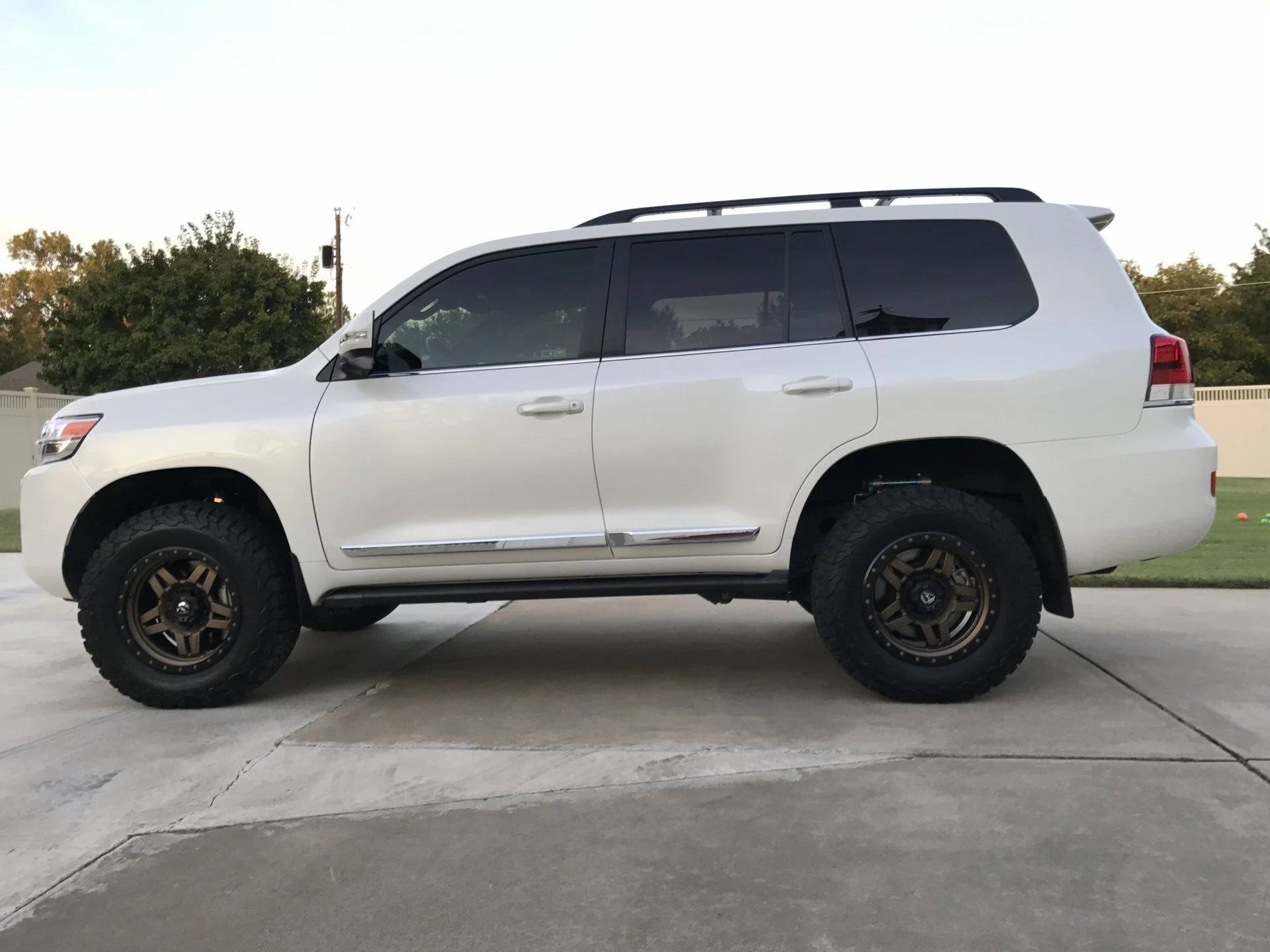

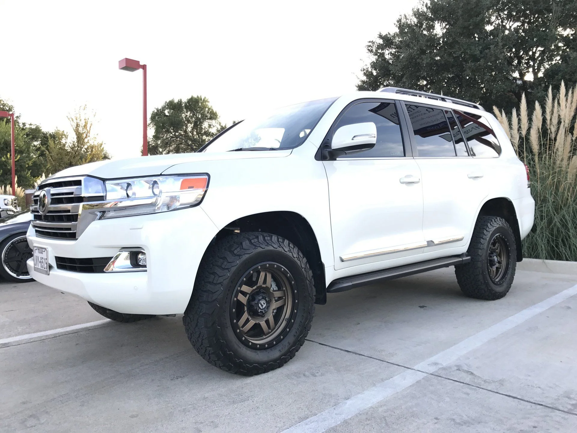

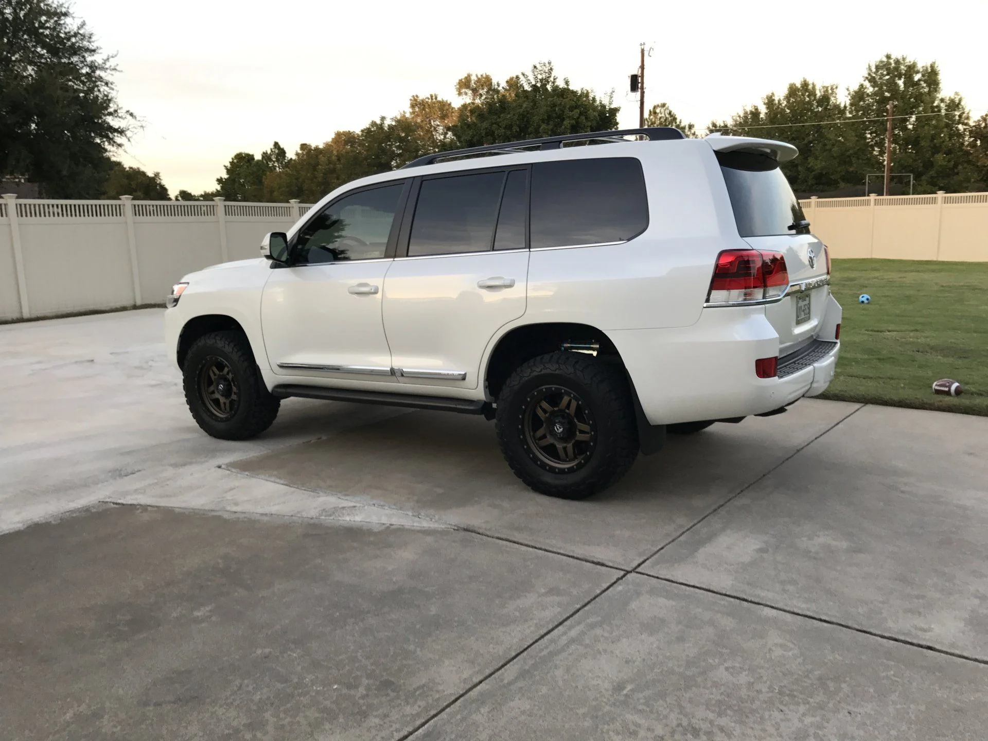

Here they are installed. They were preset at 2". You can barely tell a lift in the pics. Plus they will settle. But you can def notice the lift getting in and out.
May add another inch then let them settle back down to a solid 2.5 - 2.75.
May need to do something with the rear to take it up an inch or so to match.
Rides and handles great. I notice the improvement most on really bad roads.
My 16 is blizzard pearl too :)
Those rims and tires look great but you are right I can hardly see the lift in the photo. Which rims and tires did you go with?
Wheels are Fuels. Tires are BFG K02's.

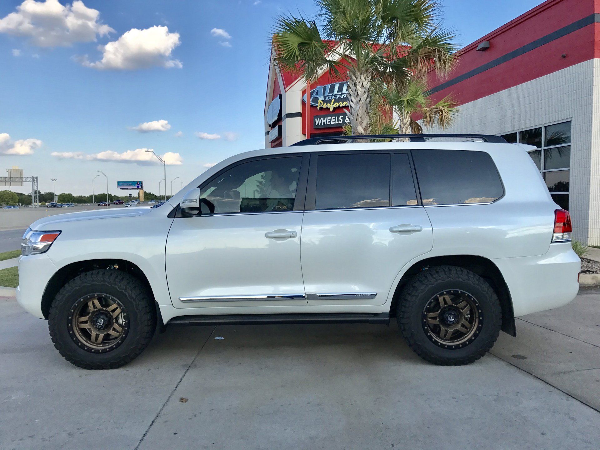

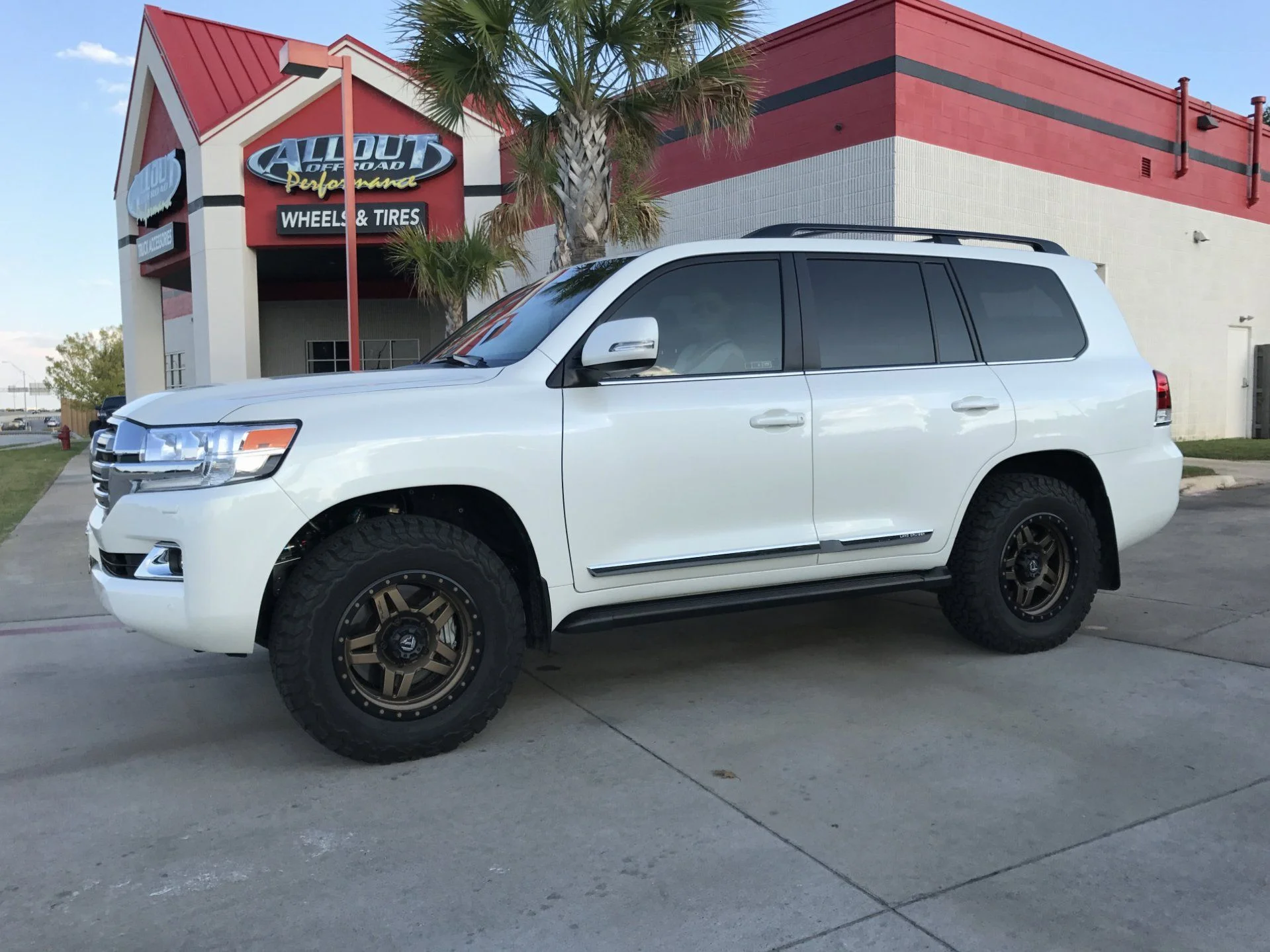

Ok. Cranked the front coil-over up an inch. Then added rear OME light load spring and also a 10mm spacer.
Front looks great. The rear seems way too high.
There was 0 rake before with stock rear
springs and the front coil-overs set at 2" of lift. I just measured and it's 1.75" higher out back than up front. Since it was basically level before I was thinking since I'm going up 1 inch front that the OME rear spring at .75" plus 10mm spacer puts the rear only 1.25" higher than it was which is only .25 higher than the front.
Yet we are are off by 1.5"+. Makes me wonder if OME springs are underrated in their lift... think I may need to either go back to stock spring with the 10mm spacer. Or just pull the spacer - but I wonder if it still will be too high.

OME rear springs are definitely underrated on amount of lift. All three sets of various OME springs gave more lift than advertised (2721, 2722 and 2724). My theory is it's related to lift limit laws in Australia...and they fudge downward on the published specs...but I don't know.
On the other hand, a little forward rake in a 200 is normal, even from the factory. Load up the back, and you might be close to level. If not, no biggie. You don't want your front cranked up so high that you lose available down-travel off road.

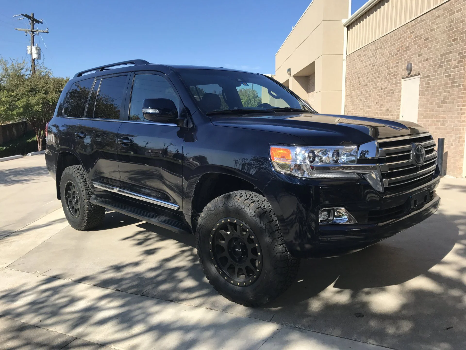

You don't think the rake is extreme? The blue one above isn't this much...

I noticed Texas plates. Where are you located and what shop did you use for install? I googled the Allout Off-road and saw that they may be in the Ft. Worth area. Thanks!
Depends what you want your truck to do. I have more rack than you and love it. But my truck has one purposed, take a family and a bunch of gear wheeling for weeks at a time. So I need the factory 3” rack to keep my back end up when loaded, or I’ll just scrap off-road all day.
The only thing I would recommend is keeping at least an inch of nose down rake to let your brakes work properly. The automatic proportioning valve in our truck is very good, but it will never know your truck is leveled (front and rear) or bulldog’d (front higher than rear) is because of the user and not a ton of weight in the back.

Allout Off-Road IS who did install/sorting. They have taken good care of me thus far. Just wish I knew OME underrated its spring's height.
I cannot imagine any more rake than mine! You must post pics for proof ;-)
