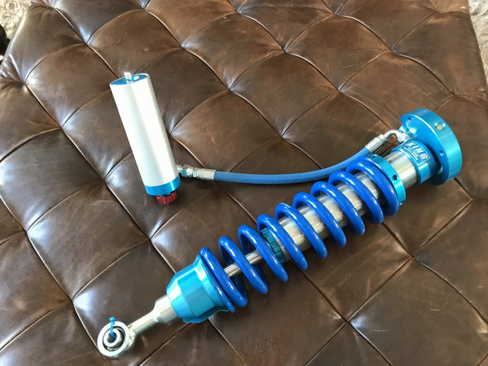

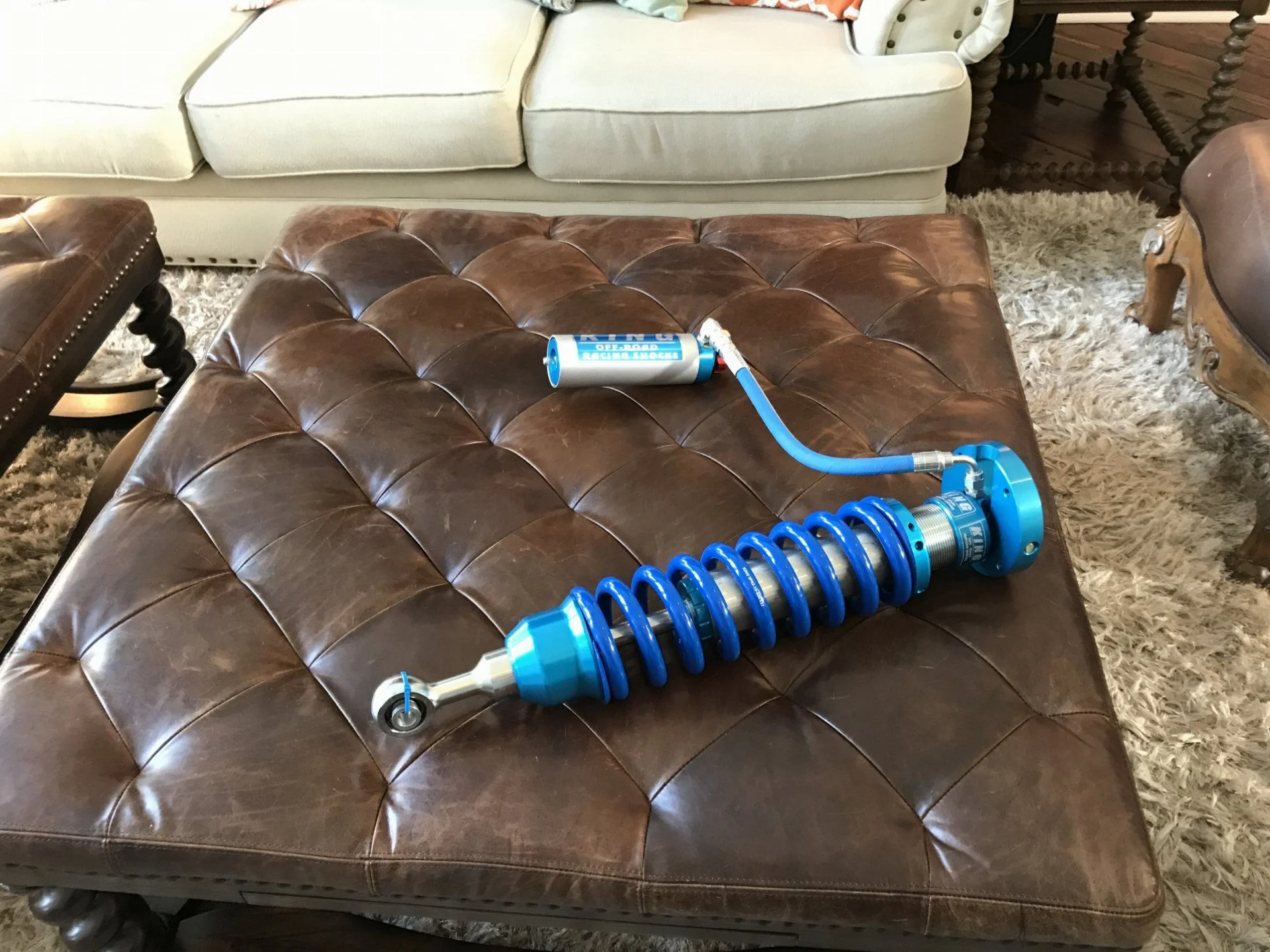

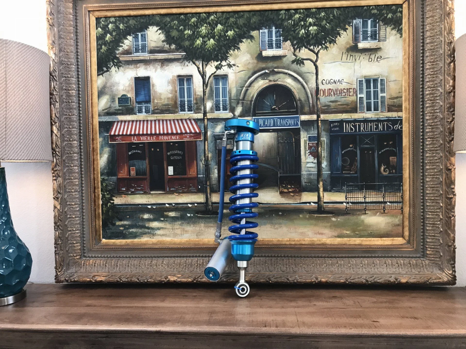

They're here! They look so cool I decided they dress up the foyer better than the painting ;) I also noticed they are slightly oversized!

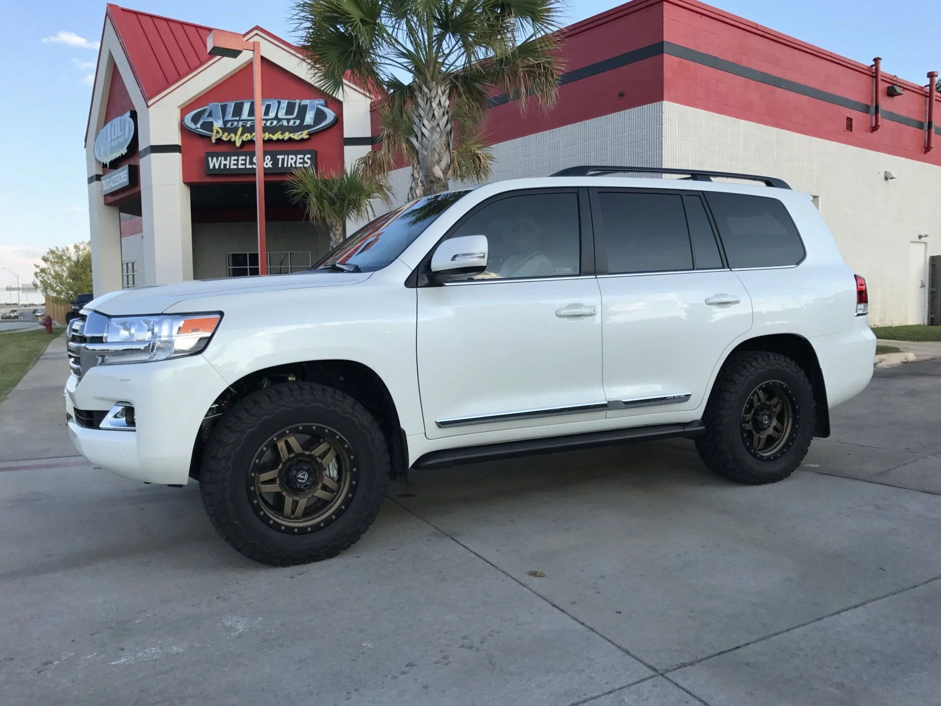

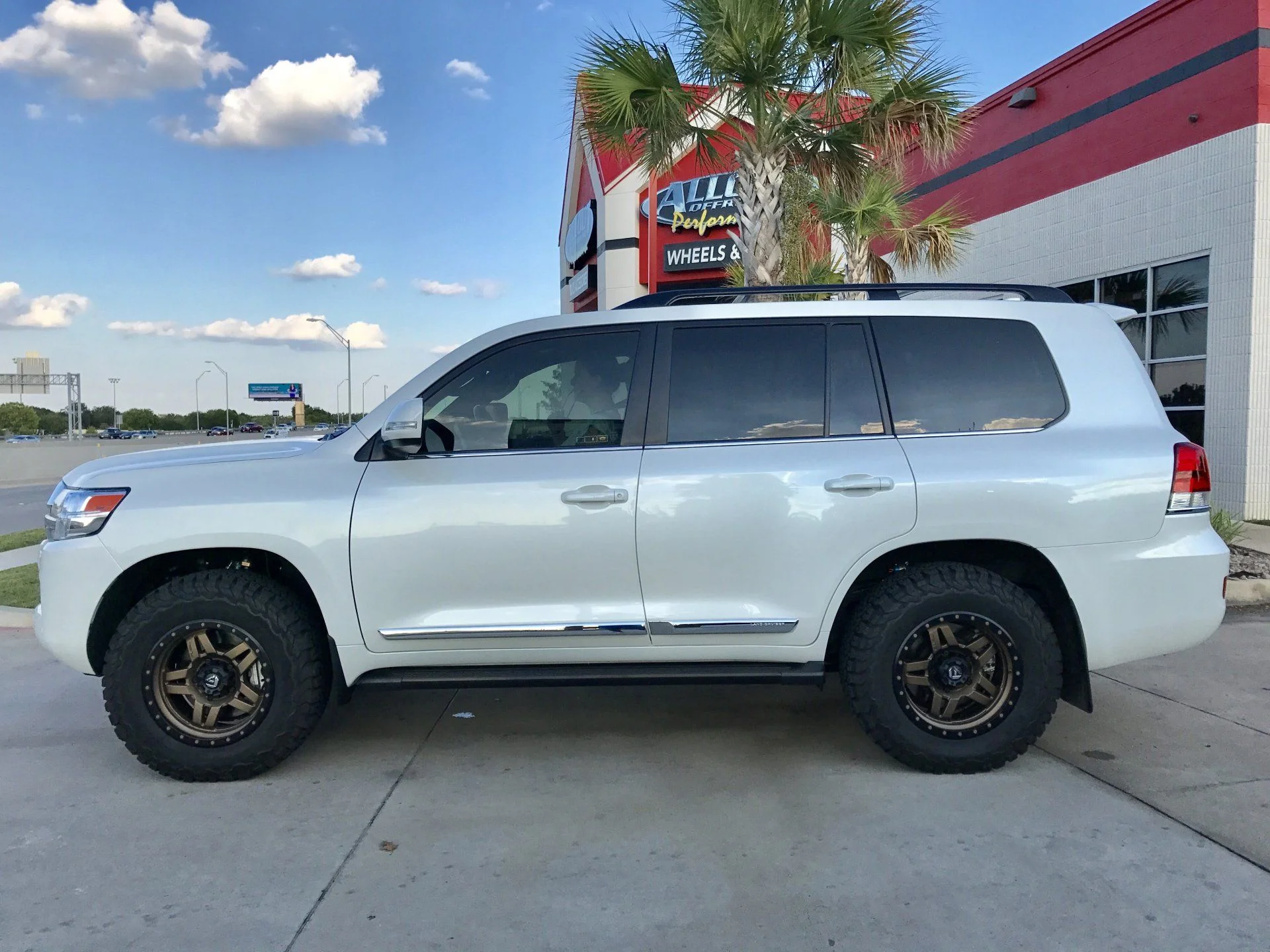

Here they are installed. They were preset at 2". You can barely tell a lift in the pics. Plus they will settle. But you can def notice the lift getting in and out.
May add another inch then let them settle back down to a solid 2.5 - 2.75.
May need to do something with the rear to take it up an inch or so to match.
