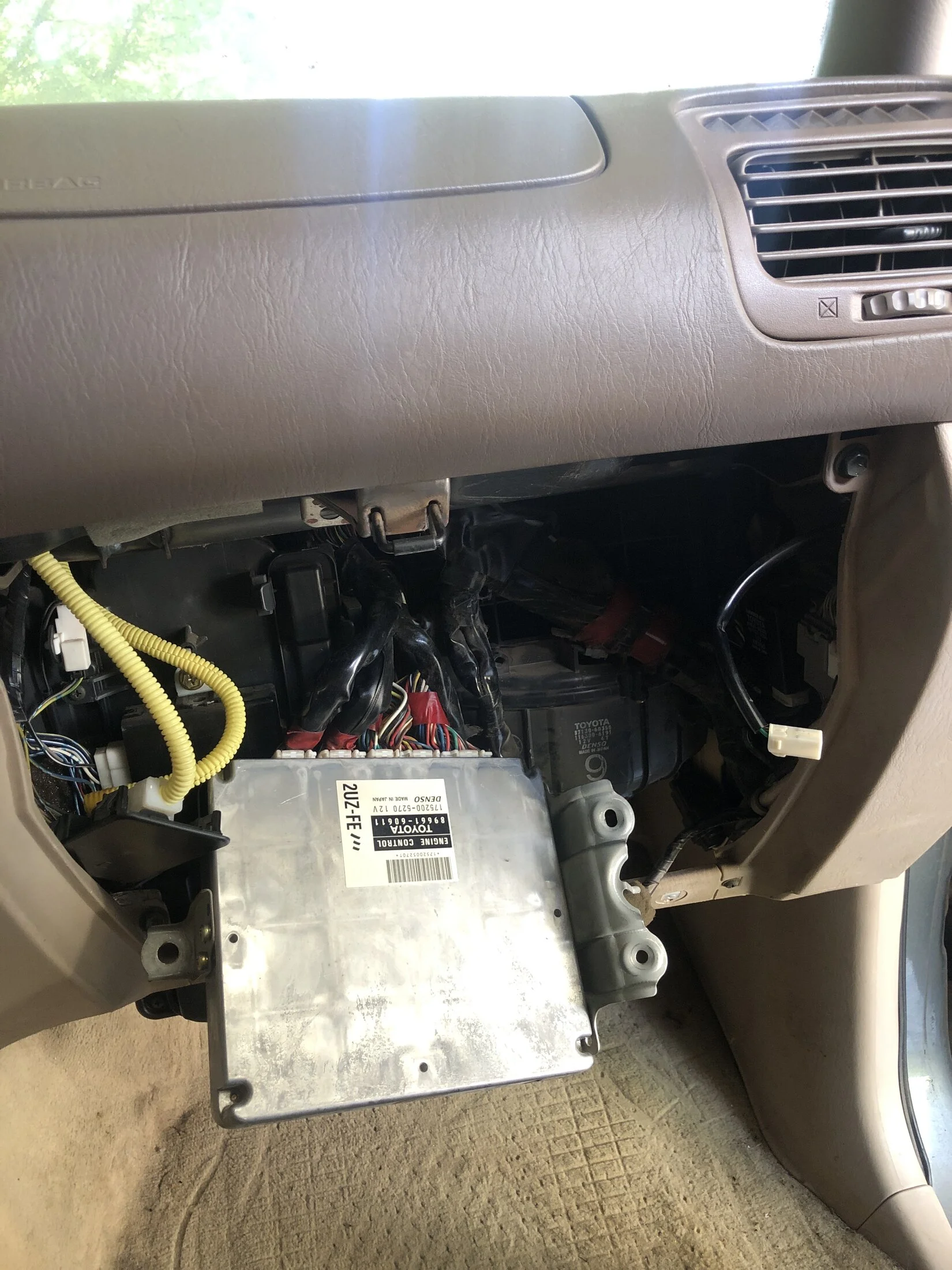

Long story short some guy who was supposed to flash some new keys for me bricked my truck. Upon opening the dash after the fact I found the computer hanging loosely and that white pigtail not plugged in.
The dash won’t even light up anymore, as before the key flashing my key would turn the electrical components on but wouldn’t actually start the vehicle. So now I’m stuck between a rock and a hard place trying to figure out what the **** this guy did to my truck. Needless to say I’m pretty sad about this and have finally gotten over the initial shock and into get s*** done mode.

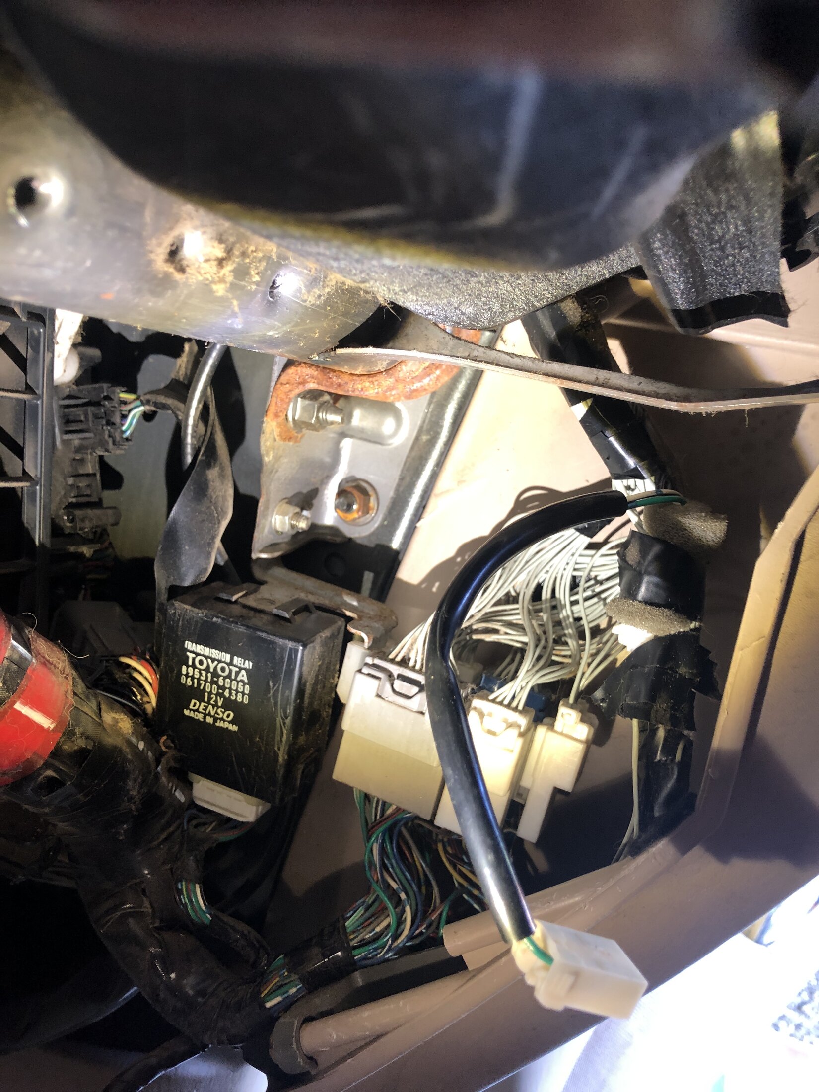

Little bit more info. The harness this is coming from seems to run alongside the door jam. I cannot find the other side of it and I’m assuming this is the reason for my woes. It might not be and I still need to get a new key flashed.
i have no idea what you were trying to do, or what was done, but i would start by checking all fuses both under the hood and in the kick panels. Next you need to get Techstream loaded up and see if you can communicate with the ECU / Immobilizer. I agree with what Trunk Monkey said, that loose harness is not the cause of your issues.
Also, i think the ECU needs to be bolted down, it's probably missing a ground just hanging there.
Think that's just the glovebox light. Have you tried pulling the battery terminal and resetting power?
I had the same issue on my 2001 with the security immobilizer not disengaging. I did the same thing Trunk Monkey said and that fixed it. Also, I pulled the fuse and swapped in a new fuse for that system. Then a few years later the issue came back so I just did a whole new fuse block and the issue hasn't come back.

Guys I appreciate the advice and I feel pretty confident about it atm so thank you. I think I just freaked out when I took my glove box off to see what he did and saw the ecu just dangling and that other pig tail loose.
