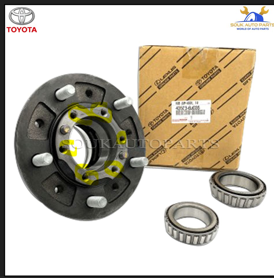

Hey guys,
I'm ordering this hub assembly along with new rotors.
my question is the flange nuts that I've circled in yellow. will I be able to remove them from my old assembly. are they simply pounded out ? and re-installed in the new hub with a brass hammer ? Please advise.
it's early, but I think those should be studs, that is what the drive plate mounts to
Correct, they are studs that are screwed in. You should be able to remove the old ones from the old hub by locking two nuts together on the studs and wrenching them loose with the wrench on the inner one.
They are studs. Take two nuts against each other, and you can remove the studs. Here is the kit from @cruiseroutfit
Get new ones...please. If you are investing the time, get new hardware. It will be so much easier to install. I have trouble getting the nuts off the stud without buckling a thread or two. It's just one slip of the dead blow and the stud is damaged.
