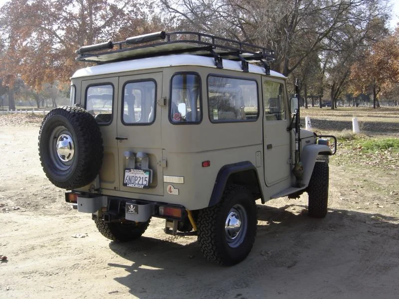

I used the Krylon Ultra flat Khaki on my 40 back in November and it is holding up really well. It looks smooth and dries really hard. I drive the truck daily and the paint on the running board still has not rubbed off. It was going to be a temporary paint job until this summer, but I just might keep it as everyone seems to like it. I think I used 7 cans at under $5 each and It coverd the whole outside of the truck. After a couple of weeks, I LIGHTLY went over it with a green Scotchbrite (with soap and water) and it smoothed up even more.
Wow, finally a reply and a great one at that.
Thanks a ton. That cements it. Your 40 looks amazing!
You didn't get swirl marks from Scotch padding it?
I'm assuming "Lightly" means that you just removed any overspray parts...
Trapper, thanks , I kept looking at the Scotch pad to see how much khaki material was on it, and was suprised at how little material was coming off. I haven't noticed any swirl marks. By "lightly" I mean just enough pressure to keep the pad in contact with the surface. Definately not like you would apply pressure if you were using sand paper. Hope this helps.
