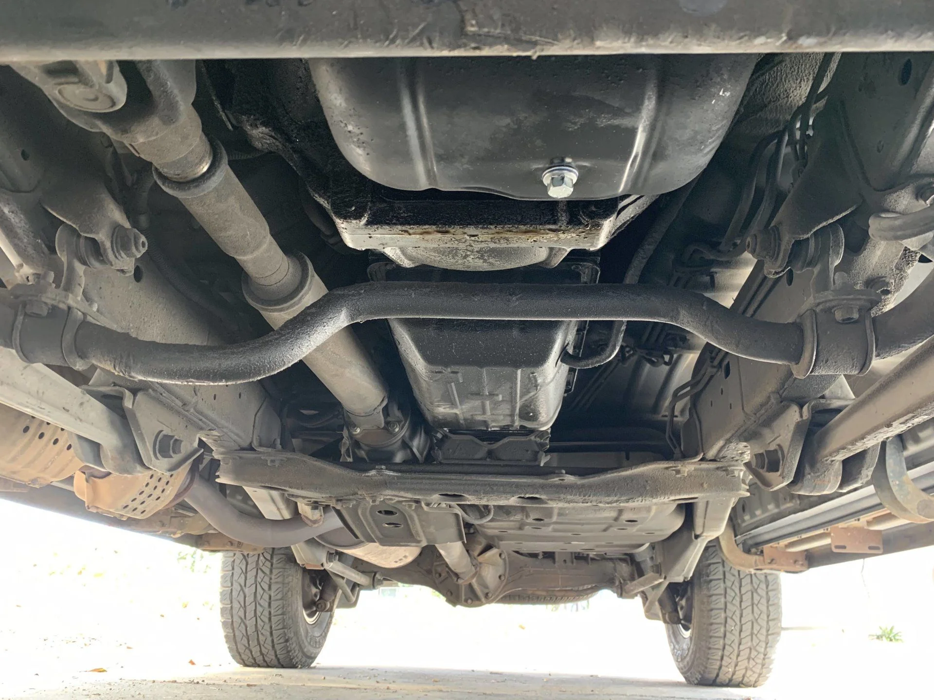

I’m trying to get my first cruiser. Found an 80 on Craigslist with no lockers. 241k miles for 11.5 k. It looks pretty good from the pics and he says no rust . I got him to send me the attached pic of the undercarriage. Just wondering how you guys determine a decent deal and what things make you run the other direction. I really appreciate the help because I’m trying to prevent my first LC experience from being too negative. By the way Im decent at wrenching myself and I’m just looking at keeping one maintained as a low mileage daily driver that I could get another 200k out of.

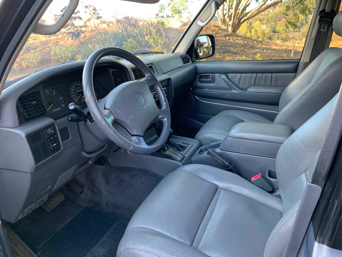

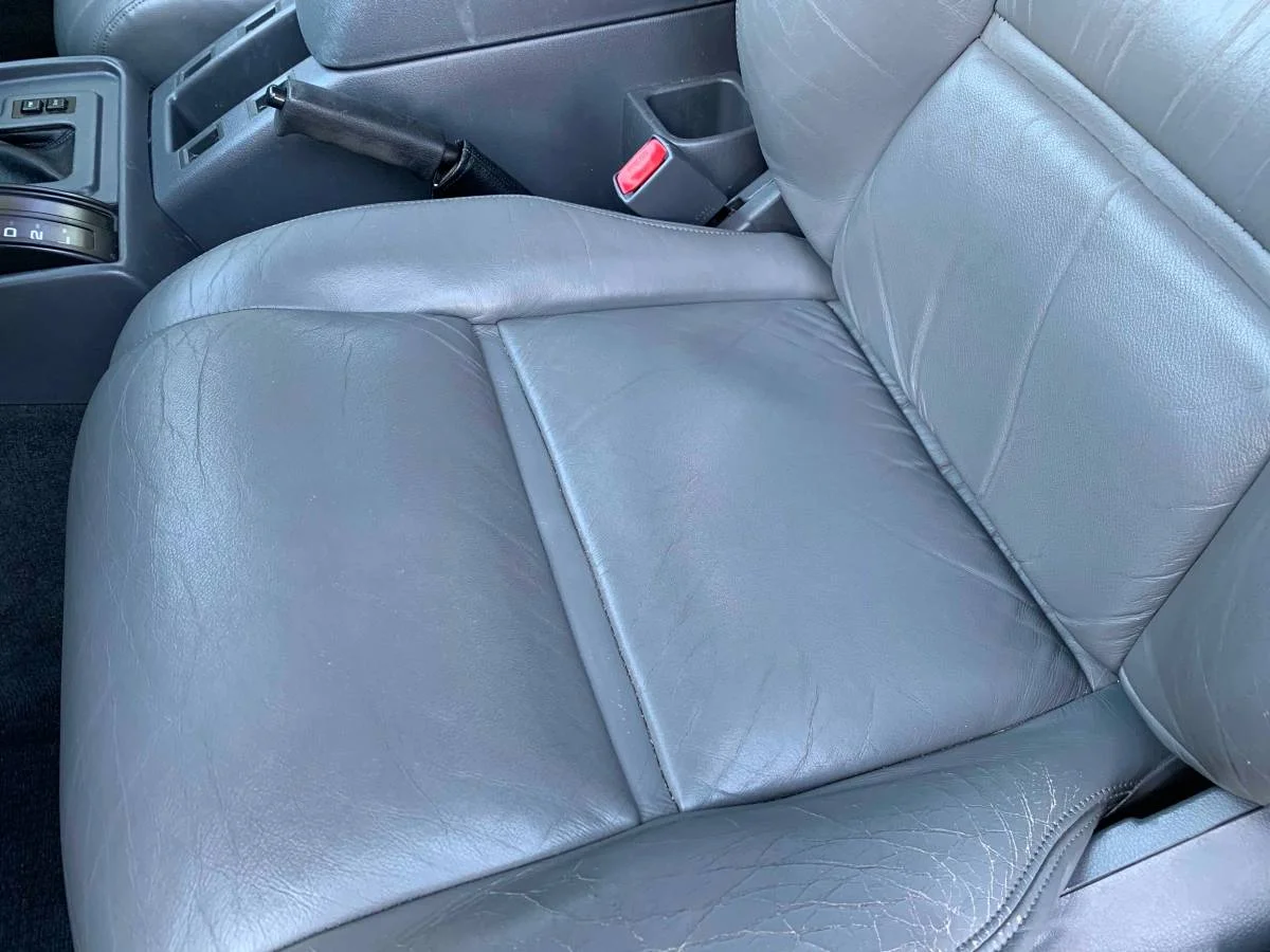

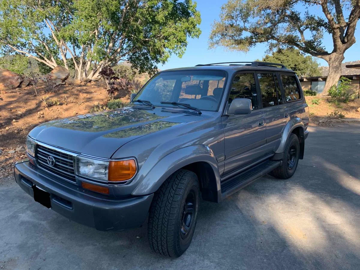

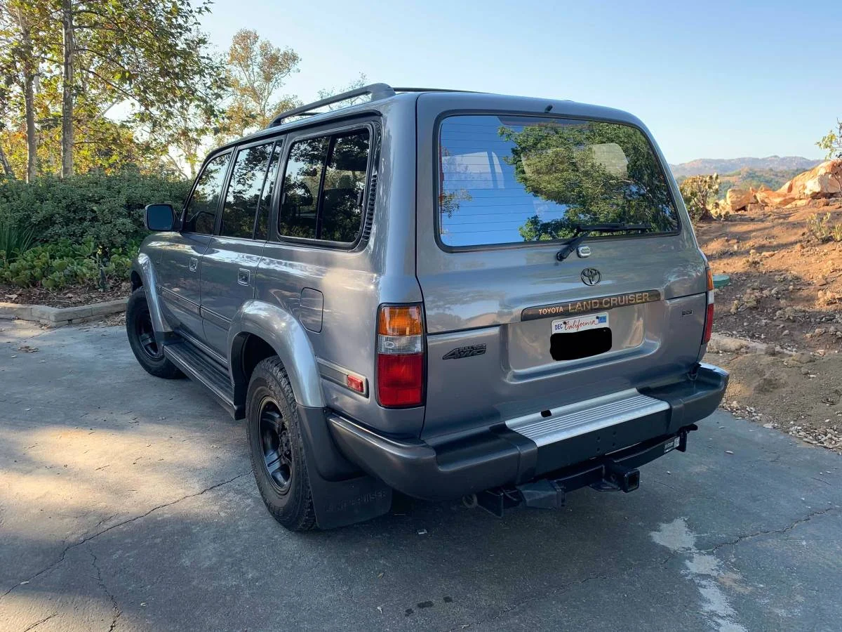

Here are the Craigslist pics. He said it’s got a chipped windshield which I’m sure is a lot of fun to deal with.

Looks like it has a rear seal leak. That is a good bit of oil underneath :)

Looks clean and undercarriage good shape. It’s a collector edition. I haven’t seen that moon glow on grey combination in a collectors edition before. Which would be sort of rare I think. Looks like it has lx450 wheels on it though?
service history ? Moonglow is a great color......still high by 3-4k I'd day for an unlocked rig, with a good bit of service/ baseline/ HG possibly pending.
Rear main seal is leaking for sure based on that under carriage photo. . Its not the end of the world but it is an expensive repair. Most guys here have the leak and fairly common.
If you really like the truck then use the rear main seal leak as a negotiation tool.

Definitely rear main. Like mentioned that is a negotiation area. Check around the power steering pump for leaks too. Make sure the transmission isn't leaking as well. I just flew to get a 93 and inspected it in the rain and should have been more thorough. It's a solid truck and I'm not too upset but it lost three quarts of ATF on the 800 mile drive home. Also mine has a rear main leak.
