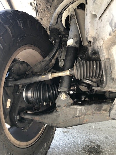

Just picked up my LC100 yesterday from the dealer with a brand new set of front axle assembly, sway bar link bushings, shock absorber and retainer cushions.
The bottom chart shows before and after calibration of all four wheels. I was told they are not able to get the front driver side caster in "green." I don't understand why they can't make the proper adjustment. They gave me the print out sheet that marked "Front TOE" which I don't understand what's for because that's not my car, not sure what they are trying to tell me as I was told that's just a generic photo, was that instruction to the mechanic? I thought I heard there's no more "room" to turn and that's why that wheel is slightly out of spec. How can that be?
Car drives fine but I noticed the front driver tire is 1/2" higher than the rest when I did a quick check, is that something can be adjusted? Not sure if they touched torsion bar at all when replacing the axle assembly and whether or not that's what needs to be turned.
Lastly, does anyone know the part number of the missing small liner/panel rivets shown in the photo?

Those don’t appear to be Toyota CV axles that they installed.
Sounds like the driver side torsion bar needs to be adjusted down 1/2” to get the caster in spec.

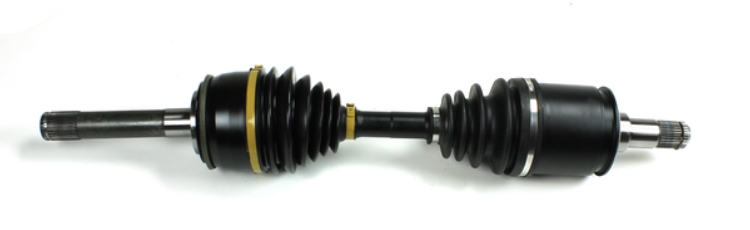

All new OEM axles come with yellow bands on the outboard boot. All new OEM axles also have painted black tulips and center shaft. Yours have none of the above and will be brown with surface rust in short order.

This is a photo I found someone posted.
