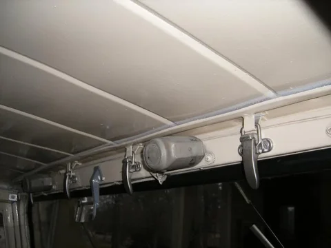

A few pics just for fun too. And why is my roof held down with clamps at the top of the windsceen when the rear is bolted to the tub? Was this normal practice for some years?

Good to see another old girl getting saved. I have seen pics of those roof latches on mud before, here is one.

The Clips
I had a fj45 1973 with the old stye doors and it had the clips like them and clips where the rear panel meets the bottom panel . If you took a cople of bolts out the roof ,the back panel and the roof comes off and the screan folds down on the bonnet. Nice way to cruise the back beach of fraser island.
I know the setup you mean Aussie, for the removable top with the clamps on the rear panel. I actually just picked up a '68 or '69 cut up 40 cowl on friday that uses the very same clamps to secure the windsceen to the dash. Already thinking about converting the back panel to fully removable top. I would need to think of a seatbelt option if I went topless. Not really comfortable with just the lap belts as this ute has now either.
I just can't figure out why it has clips at the front and not at the back. Strange.

I am curious about your rig. Have you owned it a long time? While we never got the 45 here in the US after 67 our 40 models never came up with the combo you have. I know the clamps against the top of the windscreen were not on the 40 series that wiper setup was. It stopped with the 74 model. Those doors you have as well as the latch on the cab were a 75 and later. So either yours was pieced together at some point or a true change over model. Have your dated it off the info on Specter's site. I would have thought the change from clamps to bolts would happened on the Windscreen and back of the cab at the same. :meh:
John, I have only had it for a few weeks. Read the first few posts in here for a bit of the history. The tub as you say, has the later style door latches with the accommodating "bump" on the pillar. I thought these doors started in 75 too as I think I queried at the start of the thread so that is mystery #1.
Mystery #2 is the cab being bolted at the back and having quick release clamps at the front.
