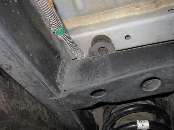

You might have a 1" body lift. If that is the case, then not all of the body mounts are used with the lift. I installed a 1" body lift for exhaust clearance for up and over the frame rail but noticed some body mounts in the back of the body that did not have a rubber puck connecting them to the frame.
The #5 mount (counting from front to back) is a less robust design than the others, not having a bolt through both frame and body.
New Info Update: The #5 Bed Spacer mounts directly to a weld-nut on the body underside with an M8x1.25x18mm (12mm head) hex bolt.
For mounting with the 1" body-lift puck - M8x1.25x40mm JIS (10mm flange head) hex bolt is perfect. (I found at Ace Hardware)
That's the one at the rear frame crossmember over the rear axle, which the body lift vendor calls the "bed spacer", which they sort of consider to be extra.
Buying their bedspacer is $10 wasted IMO, I was disappointing in what they supplied, compared to the main 5 mounts, which are great. (so I made my own)
Numbers 1-5, from front to back are still in production. Number 6 has been NLA for some time.

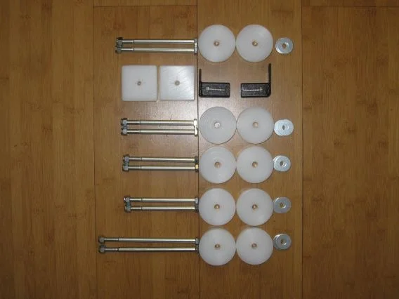

What is the white material that you made the pads with. Look really pro! Nice job
I DIY made the square ones from 1" thick x 2.5" wide x (whatever length 1 ft, 2ft, etc) UHMW from mcmaster.
Cut to length with a wood miter saw, hole drilled on a drill press. Surface texture is quite smooth.
Really very easy to work with - go slow - be careful not to let friction heat build up, or expansion might cause blade binding problems.
The round vendor made ones are also 1" thick UHMW, but turned from round stock on a lathe, I suppose. They have fairly deep circular grooves on the surface.
I plan on installing with 150 grit wet-or-dry sandpaper non-slip gaskets between UHMW and underside of body (grit toward UHMW) to avoid slippage & shifting back & forth. UHMW is very slippery - almost as much as teflon.
BTW, all 6 are available from FEBEST - really not concerned about the OEM only thing for this - they 're only body supports, after all, not stressed.
Still costs a lot for the whole set though.
