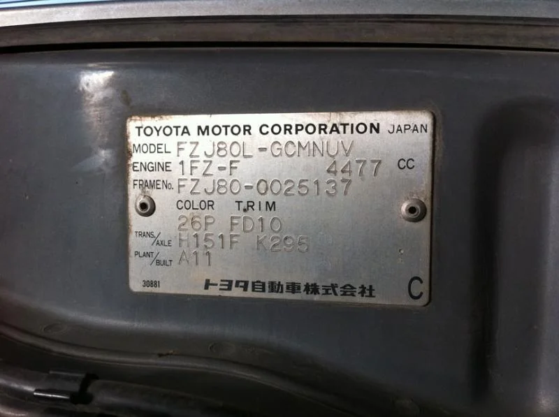

Just want to introduce my new Cruiser as it’s a little different from what you get in the States. I’m living in Shenzhen China (near Hong Kong) and was actually looking for a cheap new small car like a Corolla as a family vehicle when I spotted an old 80 at the end of the lot. I stood there staring at it and thought what a great truck….I wonder if these old Cruisers are any good? I got online…promptly found y’all…and discovered that yeah…these old Cruisers are not so bad :).
1993 FZJ80 GX
1FZ-F engine with carburator
H151F manual transmission - HF1A part time 2wd transfer case
K295 axle set: limited slip rear differential
Mile Marker Supreme Manual Locking Front Hubs

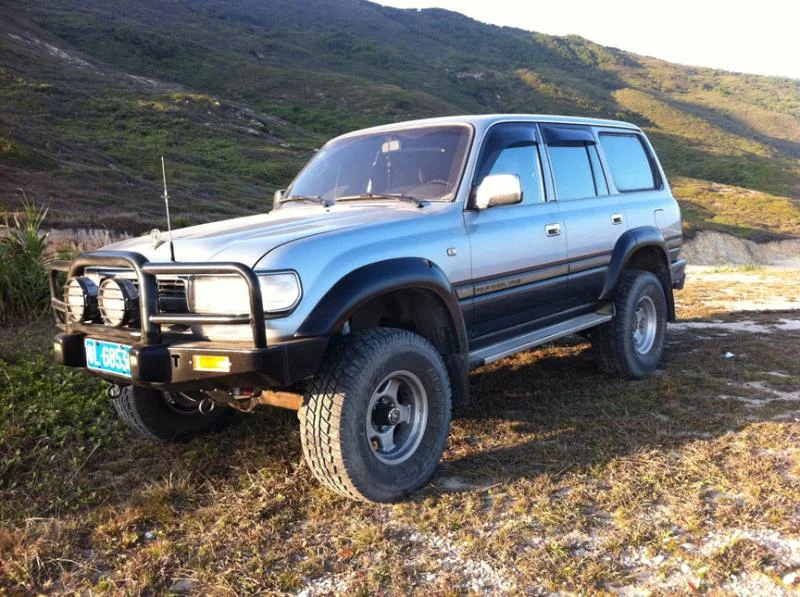

Suspension/Wheels:
Tough Dog Heavy Duty foam cell shocks
Lovells springs (80mm lift?), torsion rods, castor correction plates, etc.
Rancho steering dampener
Bradley V wheels and one SSR Speedstar Auswuch wheel (spare) all JWL
Cooper Discoverer ATR 305/75 16 tires
Other stuff:
Rear barn doors and integrated factory tire carrier
TJM front bumper
Factory sub tank

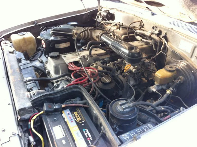

Trouble shoot rough idle.

Nice, that is a pretty sweet looking 80. Very interesting packaging, manual, partial poverty with the bench 2nd row but has the ice box in the front. Love it.

Crazy jealous as well. As to the idle, did you make a large elevation change after buying it? If so, it may take a couple run cycles to "re-learn" the new elevation. If not, you may have a vacuum leak. I would say it also could be a crack in the air tube between air sensor and intake plenum but its normally aspirated so it's not that...so look for cracked vacuum lines to the carb.
EDIT: Nevermind on the computer aspect, that would be for Fuel injection as well, I believe...duh

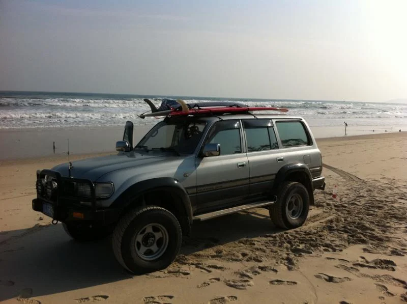

Some GX's have the center console...some have bench seats...but I've never seen another GX with a sunroof which I know y'all complain about, but here in the tropics its nice to open it up for ventilation and get the air moving. I also which I had the factory roof rack! Its low profile and would be perfect for strapping surfboards the the roof. If I put on anything taller I wont fit in the local parking garages.
Because of the carb there is no EGR system, no computer, no 02 sensors, no PHH! There are a few vacuum lines that I'll replace ASAP and see if that helps. Maybe just clean the carb?
