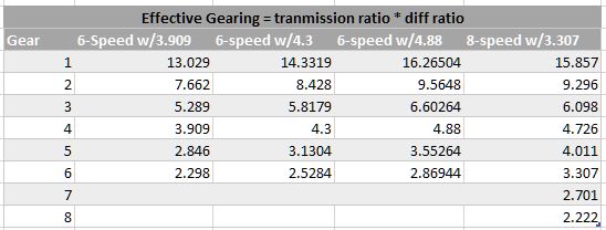

Putting efficiency aside, it's all about gear ratio width, or spread. From the tallest to the shortest ratio. The 6-speed has a spread of 5.67. 8-speed 7.14. A 25% better spread. Remember back as kid, moving from a 14-speed to a 21-speed. That was a big deal. Because now we could climb some serious hills. At a crawl, but not having to get off the bike was awesome for the first time.
Which gets into the second major benefit for serious off-roaders like you. Crawl ratio.
6-speed: 34.1:1
8-speed: 41.5:1
For comparison.
4Runner 34:1
Basic Wrangler 39:1
Rubicon Wrangler 73:1
Umm. that's like saying on a 6 speed: gearing in 1-5 is like an 8 speed with 4.30 gears instead of 3.30s.
No it's not. I think you misspoke here or I might not be understanding. The 8-speed is geared much lower, even on account of the 3.307 rear end. Looking at this effective gearing table (which includes the transmission and rear end), it's the 6-speed with a 4.88 that comes closest to the 8-speed with stock rear end.
I get your point on the highest gear. But if we had software that limited the highest gear to 7 in the 8-speed, there would be no other mod necessary! The 7th gear effective ratio is not so low such that it couldn't turn a rig that has AT tires, rack, and lift either. It really would be nicely setup.
6-speed: 34.1:1
8-speed: 41.5:1
For comparison.

You're still coming at this from cruise speed. I don't disagree with you. The final drive ratio at top gear in the 8-speed is 2.222 vs 2.298 in the 6-speed. Which agrees with your 150rpm observation. But 7th is 2.701.
Again, if we had SOFTWARE to limit the transmission to 7, it will lug the 35 better than a 6-speed in top gear lugging a stock 32.1" tire!
Then there's all the awesome benefits of the lower gear 8-speed for crawling!
Yeah, sorry I missed your post a month ago. Came across it today so I thought I'd respond. I totally get that you're passionate about it and I can certainly hear your experience. I'm not looking to undermine anything you've said and I agree much more than I disagree. Like you, I'm big into this stuff. I'm not just coming from paper here as I do tune and tweak cars endlessly. I do tune turbo'd Lexus's, and my personal Porsche. Not just the superficial stuff, but the full blown maps. Yes, I absolutely see how just changing tire size, even slightly puts the motor into completely different parts of the load, timing, and fueling tables.
Totally with you on all that, and I agree that the 1-7 speeds of a 8 speed are better. But the software piece of limiting to 7th gear still won't solve the vaccine pressure that the 5.7 deals with at that RPM and load. So while it will feel better driving as the T/C can still lock, it won't yield as good of other things than a 6 speed in 6th.
Yes you get that nice low 1st gear, but the 1st gear in a 6 speed is already all you need. So that's why I'm emphasizing the top end. Yes the 8 speeds 1st gear is great, but the 6speed in 1st will still hold the truck back quite well when going down steep inclines. Enough to where I won't put much more worry into it on the rubicon.
I think for the guy that just what's a small lift and a 33, maybe a bumper. A 6speed is a better option all around. If a regear is in the future, then a 8 speed will be better around.
Limiting the trans to 7th speed by limiting software is just an intermediate fix, not a solution, in my opinion. That's where I feel that software has its limitations, the engine make a certain amount of power, and a big mechanical gear is the only way to truest make more reliable power.
