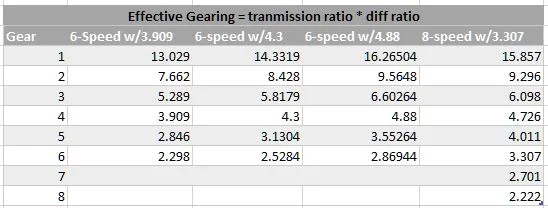

I think this table might help, which is the overall effective gearing with various diffs on the 6-speed. Note that the 8-speeds overall gearing in 1-7 looks very close to the 6-speed with the 4.88 diff.
When this thread started, I basically put the same table together by hand. The overall ratios of the top gear of the 6 spd with 3.9 axle is virtually identical (within 3%) as the 8 spd with 3.3 axle. As a SYSTEM, the 8 spd has basically the same effective axle ratio as the 6 at top gear and tighter spacing between lower gears with 2 additional gears. The 8 spd with 3.3, gives a crawl ratio that is almost 25% lower than the 6 spd with 3.9.

But if just stock gearing, the 8 speed revs about 75 RMPs lower than the 6 speed at 70mph. I know that doesn't seem like a lot, but I offer that when the TC unlocks, it only adds just about double that. And like Techis said that a lot of people with 6 speeds wanted a 5.5 gear, well that is Toyota's way of bumping up the RPMs a bit without having to downshift. Makes since, as the ECU plans on this only happening for a short period of time. Mess with that stock vehicle, like modify it, or tow and the TC usually stays unlocked and builds serious heat, about 60-80 degrees more than normal. That can be managed by manually limiting the trans like everyone is saying with "S#". I like that I can tow a car and full trailer through the blue ridge and stay in top gear and TC locked, keeping my trans temp low. If i need to pass, yes of course it should and will down shift into my first overdrive.
First chart is 6 speed with 3.909, second is 8 speed with 3.307
So between the two (and i'll talk both setups simultaneously), if the the 75 RPMs don't matter, then when we fall to our next highest gear, the 6 speed is making about 115 RPM more, then the when we fall to direct the 6 speed is making 453 RPM more.
When I towed before I regeared, I found myself falling to 4th regularly, but in a 8 speed you are falling to you 5th gear to match the 6 speeds 4th gear. I know that doesn't sound like a big deal, and maybe I'm looking at this from an elevation, high wind terrain I find myself in combined with my past, I feel that is a lot of heat building shifting happening. And that all leads to more dropping of speed and trying to build back up again. Resulting in a less efficient MPG.

Umm. that's like saying on a 6 speed: gearing in 1-5 is like an 8 speed with 4.30 gears instead of 3.30s.
While true, that's not how any of us should set up a drivetrain. One thing that I keep seeing people get confused about gearing is they keep looking at RPMs in the low gears. If we had problems at 0-45 MPH, this would be a different argument, but we don't. A 6 speed on 40s would have no issues driving around a city and off roading. Gearing for us is about our highway RPMs and the power available. Heat, wear, fuel economy, drivetrain stress, they all need to be understood in their entirety, a gear calculator is such a small part of the equation. And unfortunately, they get abused too often.
While it's not that hard to have a modified computer lock up the torque converter when the motor is being delivered a lot more fuel and now causing more stress in the drivetrain (not to mention it's not very fuel efficient.) You still won't have the power you are looking for. Software can't make up for the fact that both 6 and 8 speeds top gear is kinda tall (meaning very low RPMs and ultimately not enough power). But the 8 speeds top gear is even taller. And the point of having gears is to use them, not limit the top one by software, differential ratios just need to be changed. That's the right way to do it. See post #62.
