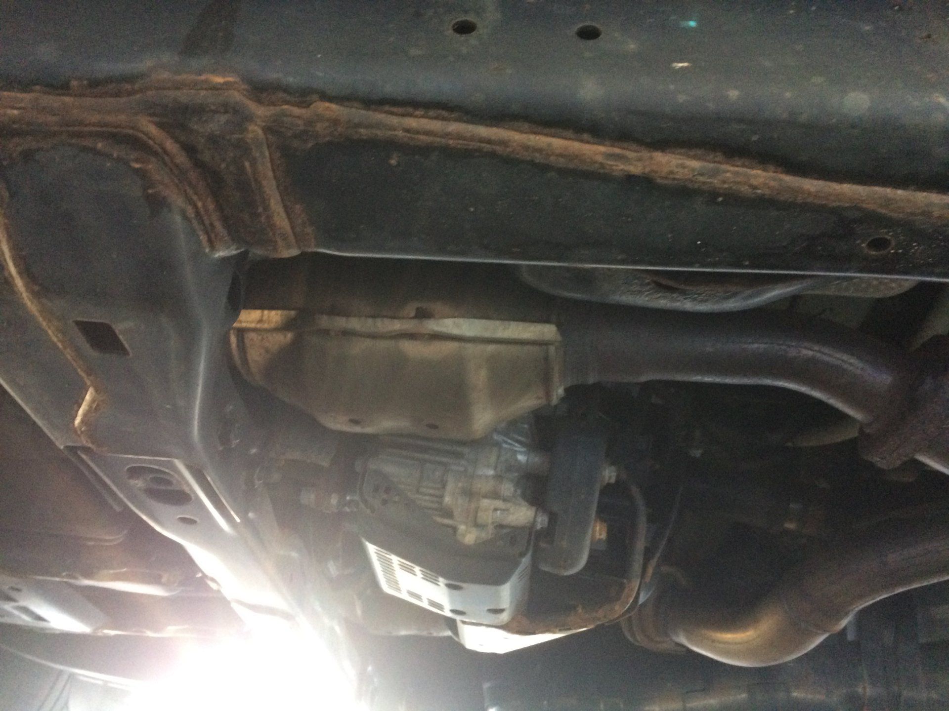

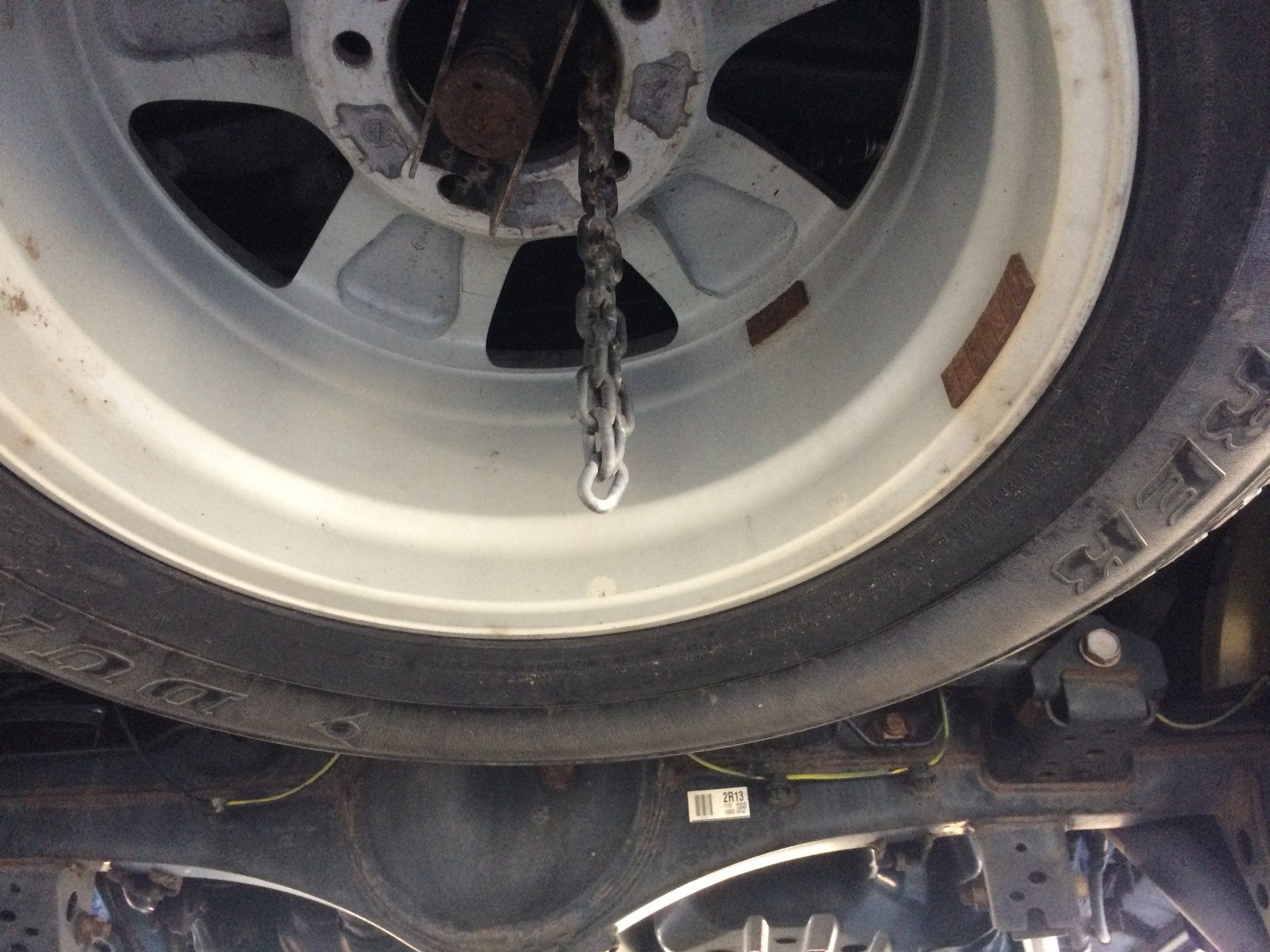

I have found a few that have caught my eye. One in particular is a '14 with 77k on the clock in the right color combo. It is a one owner truck, but has spent its life in CT and is for sale in Springfield, MA. The dealer happily sent me some photo's of the undercarriage and it does have small amount of surface rust along the welds, as most vehicles do in that area.

Post the pics.
Post the pics.
Frame is one thing. Obviously structural weakening is bad. But another issue often overlooked is all the hundreds of threaded fasteners along the frame and suspension that will be an absolute pain in the ass to remove in 10yrs if you still have it. There are a bunch of captive nuts welded to the inside of the frame rail that can spin if the bolt rusts into them.
For that reason I only buy rust-free.
The paint Toyota uses on the frame is totally inadequate for salty environments. I believe this is the true culprit behind the unusual rust on welds I see on young Toyotas. Perhaps a chemical reaction with the welding material is involved. If it hasn't been undercoated early and it's lived in salt-using environments, you can expect rusty welds like above. Even if the owner is proactive in washing the vehicle. Get a clean one, and use fluid film, POR-15, or another undercoating.
Not an apples to apples comparison because they are unibody, but we have a 2015 Audi in the family that doesn't have nearly as much corrosion on its underside as some 2013-2014 200s I've seen. Same with our 2008 BMW.
MB of Springfield ? That’s not bad for CT / Northeast. Looks like a good blast of Fluid Film would neutralize a lot of the surface rust and lube up the E brake cables, etc.
Lots of vehicles don’t see salt, like my Tundra so this could be a vehicle that stays inside during storms.
That one has definitely seen salt!
I would buy a southern truck and take a flight down. I found a 2 owner Texas/ Georgia truck in south Georgia. No reason to buy rust. There are enough southern trucks to avoid rust.
If I had the choice between 70K with rust like that or 100K without. I'd choose the 100K for the same or less money. Be patient, they are out there. No need to settle.

Sorry I’m new here and I could end up completely regretting my decision but I bought a 2013 LX570 this past February from a dealer in Massachusetts and it didn’t look so dissimilar from your pictures. Aside from that it looked brand new. I spent a few weekends with a wire brush, an angle grinder with a wire wheel and some paint from Eastwood and it came out great. If I can figure out how to post pictures I’ll upload them this weekend. There were a few parts that i just ended up replacing. In the end the price was right ( for me) and it was close enough that I couldn’t pass it up. I plan to undercoat it with Fluid Film before this winter.
My '14 LX spent all its life in Western Canada, and it looks nearly identical to those photos. I have surface rust in all of the same exact spots, just less of it. I recently spent time brushing some rust off, applying rust converter, and just last night, spraying self-etching primer. After I get a few coats of this primer on, I'll do a few coats of paint, and then fluid film the entire undercarriage. I believe that with this work done, and with annual application of fluid film (or similar), I will greatly extend the life of the car. I don't anticipate any serious rust issues for the next 10 years or so.
The above work isn't all that difficult, just time consuming, and you'll likely have some overspray on the undercarriage from the work done. Not a big deal IMO, and I wouldn't be afraid of a vehicle with such surface rust, because if you live in a snow/salt area, rust is inevitable. You simply cannot beat it and will have it. Best you can do is slow/delay the onset.
