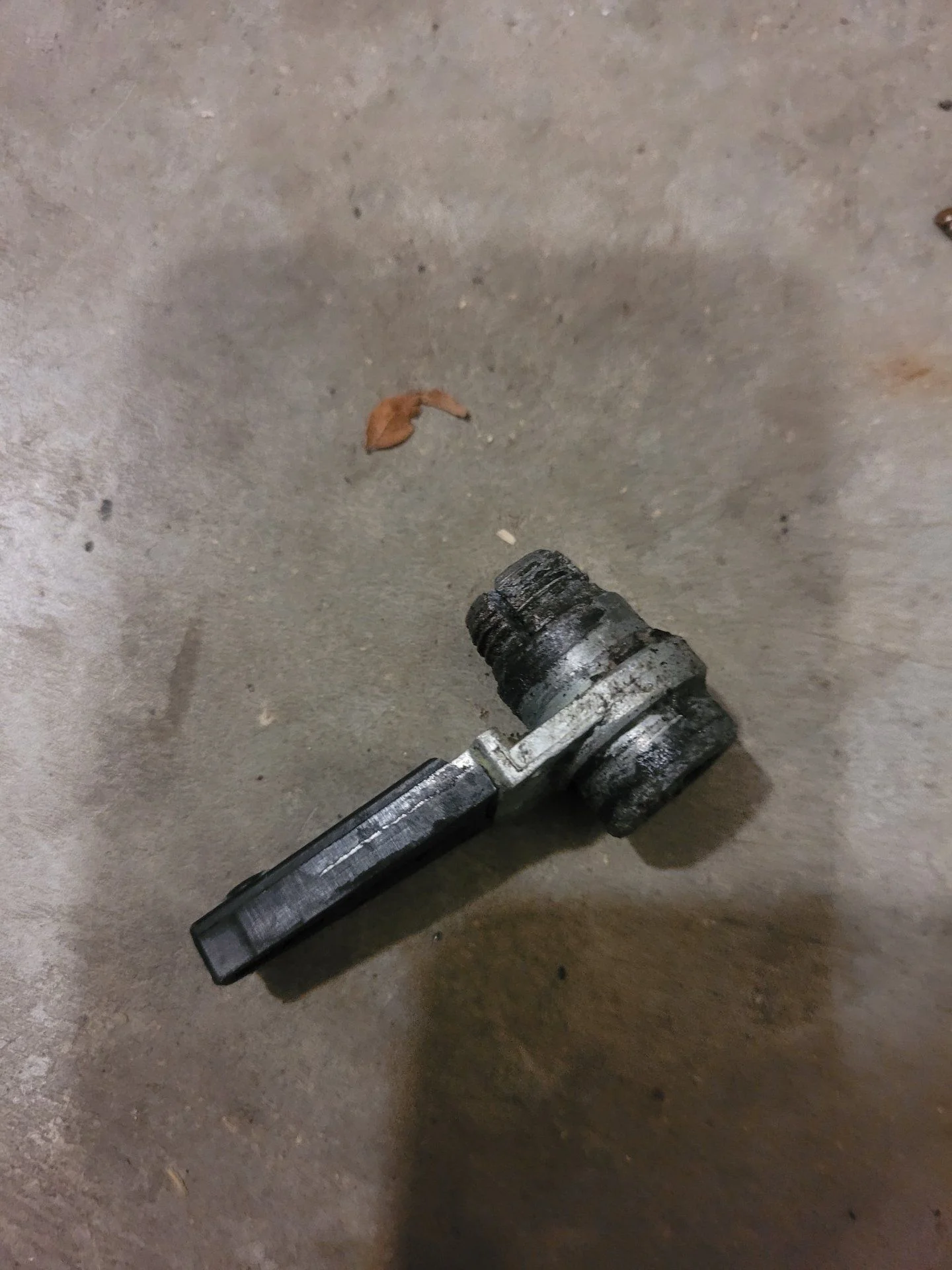

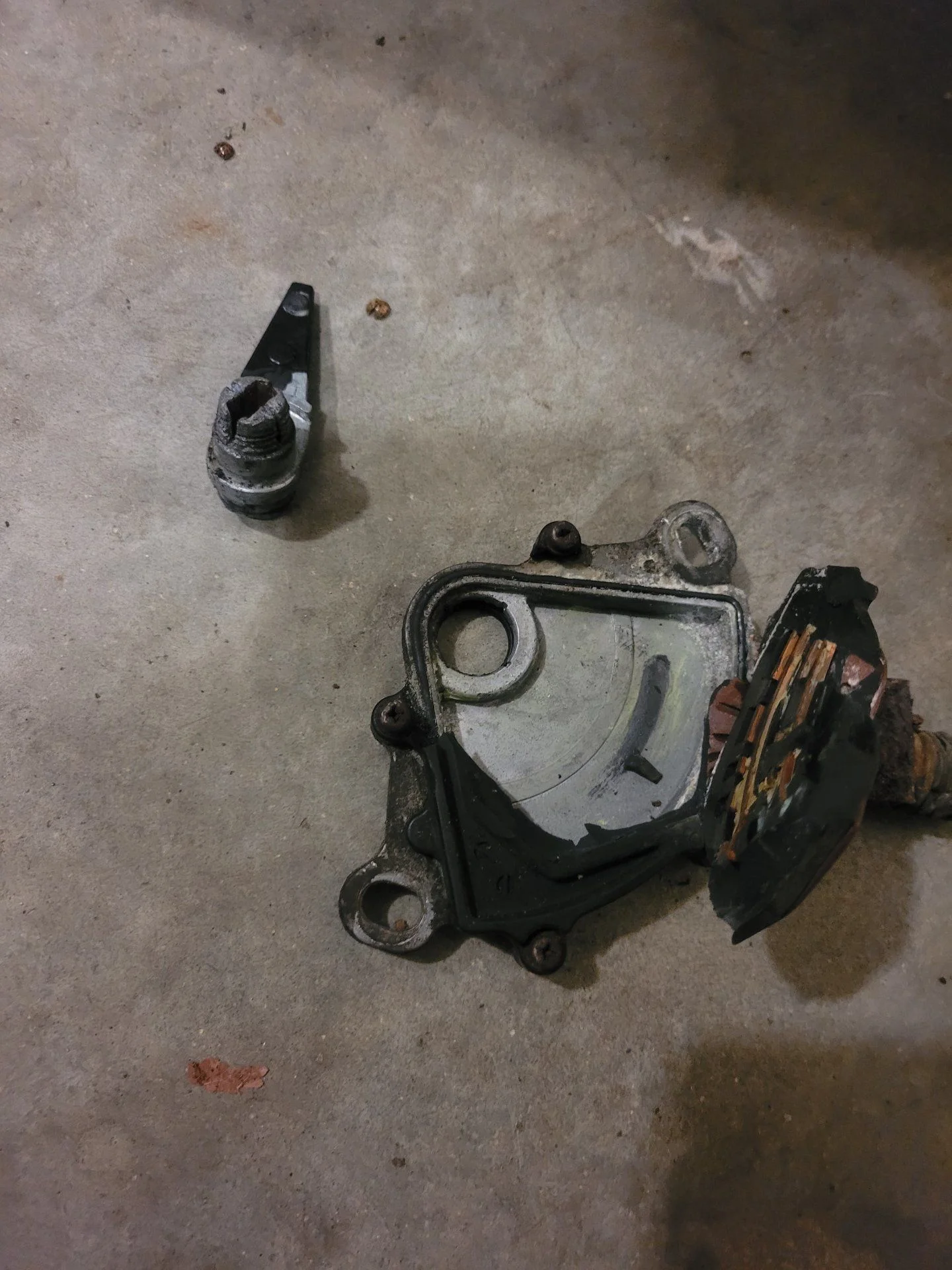

Not sure if it is the same as a 91 af442. I broke a perfectly serviceable NSS because I tried to pry it off vs break I free with a few taps. There are 2 bolts and then it should slide right off the trans output shaft. Mine was frozen on. I should have spent some time tapping the aluminum barrel that slides over the output shaft.

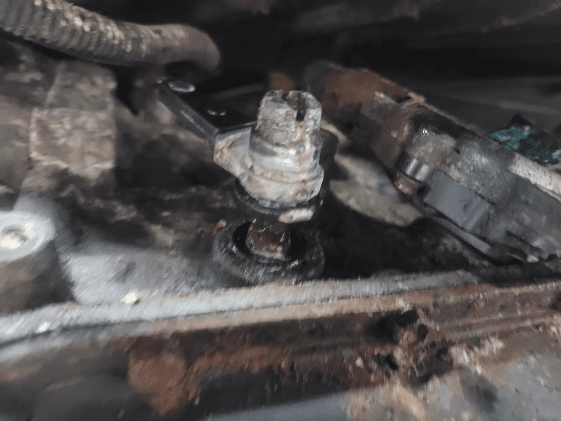

Here are some picks. There is a nut that once loosened on the barrel the barrel is free to slide off. My was frozen. Once the switch book apart I tapped the barrel a few light taps and it slid off.
$200 mistake.

a little heat can help if the switch is corroded onto the shaft, and light hits with a hammer on the shaft to help break it free. if the edgeds start to get peened over take a file and smooth out the rolled edges as the switch is a tight fit and can get hung up on the peened edges
