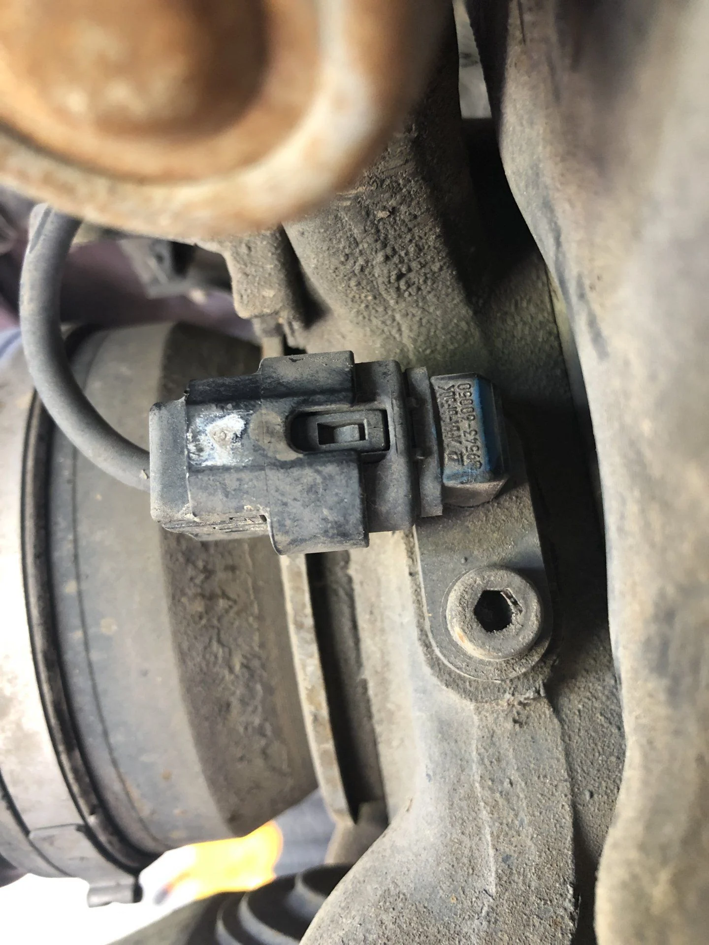

Recently replaced wheel bearings and lower control arms now on my 05 GX470. For some reason now if you in any way try to accelerate the vehicle by the gas pedal it come to halt and applies it’s own brakes and if you try to force it to drive it locks up harder and Traction control light pops up for a second. Any ideas on what could be the cause? I’ve cleaned the inside of the bearing and assembly good and all the wheel speed sensors are nice and clean. No damages anywhere it seems, car was just fine and then all of a sudden started this. I’ve done a ZPC with no luck either. I need to try and tow the vehicle to be able to read live ABS codes but any suggestions before i have to call a tow truck to take it to a shop.

Check the front speed sensors. Visual inspection for damage (wires especially since you did LCA and bearings). Then Techstream to see what the ECU is seeing from both sensors.
Did you remove the ABS sensors from the knuckle before removing the wheel bearing? I think they can get damaged if left in place.
In your pic the Allen head doesn’t look like its had a key in it lately.
