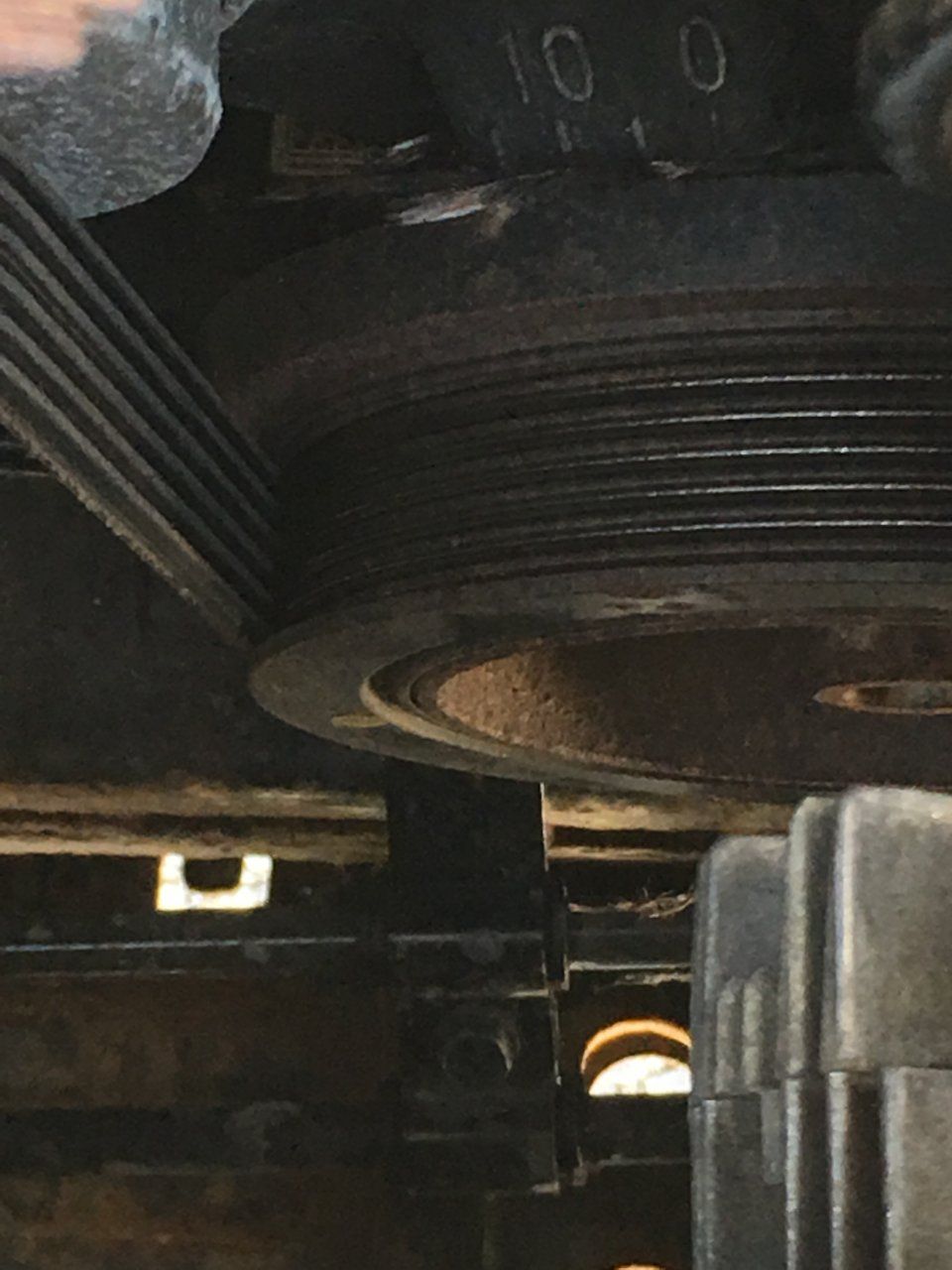

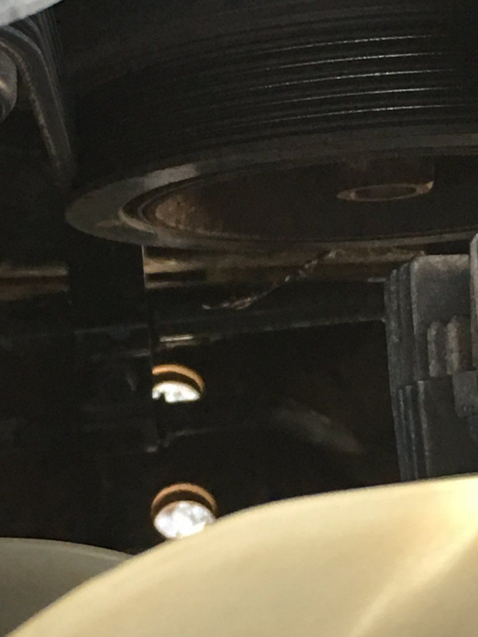

While looking in the engine I saw these wire sticking out. Maybe broken timing belt?
Serpentine belt seems to be fine. It is not broken so the only thing I can think of is the timing belt.
If you suspect it, take off the RH(pass. side)timing cover for a quick inspection. You can prob take off all but the bottom and pry it back for a peek.

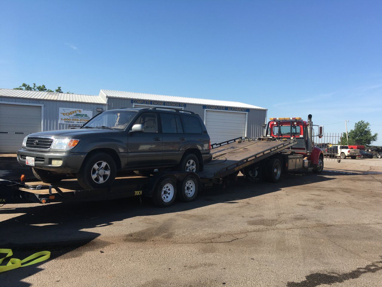

The LC was towed to a local mechanic in Sayre, OK. He is pretty sure the belt is fried. And he believes that since I was going around 70-75 down the freeway it's probably pretty certain the heads are damaged.
When the engine quit I didn't hear any noise or banging. The pics I posted above are things I saw sticking out. It looks to be some type of belt.
UPDATE: storing the vehicle for now and headed to AZ. I have a truck and trailer that I can use to come back and get her. I'll take her back to AZ and work on her there myself.

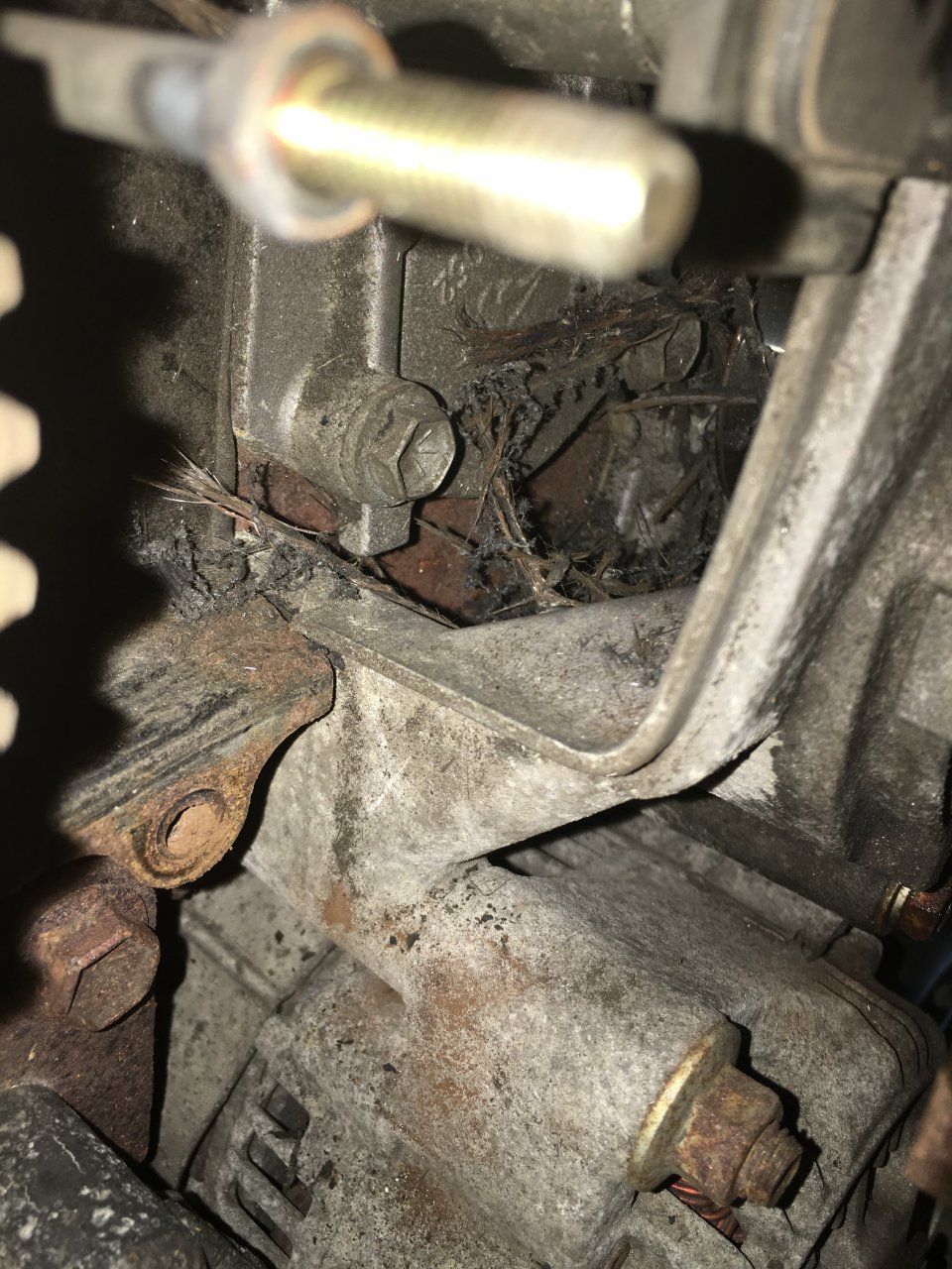

Just a quick update: got the LC to AZ and stored in a garage. Opened up the passenger side timing belt cover and there was no belt! Just a lot of debris. So I guess that question is answered.
Looking down from passenger side
I'm interested in hearing the outcome of this one. If there is no engine damage then it will add more fuel to the interference vs non interference debate.
What year is your truck? Don't forget you w-pump. I'm optimistic I think it will be fine.
